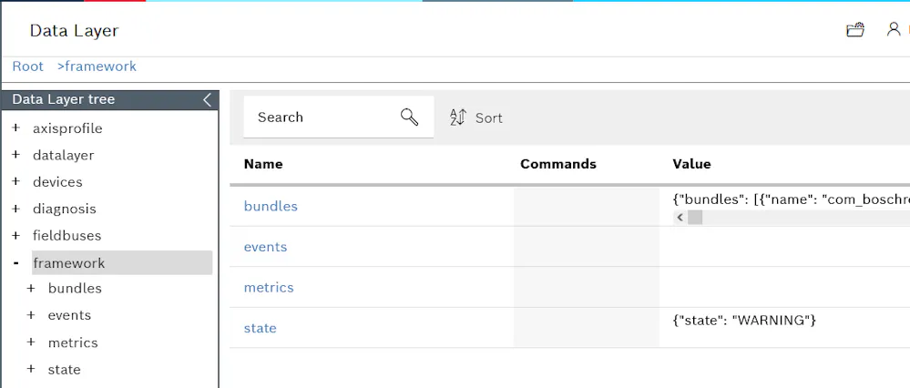

EDIT: Actual state is visible on the Data Layer:
