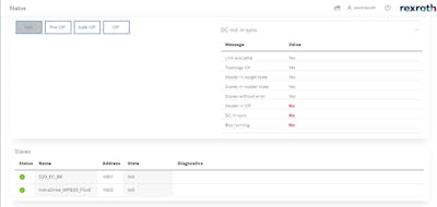

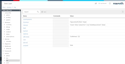

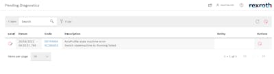

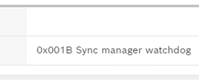

I have a problem with the motion app and watchdog that prevents me from going into op via ctrlx CORE with external devices. Specifically a Drive HCS01 and an inverter EFC5610.
The devices are connected and can be configured with the appropriate software. The problem I think lies in these errors that appear regardless of whether the devices are connected or not, so I think it is a problem within the core.

An incompatibility could also be a problem because not all prototype hardware can be used with the latest firmware. You could send me your serial number as a private message so I can check this.
The procedure of doing a image update is part of the release notes in our online documentation.
