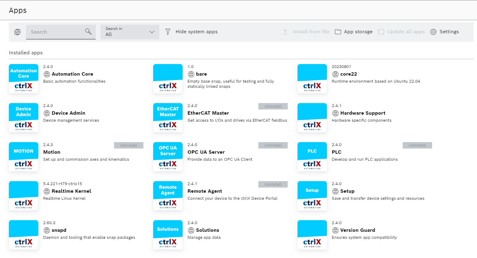

We are having some issues when rebooting the core. We get Error on configuration. I have searched the forum and found some similare cases, but not a solution that has worked for us. The error happens some times, but not every time we restart the core and causes us to not reach operation.
Note that we are using V2.4

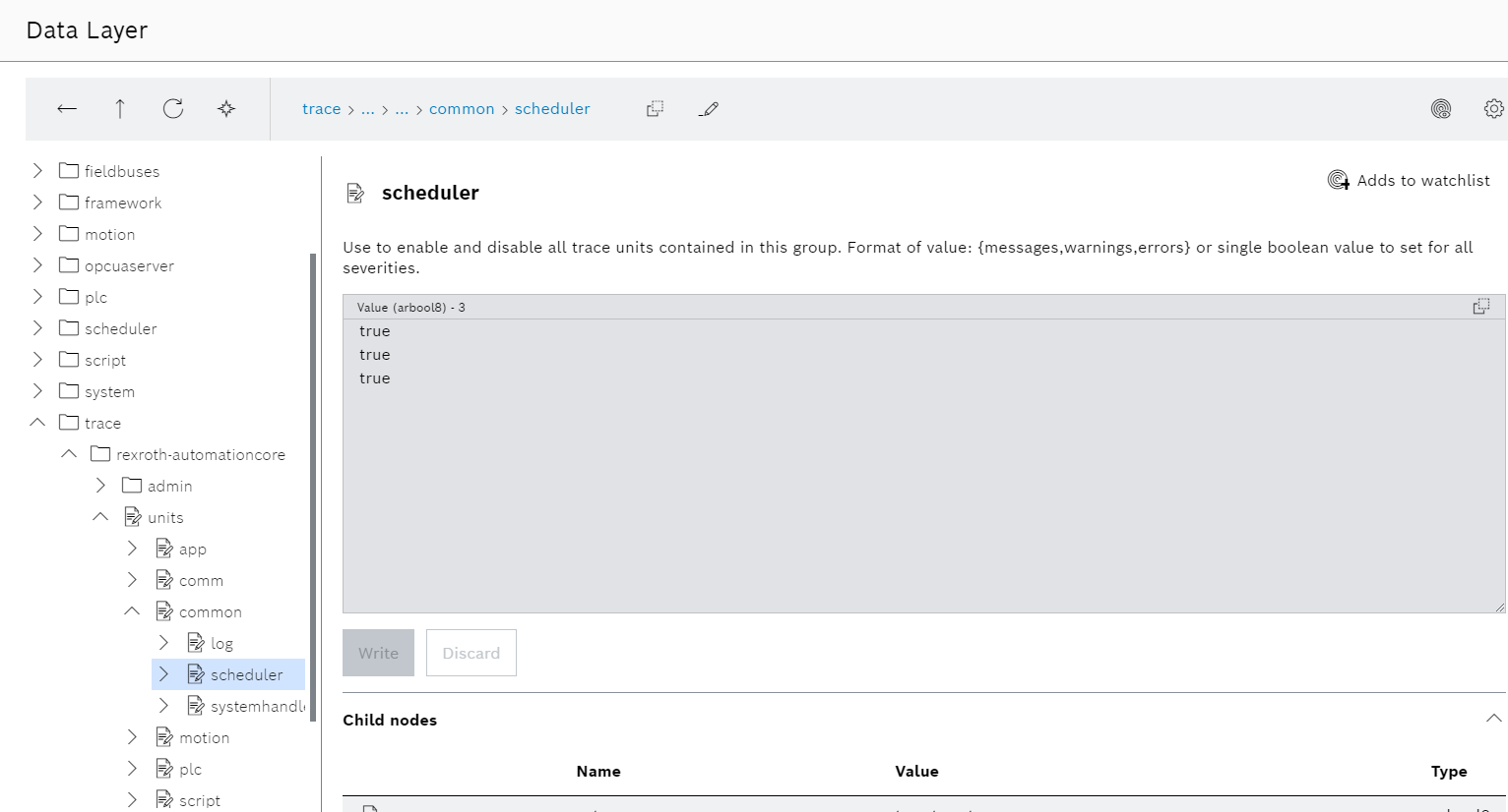

I have activated trace for the scheduler and set the logbook to persistent before restarting the core and getting the error.
