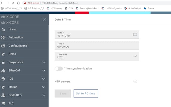

The problem I have is that every time I turn off the CtrlXCore and turn it on the next day I lose the time and date:
Every day I have to click the "Set to PC time" button to get it to work again.

Hi David08,
we have a build in RTC Chip which is buffered by a battery.
But currently we have a bug here, if this is solved the time will be buffered also if you switch it off for longer.
