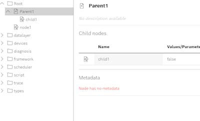

 The issue is as shown in the picture, the folder doesn't have metadata:

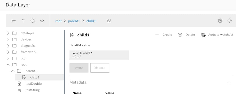

the problem in the Data Layer are the missing metadata for your folder. Metadata for nodes can be provided as follows (see documentation) :
  • Via the ‪onMetadata()‬ of a ‪ProviderNodes‬
  • Or via a metadata database (MDDB)
In the sample samples-cpp/datalayer.register.node you can see an example where this is done via the metadata database. A metadata database is provided via CSV file. I changed the sample and tested it for a similar structure like you have (see screenshot).
You can try out my main.cpp and metadata.csv if you paste it into the sdk-sample (sample-cpp/datalayer.register.node).
Nick
