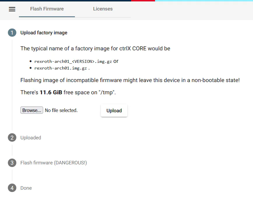

When we connect to the CtrlX webpage during the process, we see this screen:
rexroth-arch01.tar is the name of the file we can find in the "rescue" folder of the 3.6 .zip system image file.
In version 4.X, the file is called rexroth-arch02.ova.
Could this be the problem? Am I using the right method for updating CtrlX to 4.6?
