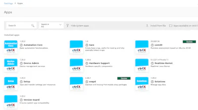

After the "Hardawre reset", I can show you what was the proposal on my ctrlX. On the Apps part, if I visualize "system apps" :
I have the possibility to "Update" core20 to core22 and snapd to in don't know. I clicked on both update buttons and I had the crash...
If I disconnet my ctrlX from Internet these update possibilities disapear.
Can you give me more details about these update possibilities informations, I seached on ctrlX user manual and I didn't find informations.
