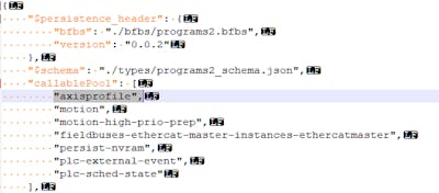

I can reproduce this behaviour. Unfortunately we have a bug here that the error still occurs and the system doesn't boot correctly after deleting the placeholder callables.
As a workaround the the concerning callable can be removed in the configuration.

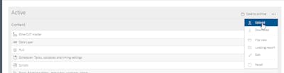

Therefor you have save and download the configuration.
After that you have to open the zip archive and remove the callable from the callable pool. In your example "oscilloscope".
Save the file in the archive and upload the configuration.
Sorry for the inconvenience. This bug will be resolved in the next release.
