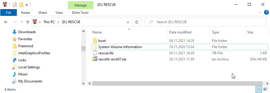

4- We use all recovery images available (1.12, 1.14, 1.16). None of them seem to generate a log on the SD card. (no update is done).
The main reason of updates are not started is because the file structure in the µSD-card is not correct. See the guideline in the release notes. Beware of the ".tar" where sometimes a only folder is put on the card.
SD card image update
Please also beware that there must not be a folder on your µSD-card with the serial number of the ctrlX CORE, because this would prevent an image to be installed. Also the bootloader and the "rescue.itb" have to fit to your image.
