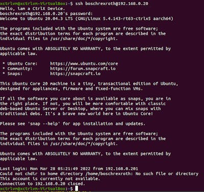

i trired to connect via ssh to the xctrl:
So i guess as external developer, i dont have access to the system !? when i connect via ssh. i get the error
/home/boschrexroth dictionary not found ..?
Question: which permission do i have on the xctrl OS?
Please see this thread for the SSH topic. In short SSH is closed because of security reasons.
In general from the outside you have no permissions but using interfaces provided by apps. If you use or create an app in the system you have all permissions that a snap has in a Ubuntu core20.
