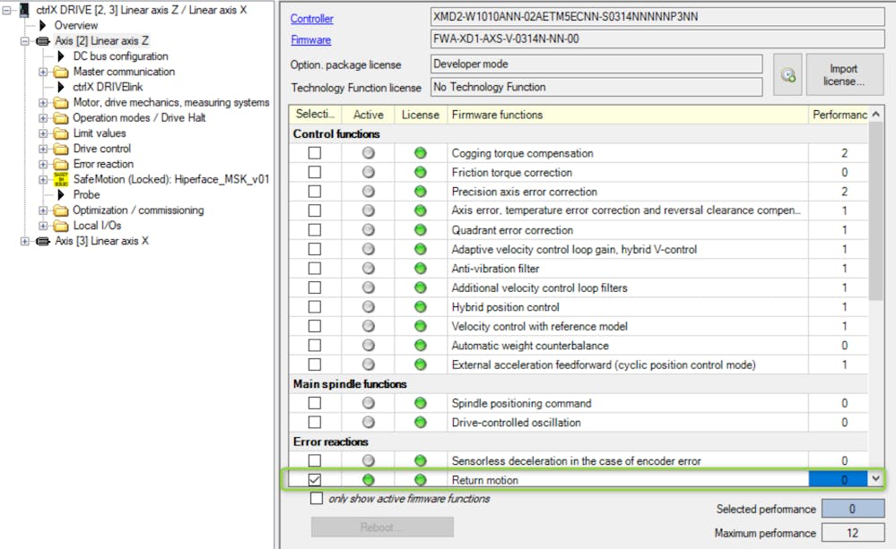

In order to activate the function the so-called productivity package must be present. It should normally already be ordered correctly or, if not ordered, be licensed afterwards by “Import license”.
The “Return motion” function itself then needs to be selected and activated by a “Reboot”.
Fig. 1.: Productivity package with activated function xReturn motionx

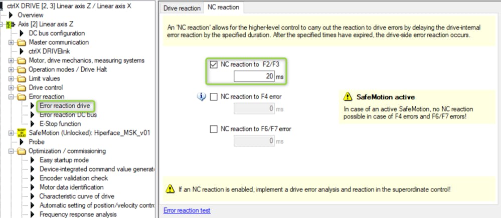

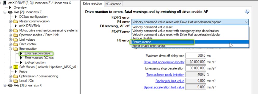

The “Return motion” is activated by
- selecting the function in case of F2/F3/F4 errors and E8 warning.
Fig. 2.: Configuration for xReturn motionx
Set the parameters according to your application!
Fig. 3.: Parameter setting xReturn Motionx in the case of F2/F3/F4 errors and E8 warning

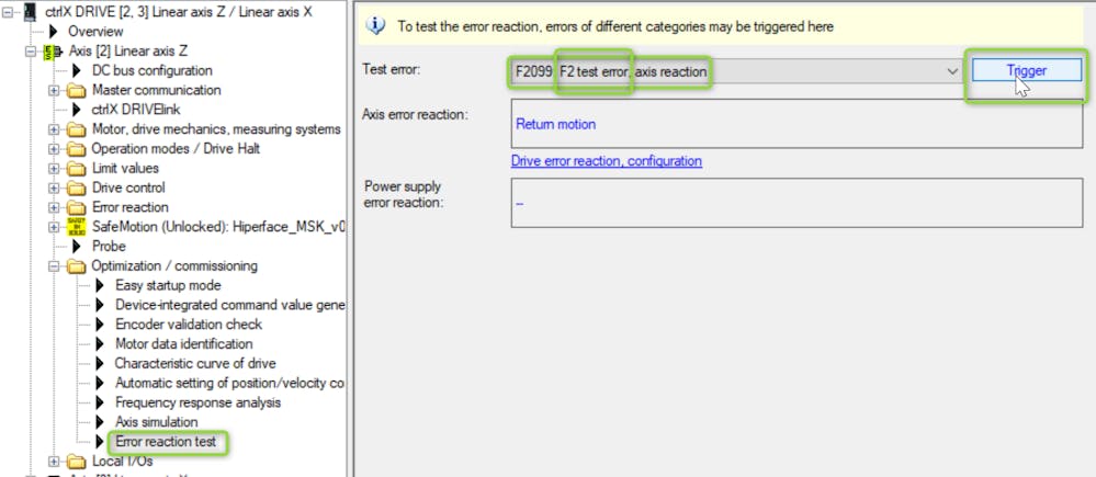

4. Check proper function

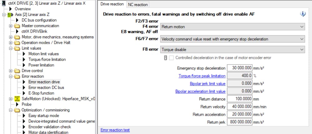

The error reaction may be tested with the help of the “Error reaction test” which allows to set the trigger. In here the “F2099 F2 test error axis reaction” is selected in the menue.
Fig. 4.: Test of the function xReturn Motionx in the case of F2/F3/F4 errors or E8 warning
Now the trigger button of the error reaction can be pushed.

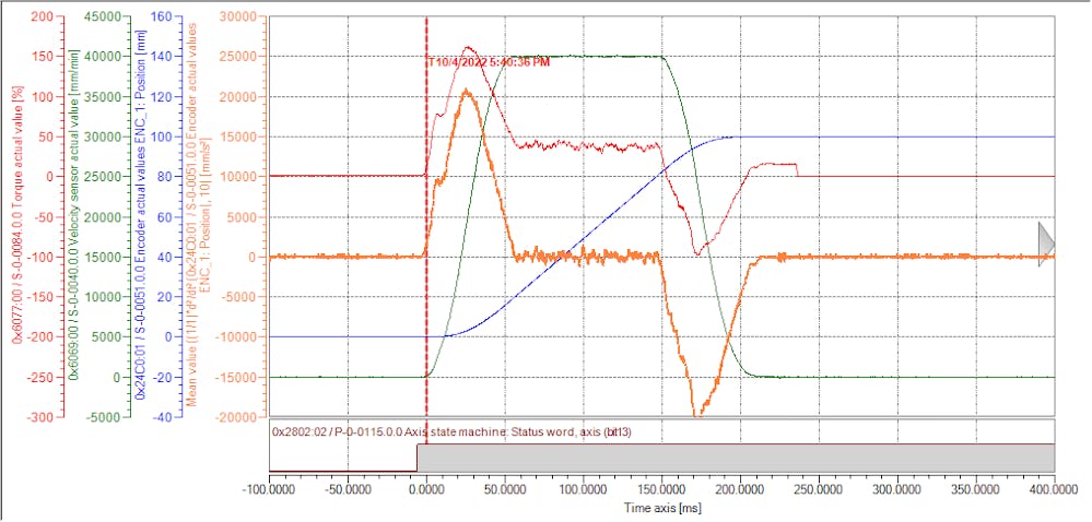

If set properly one may get the following behavior:
Fig. 5.: xReturn Motionx in the case of F2/F3/F4 error or E8 warning

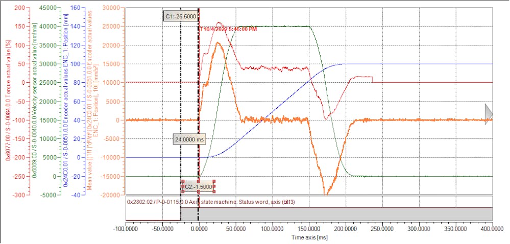

As already told the error reaction may be as well delayed. Therefore the following parameter settings apply:
Parameterize Error Reaction Return Motion 2
Fig. 6.: Parameter setting xReturn Motionx in the case of F2/F3/F4 errors and E8 warning with time delay
Fig. 7.: xReturn Motionx in the case of F2/F3/F4 error or E8 warning with time delay
