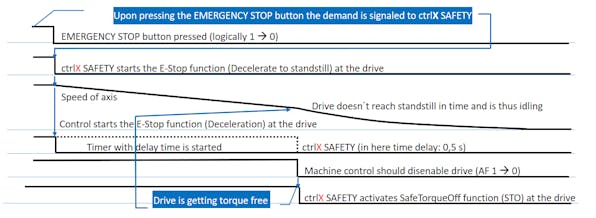

If at the ctrlX SAFETY the EMERGENCY STOP button is pressed or the ModeSelector is switched, the non-safety-functional E-Stop function at the drive is activated immediately, which leads to a deceleration of a still moving axis. With a time delay of in here chosen 0,5 s, which is the time the axis needs to stop in worst case, the SAFEX control activates the safe STO function at the drive which prohibits a further movement. If the drive acknowledges the standstill (which is a non-safety-function only) already before the 0,5 s are exceeded, the safe STO function is directly activated after the drive acknowledges this standstill condition.

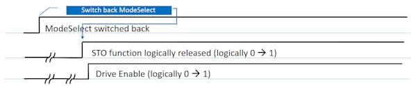

If only the ModeSelector has been switched and is now switched back again, the STO function is directly released again. No Reset button needs to be pressed. Then the drive can be activated again.

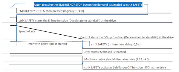

Timing diagrams
The following timing diagram show the sequence for the functionality:
Fig. 1.: Timing diagram with normal behavior at pressing EMERGENCY STOP button (axis is in movement but reaches standstill more quickly than time foreseen)
Fig. 2.: Timing diagram with behavior at pressing EMERGENCY STOP button (axis is in movement but doesn´t reach standstill in the time foreseen)
The timing diagram for switching the ModeSelect is exactly the same like for pressing the EMERGENCY STOP button.

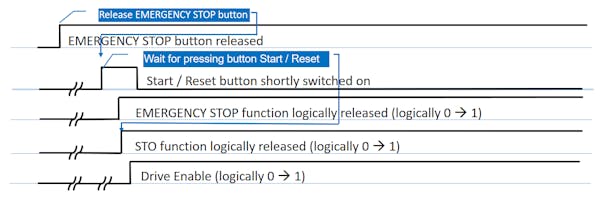

Fig. 3.: Timing diagram after releasing EMERGENCY STOP button
Fig. 4.: Timing diagram after switching ModeSelect back

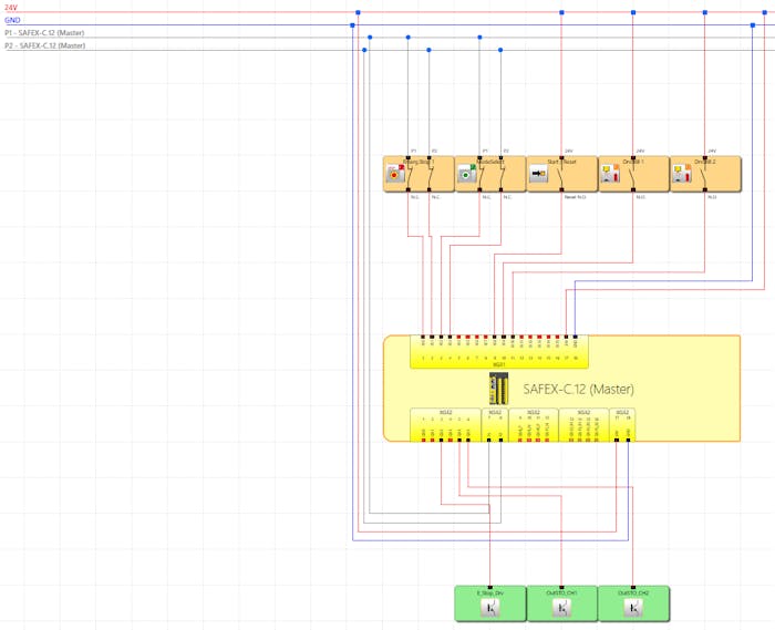

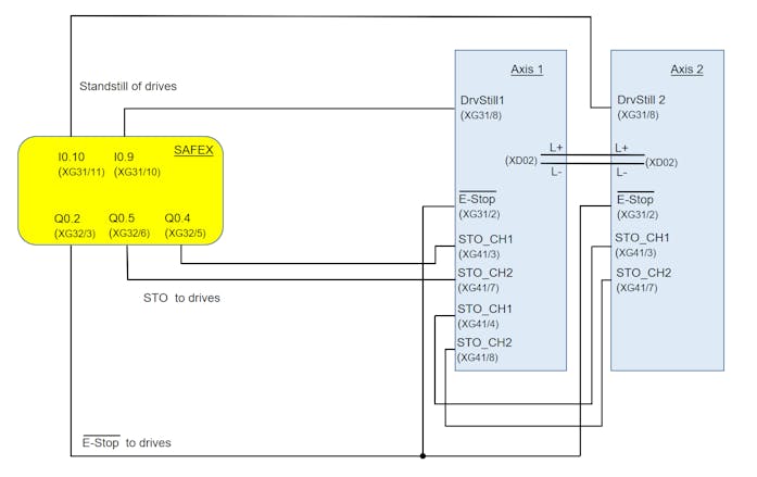

2. Wiring schematics
The SAFEX control´s input devices are:
  • One double channel EMERGENCY STOP button fed by pulsed 24V
  • One double channel Mode Select switch fed by pulsed 24V
  • One single channel reset button fed by non-pulsed 24V

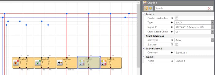

  • Two single channel inputs coming from two ctrlX DRIVE indicating that standstill is achieved
The output devices are:
  • One single channel output for control of so-called E-Stop function of drives (quick changeover to standstill)
  • Two OSSD fed outputs connected to double channel STO input of drives
Fig. 5.: Wiring schematics

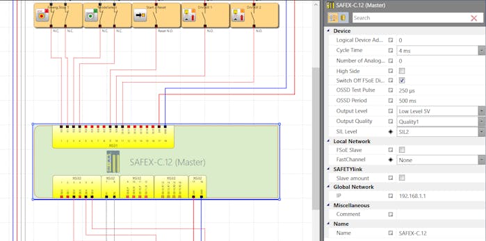

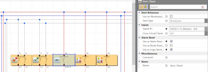

3. Settings inside SAFEX control
The settings of the SAFEX control and the devices connected to the ctrlX SAFETY control should be according to the following.
Fig. 6.: Settings of SAFEX control

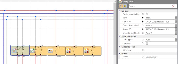

Fig. 7.: Settings of “Emergency Stop” button connected to SAFEX control
Fig. 8.: Settings of “ModeSelect” switch connected to SAFEX control
Fig. 9.: Settings of “Start/Reset” button connected to SAFEX control

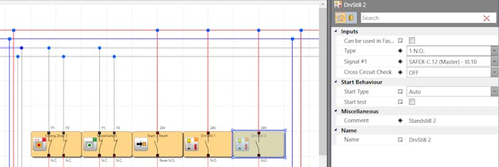

Fig. 10.: Settings of “Drive standstill” inputs connected to SAFEX control

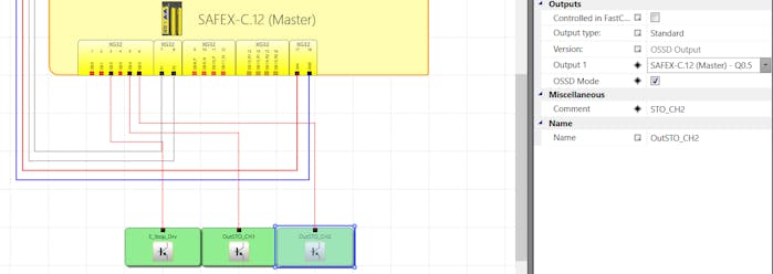

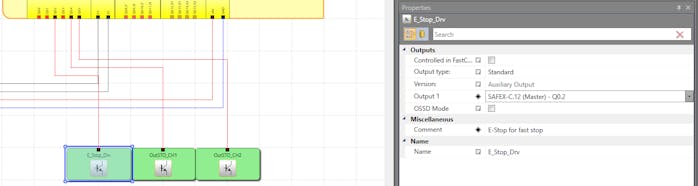

Fig. 11.: Settings of E-Stop output of SAFEX control
Mind that the E-Stop is not using an OSSD output.
In order to achieve this, the property SIL Level of the SAFEY control needs to be set to SIL2 (see Fig. 6). Then the Output type may be selected as Standard (see in here Fig. 11)”.
If using OSSD output signals the overall SIL Level for those safety functions is SIL3, even if only SIL2 is been selected.
Fig. 12.: Settings of STO outputs of SAFEX control

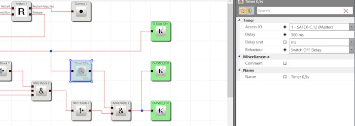

4. Safe logic inside SAFEX control

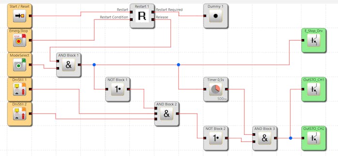

The safe logic inside the SAFEX control is created according to the following schematics.
Fig. 13.: Safe logic inside SAFEX control

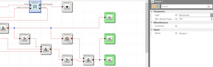

Fig. 14.: Settings of Restart block
Fig. 15.: Settings of Timer (in here as delay time 0,5 s is chosen, in your application this time may differ)
5. Wiring of ctrlX DRIVE
The wiring of ctrlX DRIVE with STO is done according to the following:
Fig. 16.: Wiring of ctrlX DRIVE with STO

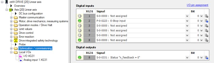

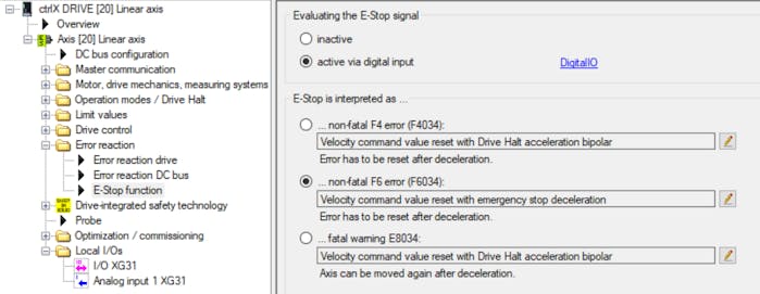

6. Settings of ctrlX DRIVE
The settings inside ctrlX DRIVE are done according to the following:
Fig. 17.: Settings of ctrlX DRIVE (1): I/O signal settings

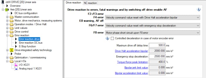

Fig. 18.: Settings of ctrlX DRIVE (2): Error reaction settings
Fig. 19.: Settings of ctrlX DRIVE (3): E-Stop reaction settings
