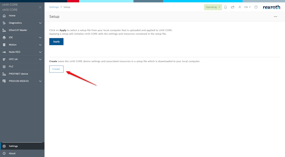

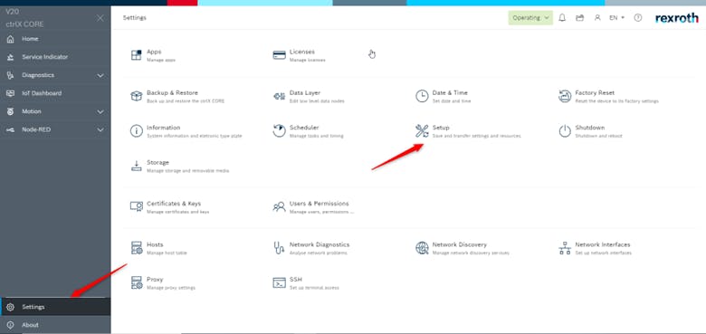

Navigate to settings and Setup.
Settings
Click on Create.

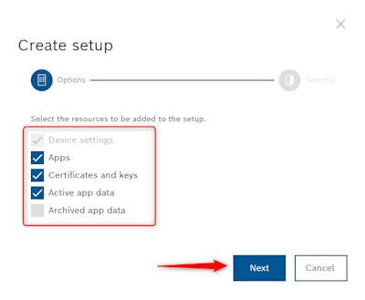

Select the desired resources and press Next.

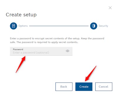

The Setup can be secured by a password, but it does not have to be and then press Create.
Selection of the resources
Choose a password

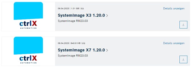

Step 1: Download the desired systemimage
Download the desired systemimage from the collaboration room. The path for V1.20.0 should be: Start/ctrlX AUTOMATION/ctrlX CORE APPS Releases/V1.20/ctrlX CORE Systemimage
Make sure you download the correct version (e.g. V1.18.0 or V1.20.0) and it is appropriate for the device (e.g. X3 or X7).
Systemimage V1.20.0 for ctrX CORE X3 or X7

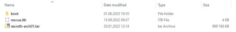

Delete all existing files on the SD-card or format it such that it has only one partition and the format is FAT32. After this step, unzip the previously downloaded system image and copy the following files/folders on the SD-card in the root folder:
file: rescue.itb
folder: boot
folder: rexroth-arch01.tar
The SD-card should now look like this:
Root folder of the microSD with the reset files

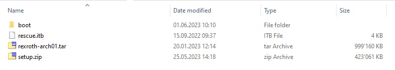

Step 3: Copy the setup to the SD-card
Now, the setup has to be copied in the root folder of the SD-card as well. It is important that the name of the setup file is exactly: setup.zip
Otherwise, the file will not be found and the setup can not be executed.
The root folder of the SD-card should now look like this:
Root folder of the microSD with the reset and the setup files

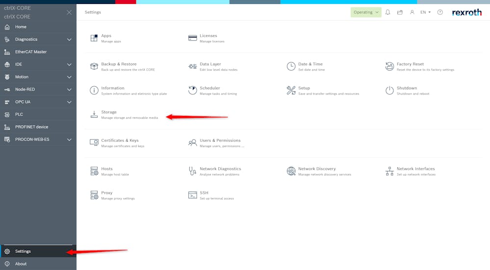

Step 5: Remove the SD-card properly
If you have an engineering PC, you can navigate to settings and storage.
Settings and storage
Now select your microSD-card and click on remove safely. After this step, the ctrlX CORE can be used with the new setup.
Select the microSD and remove it
