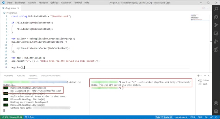

Serving a .NET Minimal API over Unix Sockets
Applications based on ASP.NET are served via the build-in cross-platform web server named Kestrel. By default, Kestrel is set up based on a TCP/IP Socket using the parameters specified within different environment variables, for example usingĀ ASPNETCORE_URLSĀ for interface and port bindings. That makes sense because APIs are usually created for communication between applications over a network.
But it’s just the default. Adjusting the configuration via the well-designed interface is very easy. With a few lines of code, you can build and run an API that uses Unix Domain Sockets instead of TCP/IP Sockets based on ASP.NET. We will look at some practical use cases later in this article.Ā But for now, we will walk through server and client application code which demonstrates how to work with Unix Sockets. To get started with our first server application we create a new minimal API using the dotnet CLI:
dotnet new webapi -minimal -o SocketDemo
Then we replace the entire content of theĀ Program.csĀ file using the next code snippet. Within this code extract, the constantĀ UnixSocketPathĀ defines the path that is used to create the socket on the file system. After some sanity checks, Kestrel is advised to use the defined socket file viaĀ ListenUnixSocketĀ With this simple line of code all pre-defined registrations of TCP/IP stack-related settings are replaced. The remaining parts of the snippet follow the common syntax when creating minimal APIs using .NET
const string UnixSocketPath = "/tmp/foo.sock";
if (File.Exists(UnixSocketPath))
    File.Delete(UnixSocketPath);
var builder = WebApplication.CreateBuilder(args);
builder.WebHost.ConfigureKestrel(options =>
    options.ListenUnixSocket(UnixSocketPath);
var app = builder.Build();
app.MapGet("/", () => "Hello from Foo API served via Unix Socket.");
app.Run();
To run the example on Windows-based systems, I can recommend WSL 2. Visual Studio and Visual Studio Code come with excellent remote integrations so you can run the code directly from the development environment.Ā The screenshot below shows the previously presented sample executed within a Visual Studio Code WSL 2 remote session. The left terminal window shows the running ASP.NET application executed viaĀ dotnet run, confirming that we are serving the API using the defined Unix Socket.
Running the .NET Minimal API directly from Visual Studio Code using WSL2 remote session
The right terminal window shows a client request using the curl commandĀ curl -w "\n" --unix-socket /tmp/foo.sockĀ http://localhost/Ā The output represents the expected response from our server application.

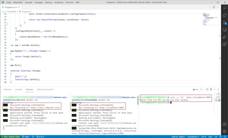

Consuming an API using Unix Domain Sockets
With the command line toolĀ curlĀ we just saw one of many possibilities to request data from our server application. In this section, you will learn how to build .NET clients that can consume data from our Unix Socket-based backend. We will focus on ASP.NET-based application since this type is typically used when building apps for ctrlX CORE.
In the case of web applications developed with ASP.NET, we can benefit from both embedded dependency injection and Refit. This combination allows centralized configuration of our endpoints, whereby no API-specific knowledge is required during the use of the external API over Unix Sockets.
Refit is an automatic type-safe REST library for .NET Core,
Xamarin and .NET that turns your REST API into a live interface.
(https://github.com/reactiveui/refit)
Within the next code snippet, we will have a look at the configuration and usage of a Unix Socket-based API with ASP.NET and Refit. The snippet covers the following steps:
  1. Create an interface representing the API
    APIs are described by an interface. Methods represent single endpoints configured via additional attributes. In our example, theĀ IFooApiĀ interface represents our Minimal API backend. Using the attributeĀ [Get("/")]Ā the specific endpoint of the API is mapped to the interface method.
  2. Register the Refit client embedded dependency injection (DI) container
    By the call of the extension methodĀ AddRefitClientĀ all required dependencies are registered within the DI container. For this the NuGet packageĀ Refit.HttpClientFactoryĀ must be installed previously.
  3. Configure the primary HTTP message handler
    With this next step, Refit is advised to use theĀ SocketsHttpHandlerĀ class as the primary HTTP message handler, which is the same implementation as in our console application example before. Hence, all API calls using the registered interface are processed using the HTTP messaging pipeline.
  4. Configure the HTTP client
    Finally, the set-up of the HTTP client should take place. In the example below, the configuration is reduced to the base address of our backend. Since we are focusing on Unix Domain Sockets, of course, this is localhost.
using System.Net.Sockets;
using Refit;
const string BaseAddress = "http://localhost";
builder.Services
    .AddRefitClient<IFooApi>()
    .ConfigurePrimaryHttpMessageHandler((_) =>
        return new SocketsHttpHandler
            ConnectCallback = async (_, _) =>
                var socket = new Socket(AddressFamily.Unix, SocketType.Stream, ProtocolType.IP);
                var endpoint = new UnixDomainSocketEndPoint(UnixSocketPath);
                await socket.ConnectAsync(endpoint).ConfigureAwait(false);
                return new NetworkStream(socket, ownsSocket: false);
    .ConfigureHttpClient((_, client) =>
        client.BaseAddress = new Uri(BaseAddress);
app.MapGet("/", (IFooApi fooApi) =>
    return fooApi.GetFoo();
app.Run();
internal interface IFooApi
    [Get("/")]
    Task<string> GetFoo();
With this basic configuration, the API can be called via the interfaceĀ IFooApi. The interface can be injected using the mechanisms of ASP.NET, which means in every instance created by DI, for example, Controllers.
