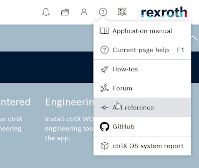

To test the reboot API is quite easy! We need to go to the API page, the link is already on the top-right:
REST API link

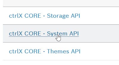

Then we need to select the right API category which is "System-API":
System API

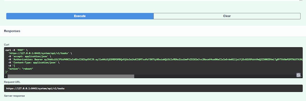

What we need to do is to create a "reboot task" but first don't forget to authorize using the Authorize button!
Authorize Button

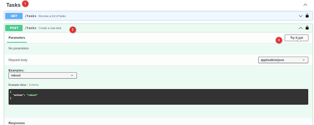

We're almost done! We have to find the Task section (1) then move to "Create a new task" (2) and select reboot then click on "Try it out" (3).
Try a task
Clicking on "Execute" the system will send a post containing the reboot request!
REST API example
Now the system is rebooting!

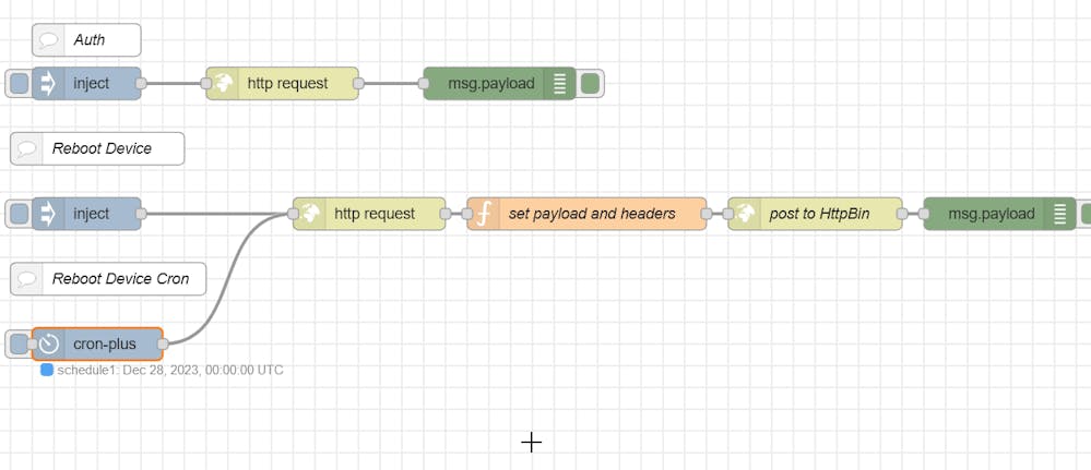

Here is the final code. Really easy, any time that the "cron-plus" or the "inject" nodes emits a signal the device is rebooted.
Node-Red Code

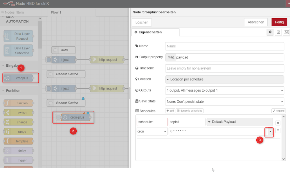

To implement this the "cron-plus" node has been used (just because personally I find it really easy and configurable). To have it we have to install with the palette this extension:
Node-RED Palette Cron

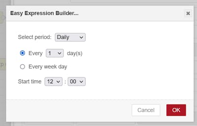

Once we have it the configuration is really easy, just add the node and configure the schedule!
Configure the schedule

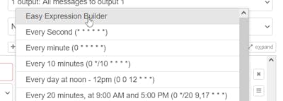

I personally use the "Easy Expression Builder" because I am lazy. Anyway, it is really easy to configure and adjust.
Easy Configuration
Easy Configuration Example
