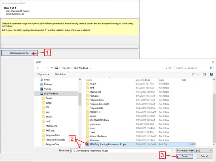

Click “Select parameter file”, select file “STO Only Starting Parameters R1.par” then click “Open”:
Select parameter file xSTO Only Starting Parameters R1.par"

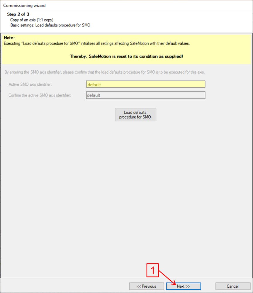

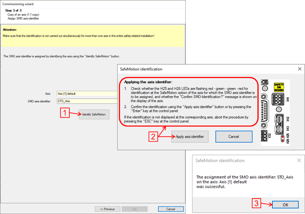

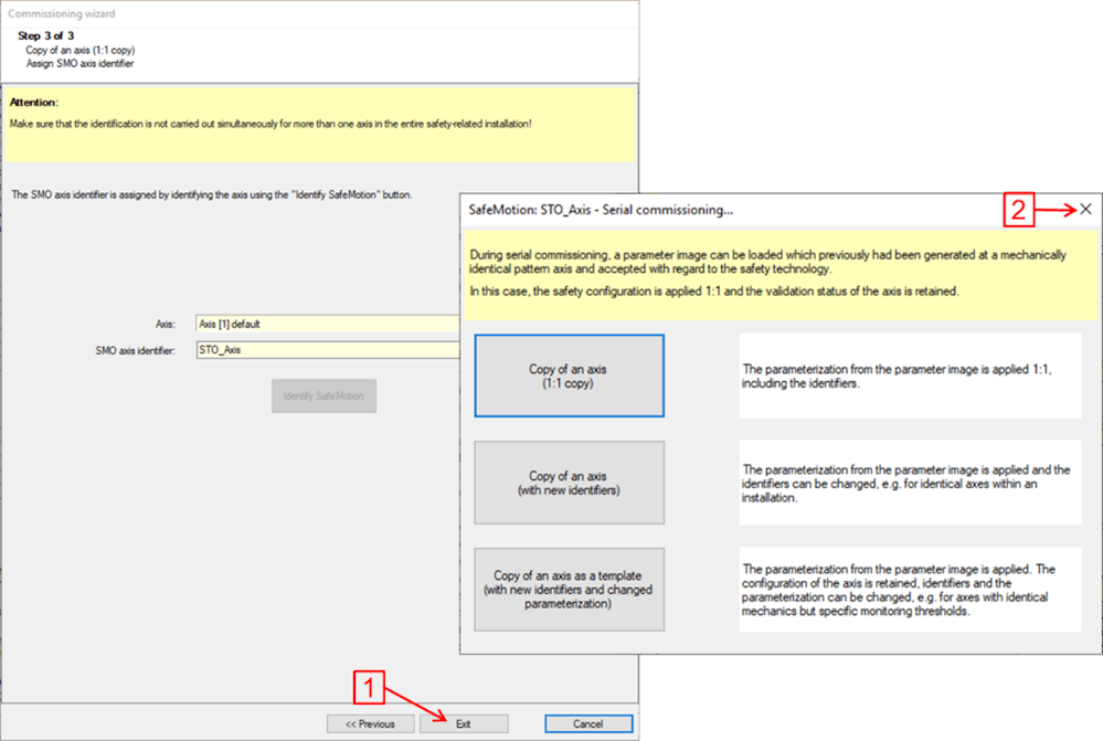

After the file (parameters) are done loading click the “Identify SafeMotion” button. Follow the instructions to ensure the parameters were loaded to the correct axis then click “Apply Axis Identifier”. After the SMO axis identifier is applied click “OK”:
Apply axis identifier
The serial commissioning load parameters process is completed, click “Exit” then “X” to close the “Serial Commissioning” window:
Exit serial commissioning

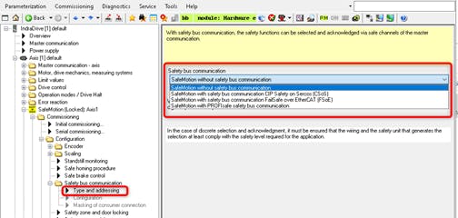

Expand Axis [1] default\SafeMotion (Locked): STO_Axis\Commissioning\Configuration\Safety bus communication then double click “Type and addressing”. Click the checkbox to confirm this is the axis to be parameterized then click “OK”:
Type and addressing confirm axis

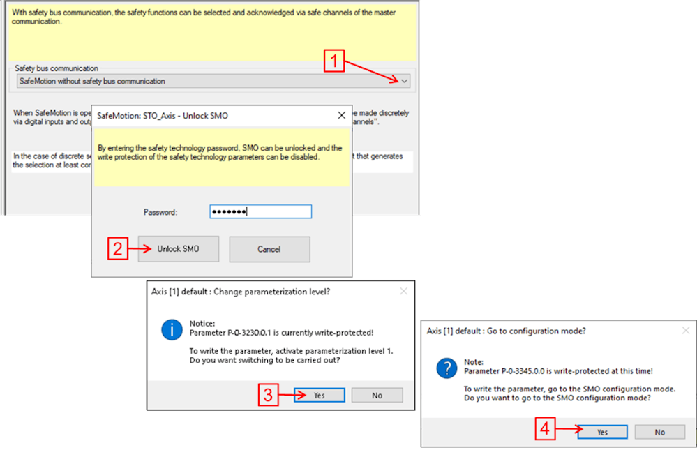

Use the pull-down menu to select the desired safety bus communication protocol:
Select desired safety bus communication protocol
When changing the safety bus communication protocol, you will be prompted for the SMO Password. Enter “Rexroth” then click on “Unlock SMO” then click “Yes” on the two popup windows to enter parameterization level 1 and SMO configuration mode (SCM):
Unlock SMO

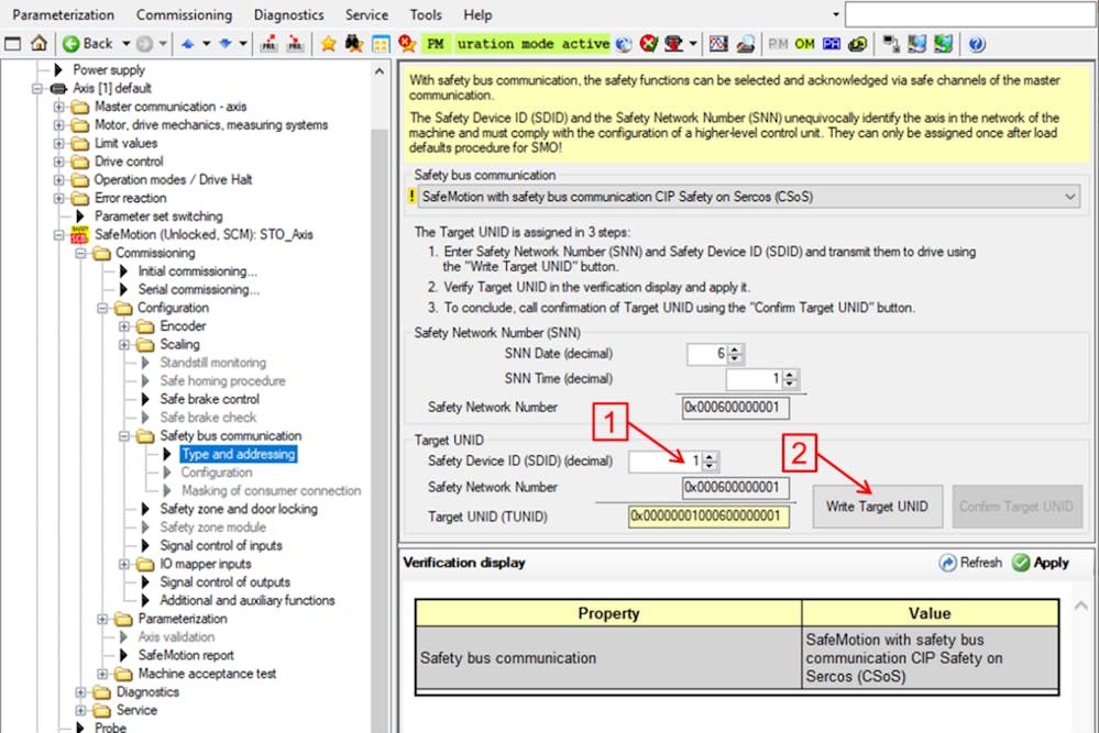

CIP Safety on Sercos (CSoS) Configuration

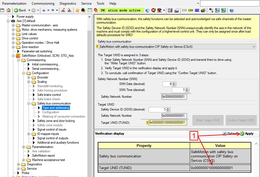

Enter the desired “Safety Device ID (SDID)” then click “Write Target UNID” button:
CSoS Write Target UNID
The “Write Target UNID” button is now greyed out. Confirm the “Target UNID (TUNID)” value is correct in the “Verification display” area then click “Apply”:
The “Confirm Target UNID” button is now active. Click the “Confirm Target UNID” button then click “Yes” to assign\confirm the Target UNID for this axis:
CSoE Confirm Target UNID
The CIP Safety on Sercos (CSoS) Target UNID is completed:
CIP Safety on Sercos (CSoS) Target UNID completed

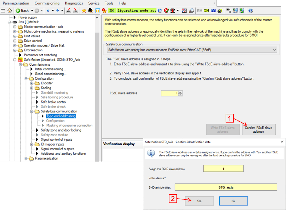

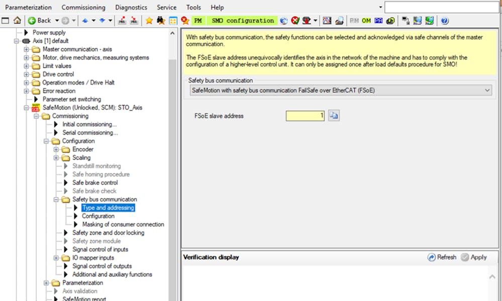

FailSafe over EtherCAT (FSoE) Configuration

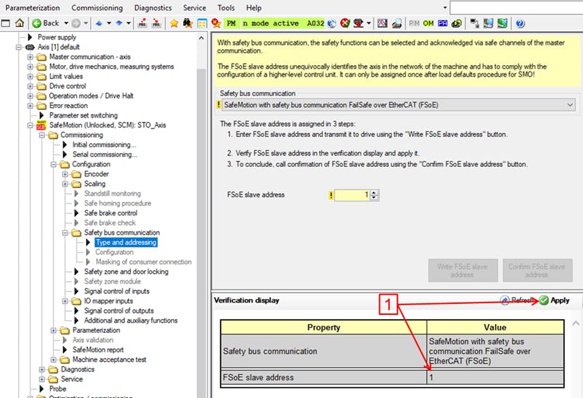

Enter the desired “FSoE slave address” then click “Write FSoE slave address” button:
Assign and Write FSoE slave address
The “Write FSoE slave address” button is now greyed out. Confirm the “FSoE slave address” value is correct in the “Verification display” area then click “Apply”:
Apply FSoE slave address
The “Confirm FSoE slave address” button is now active. Click the “Confirm FSoE slave address” button then click “Yes” to assign\confirm the FSoE slave address for this axis:
FailSafe over EtherCAT (FSoE) slave address is completed:
FailSafe over EtherCAT FSoE slave address completed

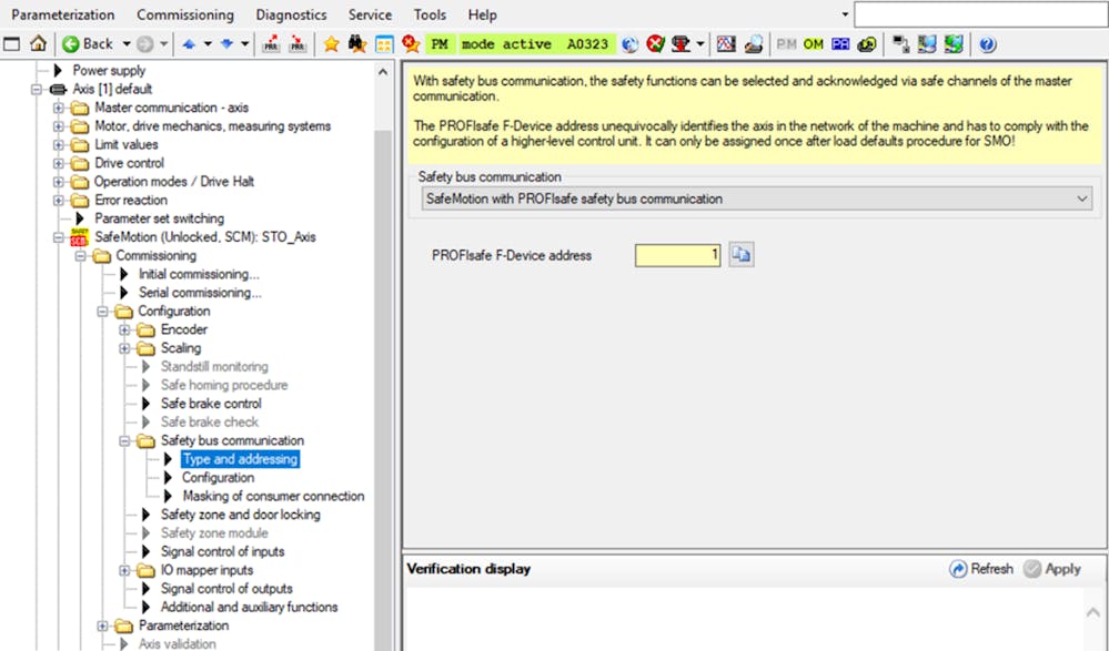

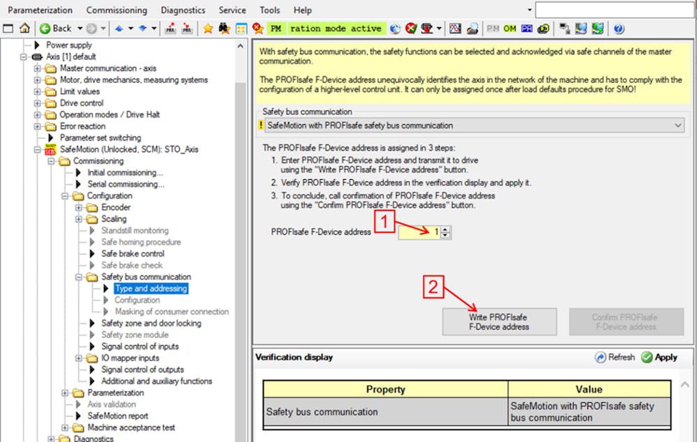

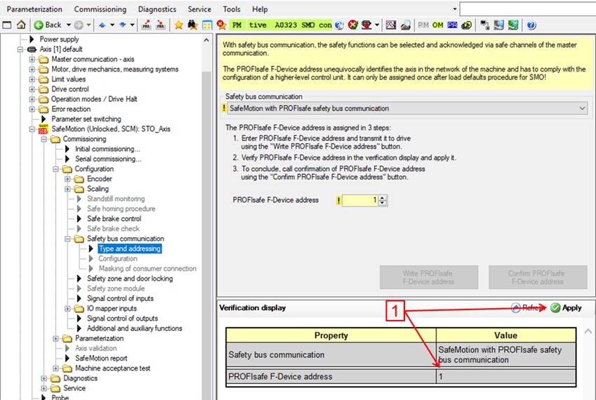

PROFIsafe over PROFINET Configuration
Enter the desired “PROFIsafe F-Device address” then click “Write PROFIsafe F-Device address” button:
The “Write PROFIsafe F-Device address” button is now greyed out. Confirm the “PROFIsafe F-Device address” value is correct in the “Verification display” area then click “Apply”:
Apply PROFIsafe F-Device address

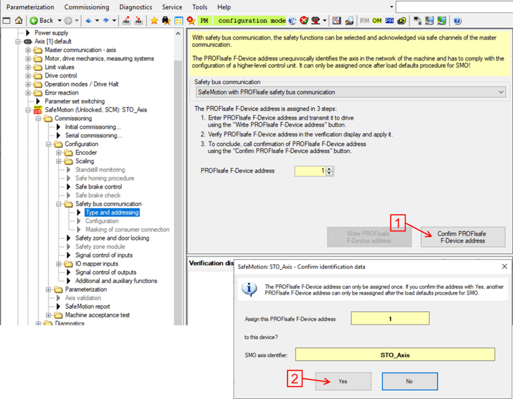

The “Confirm PROFIsafe F-Device address” button is now active. Click the “Confirm PROFIsafe F-Device address” button then click “Yes” to assign\confirm the PROFIsafe F-Device address for this axis:
PROFIsafe F-Device address is completed:
PROFIsafe F-Device address completed

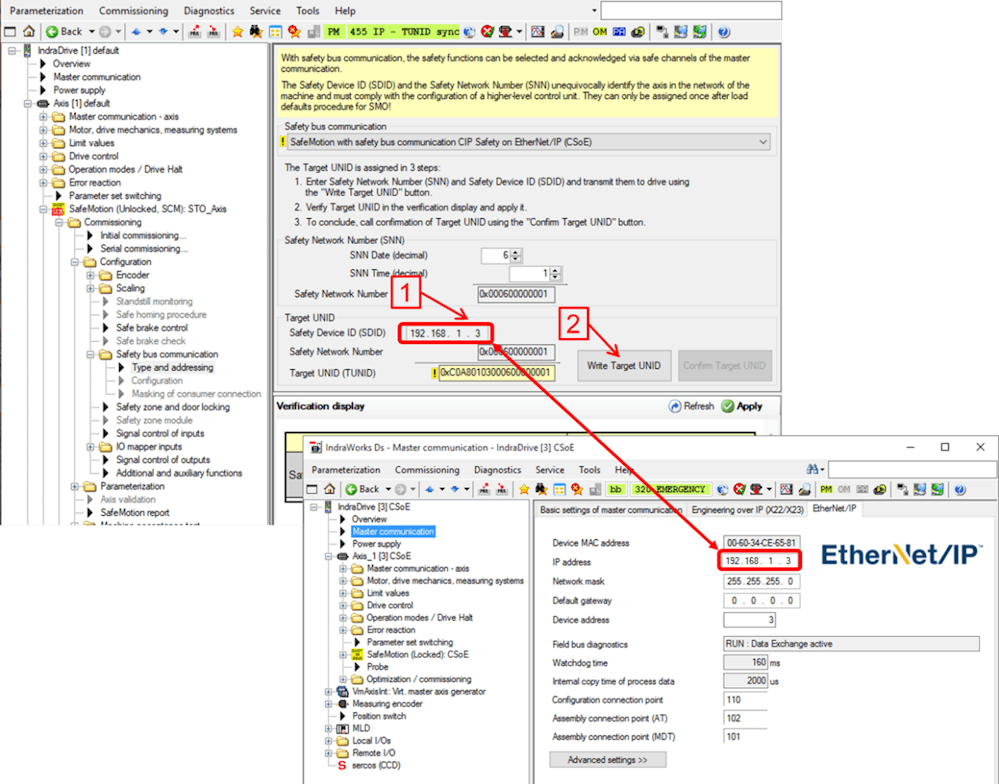

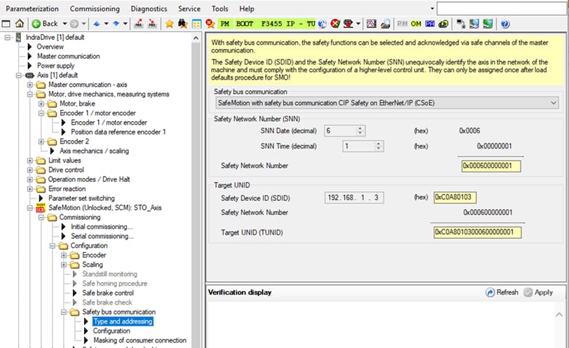

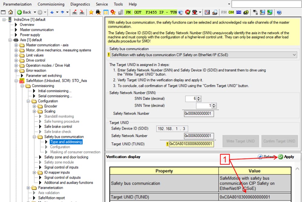

CIP Safety over EtherNet/IP (CSoE) Configuration
NOTE: MPx21 firmware must be used for CIP Safety on EtherNet/IP (CSoE) selection.
The “Safety Device ID (SDID)” should be automatically copied from the “Master communication” screen. These values must match, do not change the “Safety Device ID (SDID)” on this screen. Click the “Write Target UNID” button:
CSoE Write Target UNID
CSoE Apply Target UNID

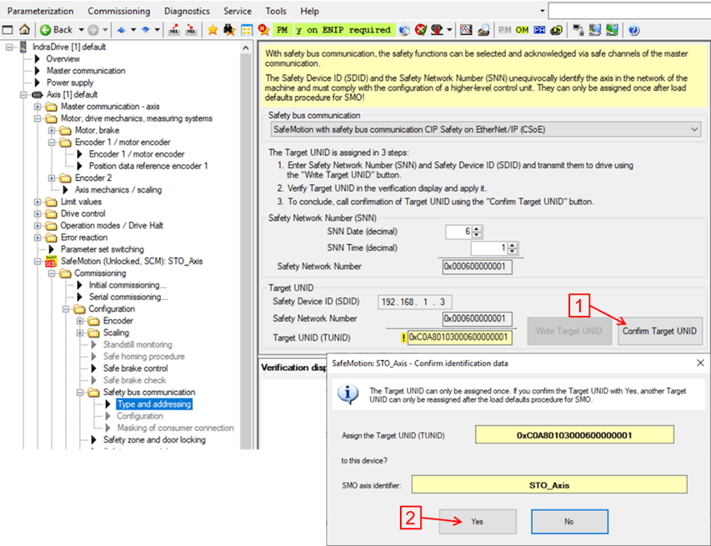

CIP Safety on EtherNet/IP (CSoE) Target UNID is completed:
CIP Safety on EtherNet IP CSoE Target UNID completed

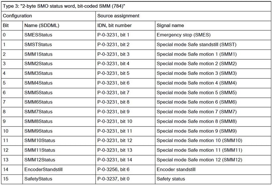

The SMO Status can be read in the safety PLC using the bits in the SMO Status Word:
SMO Status Word

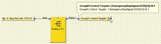

The “Emergency stop signal (ES)” is used as the safe out with an input pair wired as the input selection:
Emergency stop signal ES

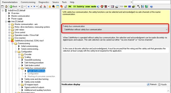

Select “SafeMotion without safety bus communication”:

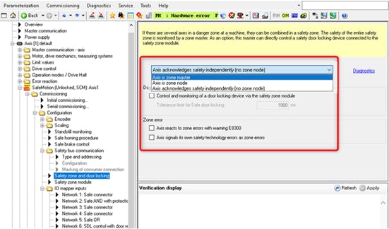

Open “Safety zone and door locking” then select “Axis is zone master” or “Axis is zone node” depending on where the axis is in the zone network, configure other options for your application:

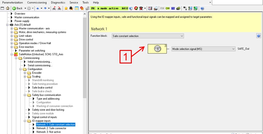

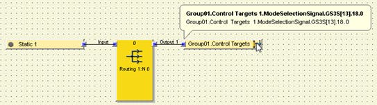

Network 1 is used to select the Function Block “Safe constant selection” with “Mode selection signal (MS)” as the safe out:
Network 1 with xMode selection signal MS.
Network 2 is used to select the Function Block “Safe connector” with “Emergency stop signal (ES)” as the safe out. The input pair wired to the HSZ Zone Module is used for the safe in:
Network 2 with Emergency stop signal ES

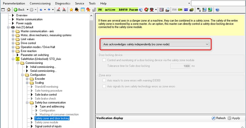

Open “Safety zone and door locking” then select “Axis acknowledges safety independently (no zone node)”:

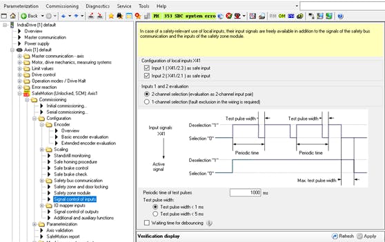

If local I/O X41 is going to be used, then these inputs must be configured under “Signal control of inputs”:

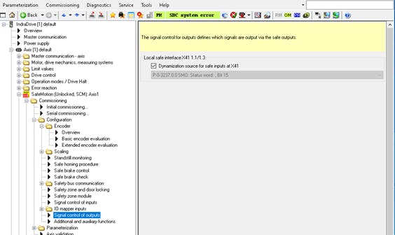

If local I/O X41 will be used as the dynamization source, then this will need to be configured under “Signal control of outputs”:

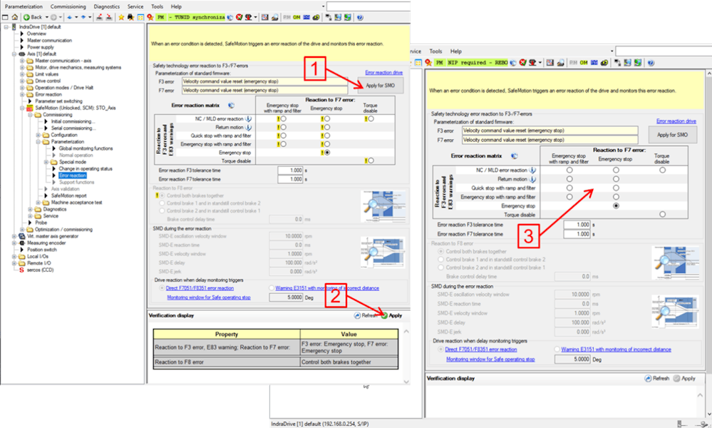

NOTE: The following steps are only required if the error reaction on the standard firmware side have been modified from factory default.
If the error reaction on the standard firmware side has NOT been changed from factory default go to Exit SMO configuration - Parameter Mode
Error Reaction
The error reaction must be setup the same as the standard firmware. Expand “Axis [1] default\SafeMotion (Unlocked, SCM): STO_Axis\Commissioning\” then double click on “Error Reaction”.
  1. Click “Apply for SMO” to copy the error reaction from the standard firmware
  2. Click “Apply” to confirm the values copied from the standard firmware side.
  3. Once the changes are applied the window shows no more exclamation marks, error reaction configuration is complete:
Error Reaction

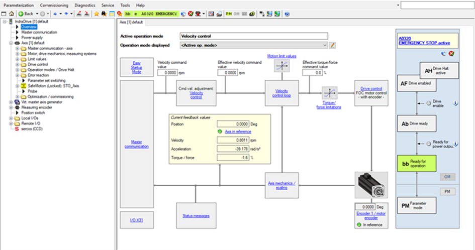

The axis is now in operating mode:
Axis is in operating mode
