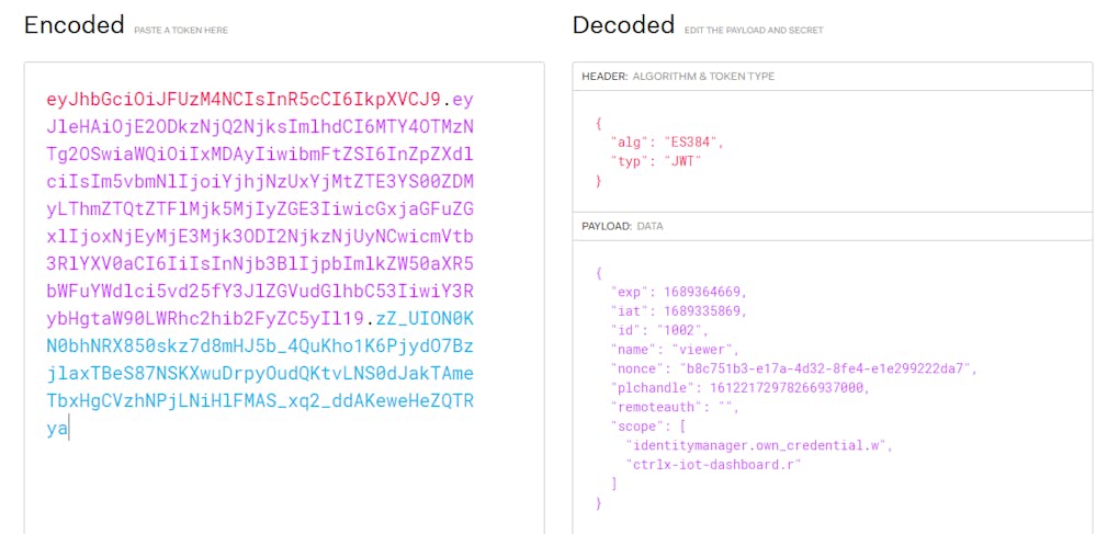

Nice tip:
To find the right permission can be tricky even for the best developers, a smart way to find the right permissions can be:
  • Create a user that has all the permissions that we need.
  • Generate a token for that user
  • Paste the token here: jwt.io and get the result 😘
For example, this Token has just the capability to see IoTdashboard app(no modify) and modify his own user password.
JWT io

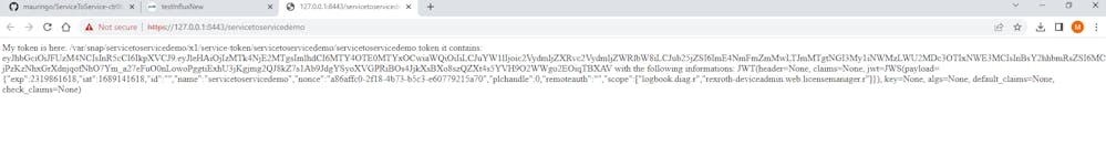

STEP3: create the app and install it
Once compiled and installed the app creates the "servicetoservice" entry in the sidebar. This link takes to a Flask webserver that serves the token and the token's info:
Token Demo
The token which is called SNAPNAME.token is contained in this folder: $SNAP_DATA/service-token/${SNAPCRAFT_PROJECT_NAME}.
