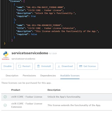

Step 1: Add the license info in the Package Manifest
This step is not the actual technical license check but will improve the usability of the app. Inserting these info in the Package Manifest we enhance our app with the graphical info, in the app install page, with the needed licenses to run the app.
Lincenses UI user

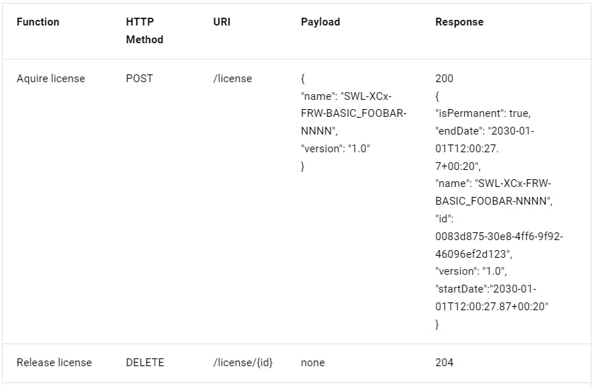

The important APIs to take into consideration are the following and are listed in the official documentation, can be tested directly on the core with swagger and plus we have a dedicated section here: Swagger online.
REST API calls
The workflow is the following:
  1. Whenever we boot the device the app should ask for the license with the "acquire license" API. The answer will contain an ID that should be kept to release the license in a second time. In this case we can start the app normally otherwise we block the app.
  2. If the app is removed we need to use the Release License API to release the license.

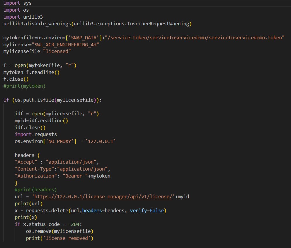

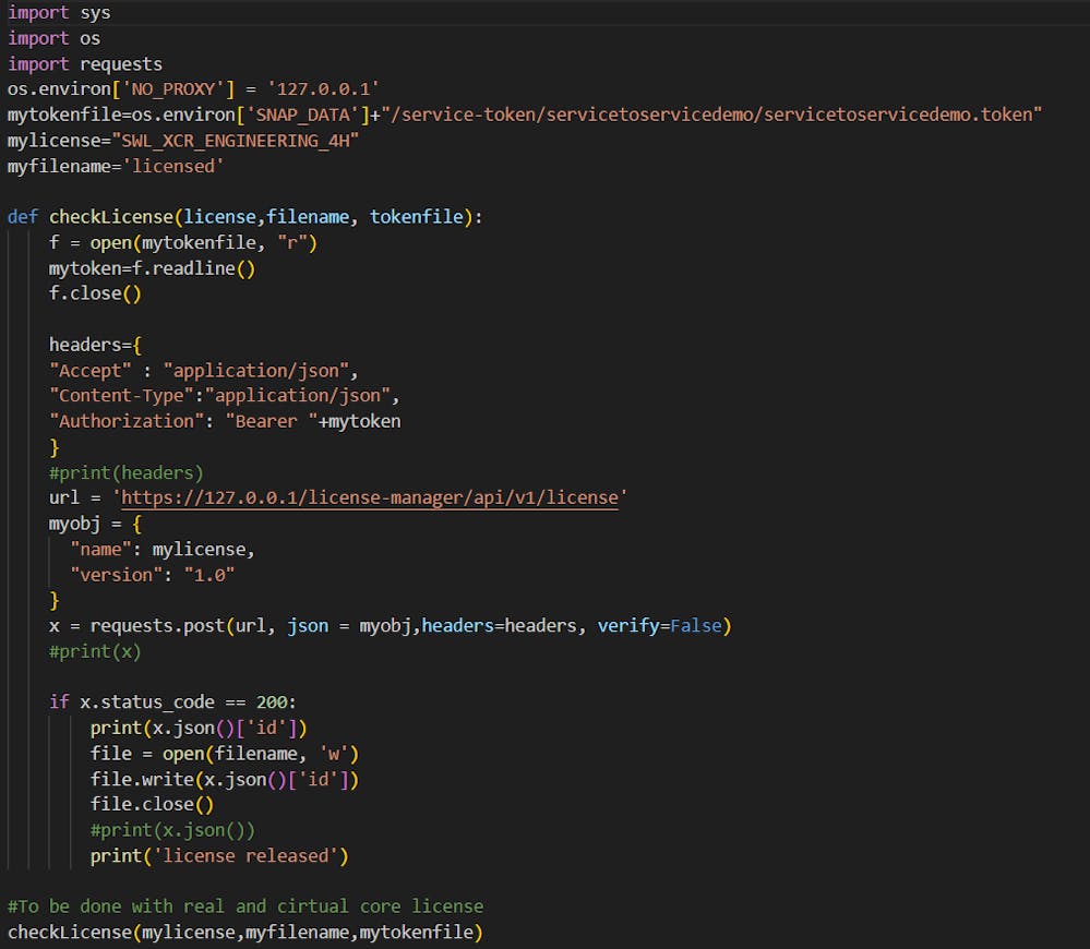

In this demo I save the ID in a file located in $SNAP_DATA and I create a file named "licensed" just to register that the app is correctly licensed. This process is achieved using a python script:
Licensing Python Code
I remove the proxy setting for this script, in this way I am avoiding to use the proxy for local host and I can't have problems with such configurations. The script to unlicense the app is the following:
Unlicensing python script
If we find the "licensed" file we read the ID contained and we release the license. We then remove also the file itself.

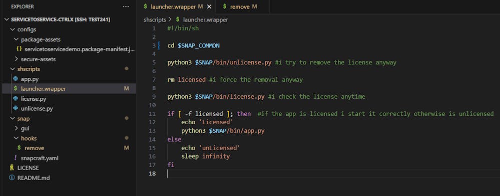

In case the app is removed we take advantage of the "remove hook" functionality which is a script called automatically when the app starts. Here is the documentation Hooks Explaination.
Remove Hook
The hook just calls the "unlicense.py" script. The app is normally started with a launch.wrapper script which unlicenses the app and license it again, checking the file with the id presence.
Wrapper structure
