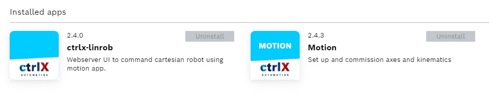

  • ctrlX OS 2.xx. installed in a ctrlX CORE device (X3, X5, X7 or virtual)
  • Offical Bosch Rexroth Motion App
  • Source code for custom Python webserver app
installed apps
This project has been developed from the example in the official Bosch Rexroth app development SDK. If you want to have access to the specific source code of the implementation presented in this How-To, do not hesitate to leave us a comment and we will contact you.

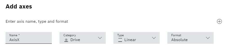

After that we are allowed to define new axes by clicking in the blue "+" (or a big ¨+¨ symbol in the middle of the screen if you do not have any axis yet).
Generate 3 axes called "AxisX", "AxisY" and "AxisZ" with the configuration you can see in the image.
NOTE: These names are used by the websever, so keep it consistent.
Adding axes

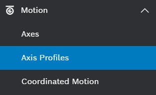

2.2. Map the axes with the hardware profiles (optional)
Axis profiles tab
In this example we are working with virtual axes, so they are not mapped to hardware. If you are working with real drives, follow the common steps to set this up.

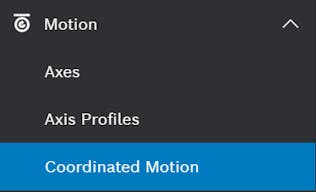

Go to the Coordinated Motion tab.

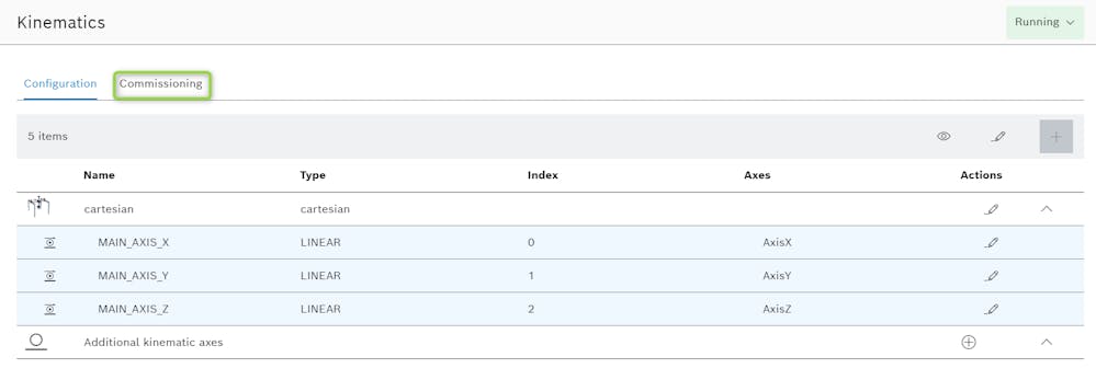

Now you can add a new kinematic with the blue ¨+¨(or a big ¨+¨ symbol in the middle of the screen if you do not have any kinematic yet).
Define a ¨Cartesian¨ kinematics called ¨Kinematics¨. Again, the naming is used by the Webserver, be coherent with it.

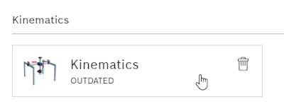

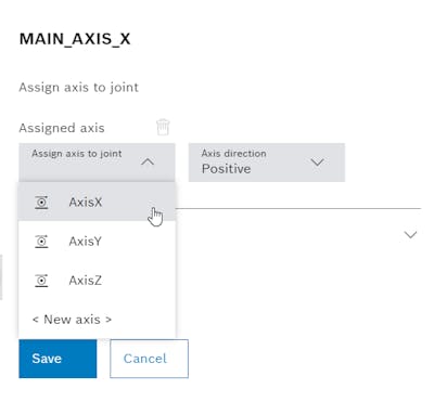

Now, let's add the previously defined axes to this kinematic. Click on the ¨Kinematics¨ picture/text as depicted in the next image.
Edit kinematics
You can connect the axes to the kinematics clicking on the pencil.
Open axis setting
Axis mapping
After this step, you can bring the Motion app back to ¨Running¨state. Make also sure that the whole ctrlX is in Operating State (Not setup, not Service).

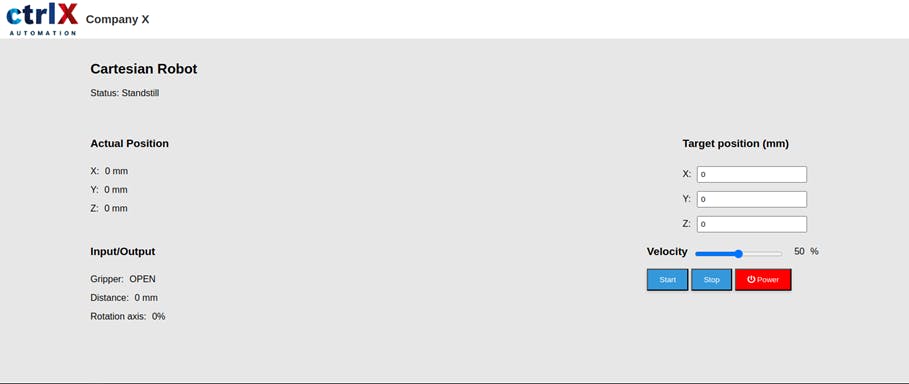

Now, you are ready to interact with the websever. You can open it by clicking under ¨Webserver¨ tab in the lateral menu, a new window will start with the server.  You may need to tell the browser that it is safe place manually.
NOTE: If you are working with ctrlX CORE virtual, do not forget to use port forwarding and map port 5000:5000. It is the port where the server is externally available.
If everything was fine, you should see this.
User interface

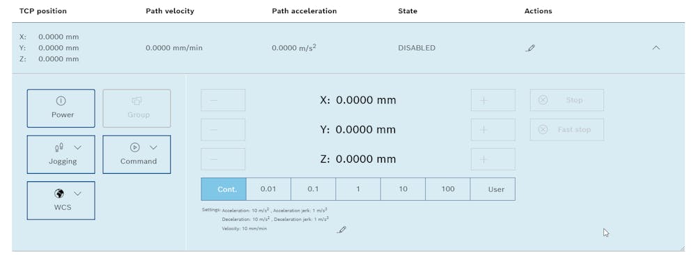

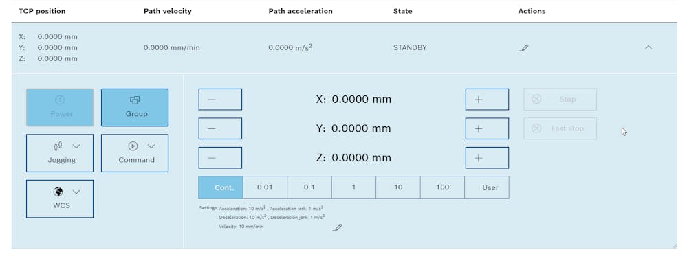

You could already use the webserver, but let's monitor its operation by looking at the Commissioning Tab for Kinematics.
How to go to commisioning tab
You must see something like this:
Comissioning tab
Now let's go back to the webserver and press ¨Power¨. You will see how the button changes color from ¨Red¨ to ¨Green¨. You can see how the kinematics have been powered up.
Kinematics powered up
Let's commision something from the webserver. Write some numbers under ¨Target position¨ and click ¨Start¨ in the webserver. You will see the actual position of the axis in the Comissioning Tab. You can stop this movement at any time by clicking ¨Stop¨  in the websever.
To power off the axis click the ¨Power¨ button in the webserver again, it will turn ¨Red¨. You can inspect the result of this operation in the commissioning tab.
