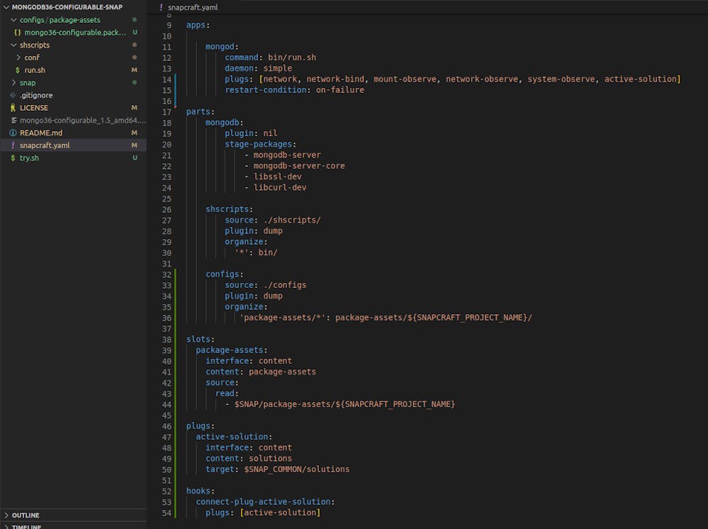

Edit snapcraft.yaml accordingly:
Here is the result we want to achieve. Basically we had (from top to bottom):
  • Added active-solution in the mongodb app plugs.
  • Added a part: configs. it is necessary to embed additional files.
  • Added a slot: we need the slot to let the previous files be available by outside the snap.
  • Added a plug: active-solution. It's the plug we need to have in order to read the memory area with the right permissions.
  • Added a hook: this script is automatically used when the snaps connect the active-solution plug.

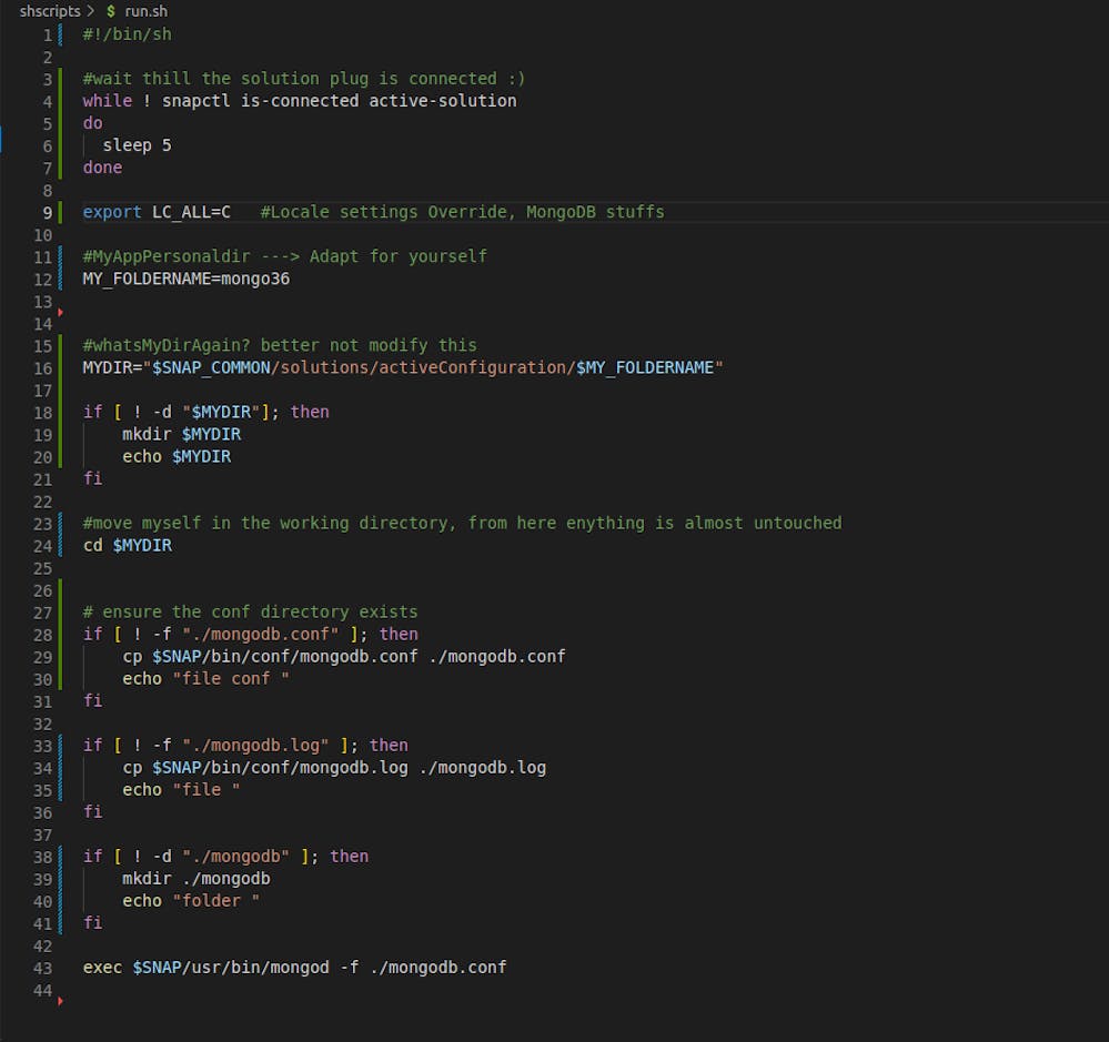

Edit run.sh accordingly
Let's commend easily the starting file:
  • The export LC_ALL=C it's a locale setting, we keep it.
  • The app takes care that we have all the needed folders/files before to start, we need to adapt it.
  • The snap has been projected to run in the $SNAP_COMMON folder so we need to change it accordingly.
Here is the new file:
  • We need to wait that the plug is correctly set, so we wait then some time.
  • The export LC_ALL=C it's a locale setting, we keep it as before.
  • We build our folder: basic directory + the foldername we want to use, in this case mongo36.
  • The app takes care that we have all the needed folders/files before to start, we go directly with CD in the right path.
  • The snap in the end runs in the same situation as before but, in a different directory and with a waiting delay in the start.

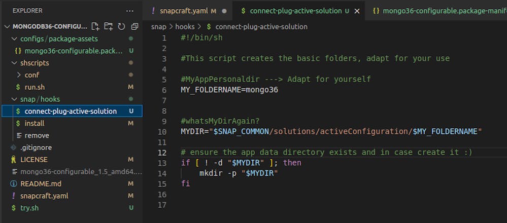

Add the hook
We need to add in ./snap/hooks our hook file named "connect-plug-active-solution". This file will be called on the snap plug connect event and will prepare the memory folder for us. Here we have the content, the folder path is created just as before.

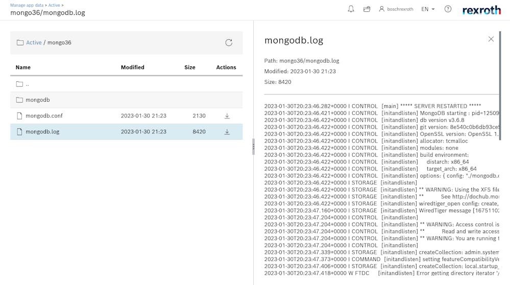

The result
Well, now our app is finished, we just need to test it. In the "APP DATA" folder we can now see the mongoDB configuration file and logs.
App result
