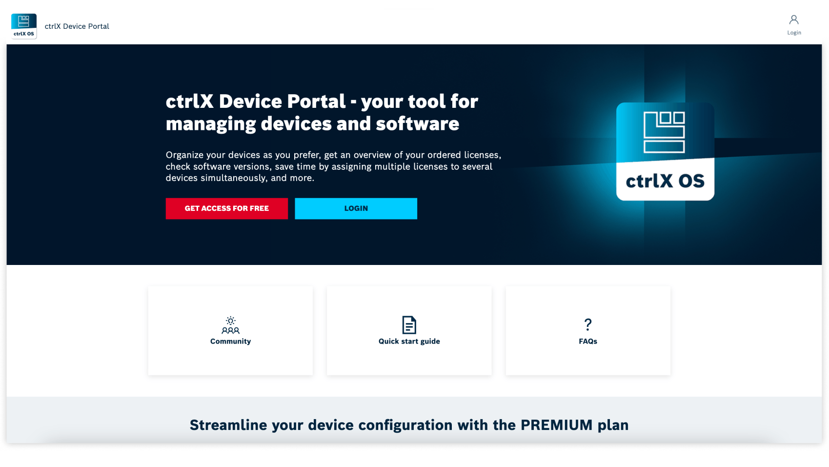

Get access
Request access to your company account at ctrlX Device Portal
You will need your company account ID, find it in the License Certificate or in the Welcome email. The company account admin can also add you to the account under the User Management page.
Once you got the access approval to your company account, sign-up or login with SingleKey ID and start managing your devices.

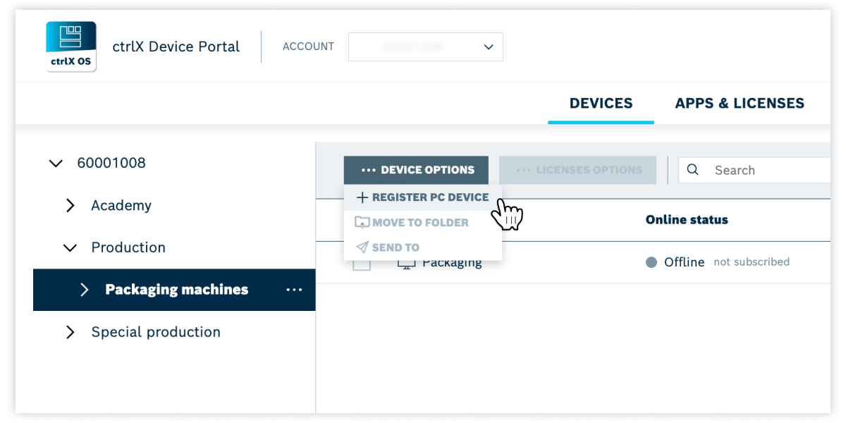

Organize with folders
In Devices and Orders you will see on the left-side a menu with your company account ID. Here you can Add sub-folders and create a structure that best fits your company needs.
The folders have a permission boundary – this ensures the teams see and manage only what’s relevant to them.
❗️If your account does not have any admin please contact: [email protected]Β
Add devices
In the Devices page you can add and prepare the devices.
Your ctrlX COREs and SD-Dongles are added automatically, after shipping.
To add a PC, click on Device Options and Select Add PC device.

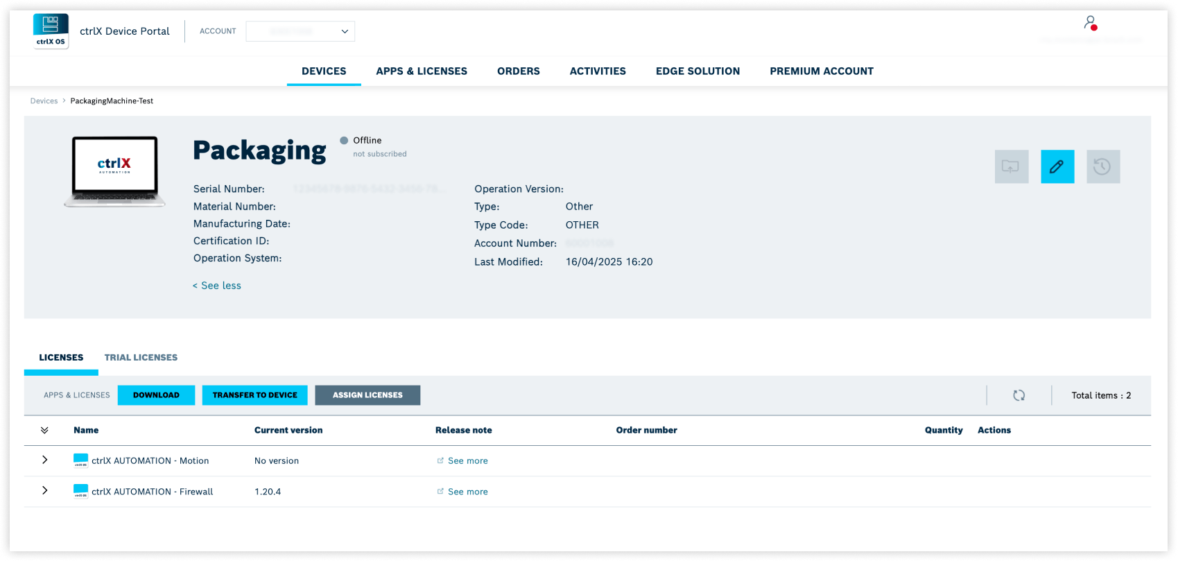

Configure devices
Within a device, you can see which apps and licenses are already assigned, the app version and other related details.
You can Edit the name and description or See more information about the device.
Click Download to get the apps and licenses file into your computer or dongle and apply to your device.
Assign Apps and Licenses to Devices
All Licenses are delivered and stored in your customer account.
To configure a device, follow the steps:
- Select one or more devices (up to 25)
- Click Licenses options – Assign Apps & Licenses
- Choose your preferred view
- Select the apps and licenses from the available pool
- Save the assignment
