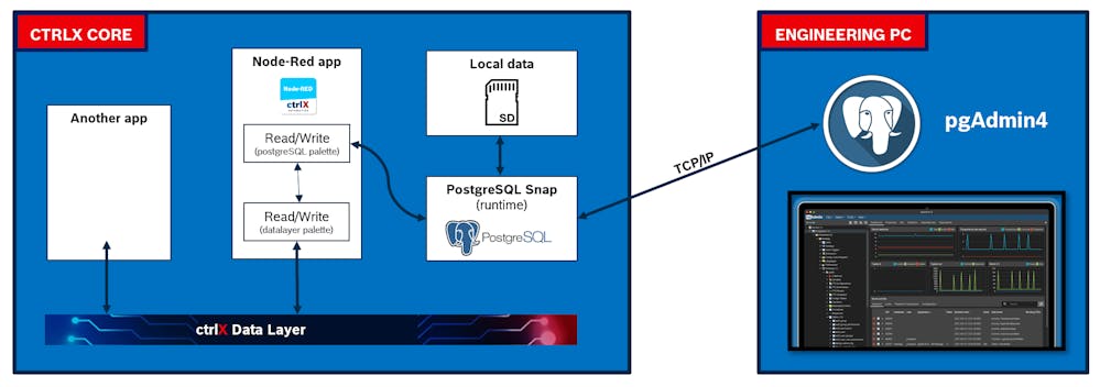

In the following picture you can see what the system structure looks like:
System overview

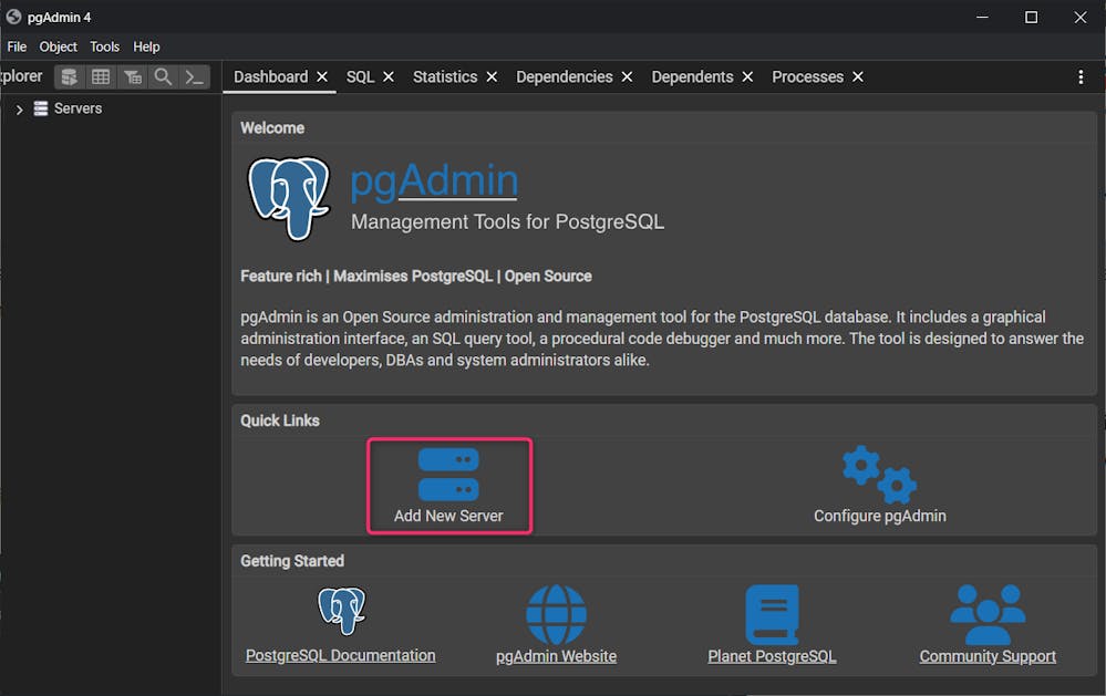

Open PgAdmin4 and add a new server.

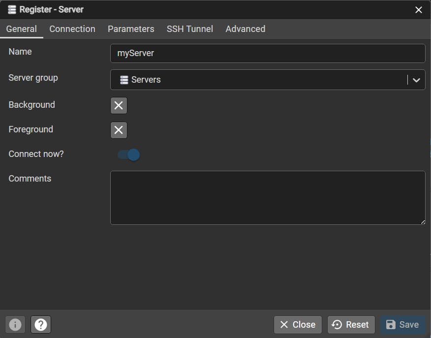

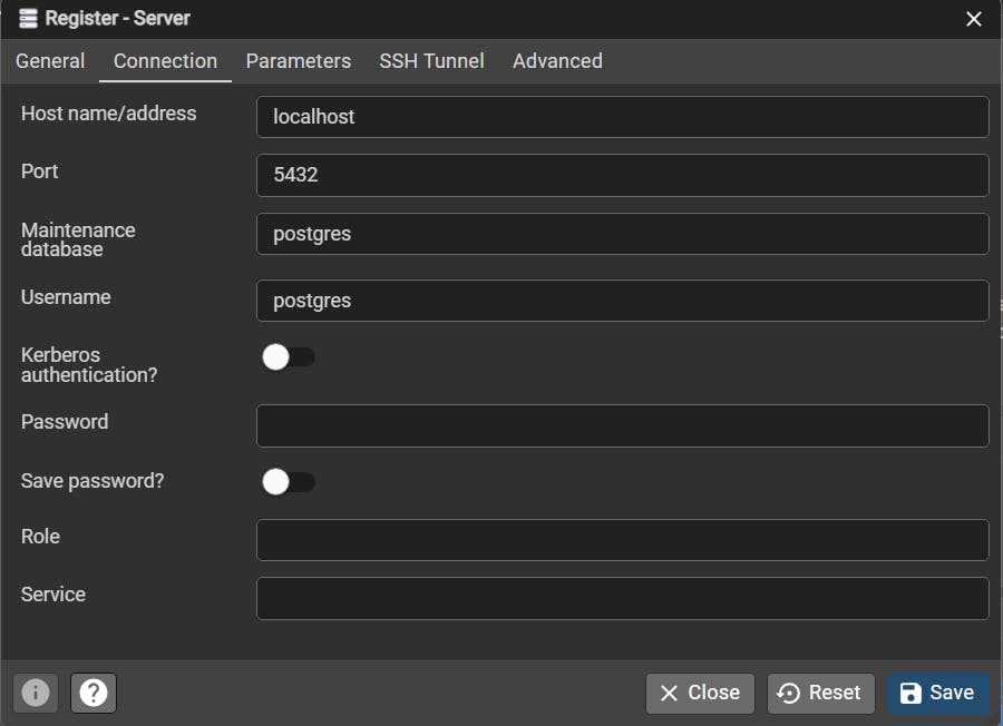

A window will pop up. Fill in the fields as indicated in the image. The server is running in ctrlX COREvirtual, hence localhost (127.0.0.1) must be indicated, if it is a real CORE, simply indicate the corresponding IP address. The user postgres is by default granted to access without password. This can be later edited.
Setting up a server
Setting up a server

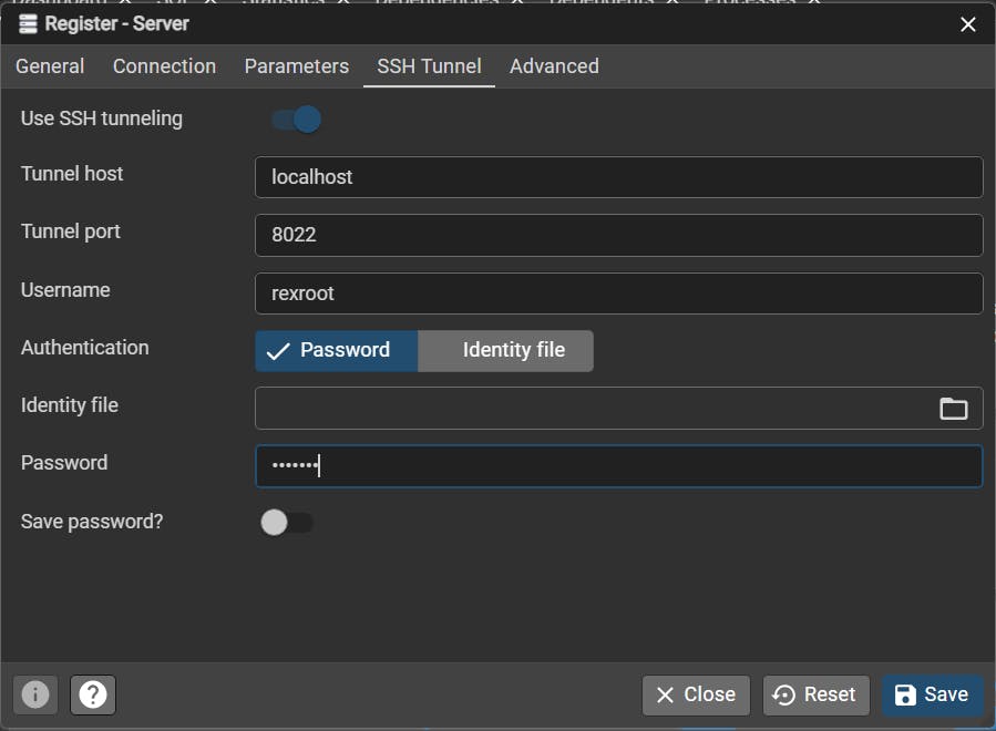

If the connection does not work, in some cases the connection to that IP is protected. You can try with SSH connection with password, you must fill in as follows with your SSH credentials.
SSH connection
And then you can click save, and you will be logged in.

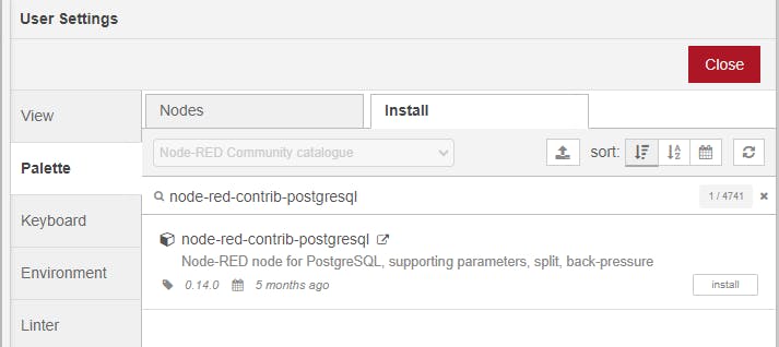

There exists a Node-RED palette to communicate with PostgreSQL. You can download it as seen in the following images. The CORE must be connected to the internet.
Add new palettes
PostgreSQL palette

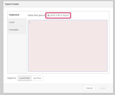

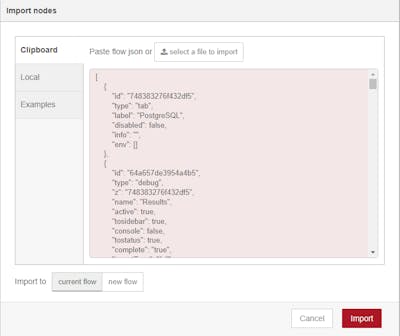

We have prepared some examples to publish to the data base from Node-RED. Find them attached to this How-to (flows_PostgreSQL.zip). To import it, open the "Flow Editor" from Node-RED and proceed as shown in the following pictures:
Import example
Select the .json file
Example json loaded
You must import both flows (.json) in that .zip:

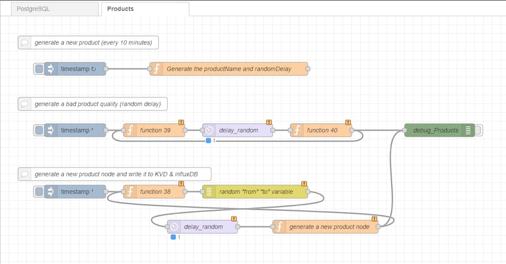

Products: Working in the background, you do not need to interactuate with this. It simulates a product object that would be later publish to the database.
Product object generation

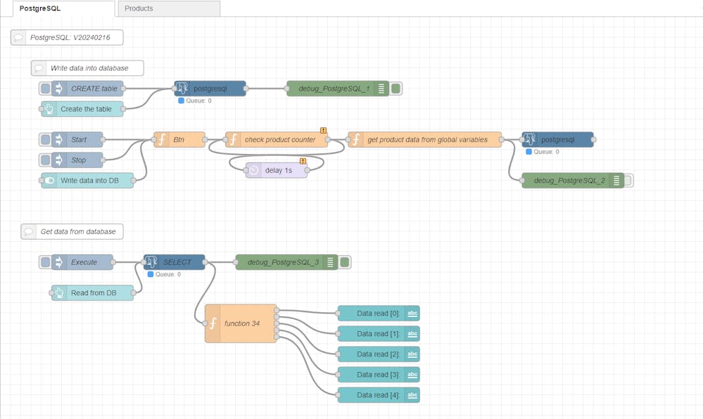

PostgreSQL: It allows you create a table, and then publish cyclicly a product object. Likewise, we have setup a functionality to read objects from the database.
Node-RED example

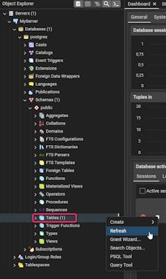

After creating the table from Node-RED, you need to refresh the table list as shown in the following picture.Ā
Right click on tables and refresh the list
