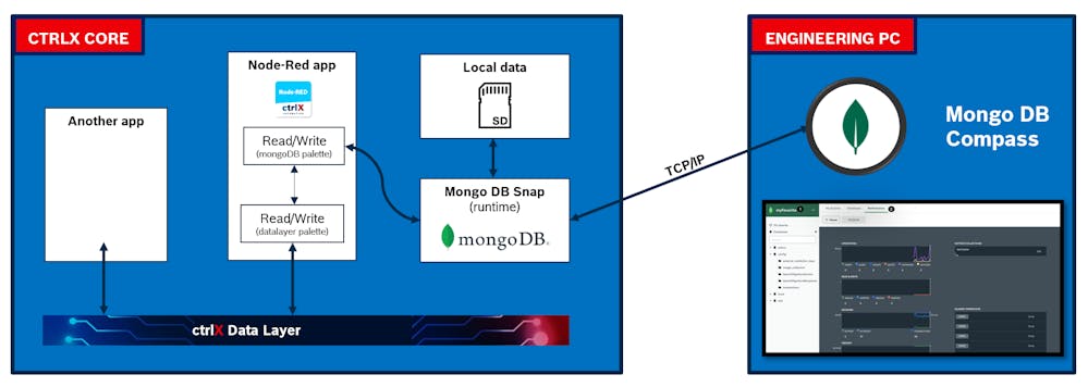

In the following picture you can see what the system structure looks like:
System overview
This project targets the current generation ctrlX COREvirtual, ctrlX CORE X5, ctrlX CORE X7, and ctrlX OS on a IPC when running ctrlX OS 2.xx (base apps running an ubuntu core 22). This application is (and will be) only supported for amd64 architectures as explained in the attached .zip.Ā Therefore, Mongo DB 7.0 cannot be ported to the current generation of ctrlX CORE X3 with aĀ 4 Bit Quad-Core ARM CPU, in particular with arm64:v8.0.

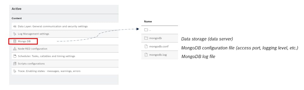

If the MongoDB runtime was successfully installed in your CORE. You will find a folder called "Mongo DB" in the persistent data, i.e. "Manage app data" section.Ā
Files in persistent data
Inside you will find three items:
  • mongodb: the actual data server where the data is stored. In this example the data is stored locally in the CORE, however this can be easily changed as we later will see.
  • mongodb.conf: config file for the Mongo DB runtime. You can download the app data (appdata.zip), modify this file and upload it again to the CORE. By doing this, one can change the configuration of Mongo DB.
  • mongodb.log: log messages about the state of the Mongo DB runtime.

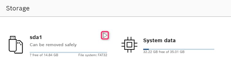

Plug the device in the ctrlX CORE and navigate to the storage page (Settings>Storage). You should see the external media device together with the local "System Data".
Storage in ctrlX OS

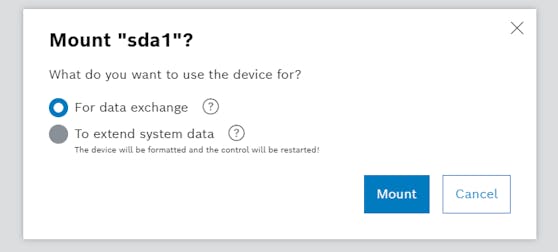

The click on the triangule on the right upper corner of the external media to mount the filesystem. You will prompted with the following.
Mounting the filesystem
Select "For data exchange" if you do not want to encrypt the data, i.e. it could be eventually read from outside (e.g. another ctrlX CORE), otherwise, if you want this ctrlX CORE to be the only one able to read the data, select "To extend system data".
After this step, the external media is ready to be accessed by the different snaps. Actually, for a snap to have access to the external media device, it must include the "removable-media" plug (see the snapcraft.yalm file for more details). Although this plug is not generally connected in a snap, in the case of ctrlX OS, it is connected, so no further steps are necessary.

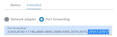

Connect the Engineering PC and the CORE in the same network. If you are using ctrlX COREvirtual, do not forget to forward port in which the runtime is accessible (27017).
Port fowarding for ctrlX COREvirtual

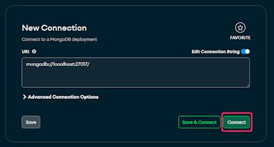

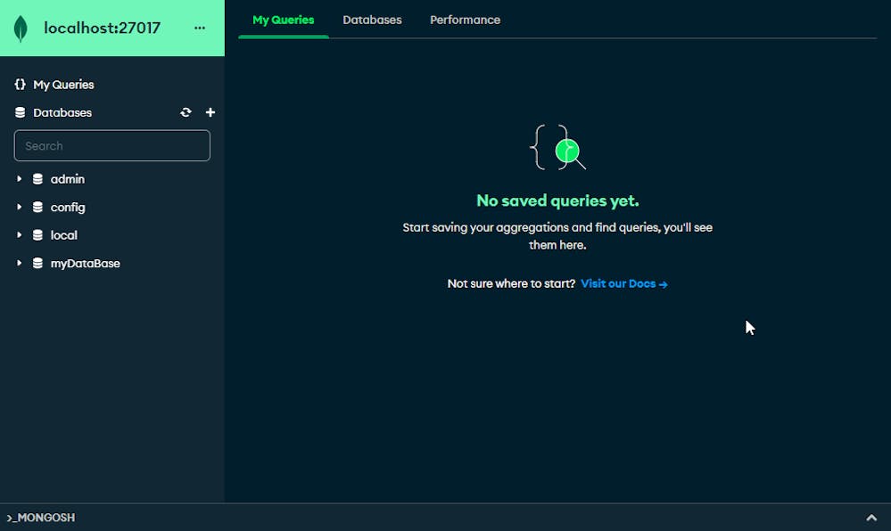

Open Compass and check your connection string.
Connection string in Compass
In our case the ctrlX CORE virtual, the IP address is localhost (127.0.0.1), and the port is the default one. If you are using a real ctrlX CORE, the IP address is 192.168.1.1. by default. Adapt it depending on your setup. There is no user/password to access the data base by default.

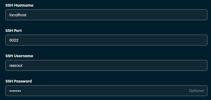

If the connection does not work, in some cases the connection to that IP is protected. You can try with SSH connection with password (open advanced Options) if you have that feature enabled in your device (in virtual it is enabled by default). Probably you will not need SSH again, only the first time. New updates of this How-to will address this issue.
SSH connection details
If you are able to connect, you are able to visualize your data. It should look like this:

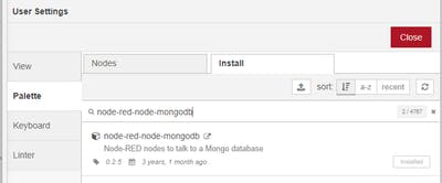

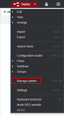

There exists a Node-RED palette to communicate with Mongo DB. You can download it as seen in the following images. The CORE must be connected to the internet.
Add new palettes

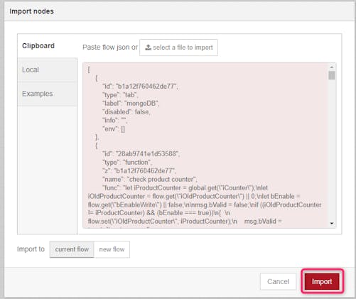

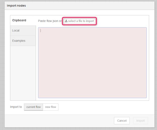

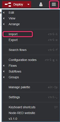

We have prepared some examples to publish to the data base from Node-RED. Find them attached to this How-to (flows_mongoDB.zip). To import it, open the "Flow Editor" from Node-RED and proceed as shown in the following pictures:
Import example
Select the .json file
Example json loaded
You must import both flows (.json) in that .zip:

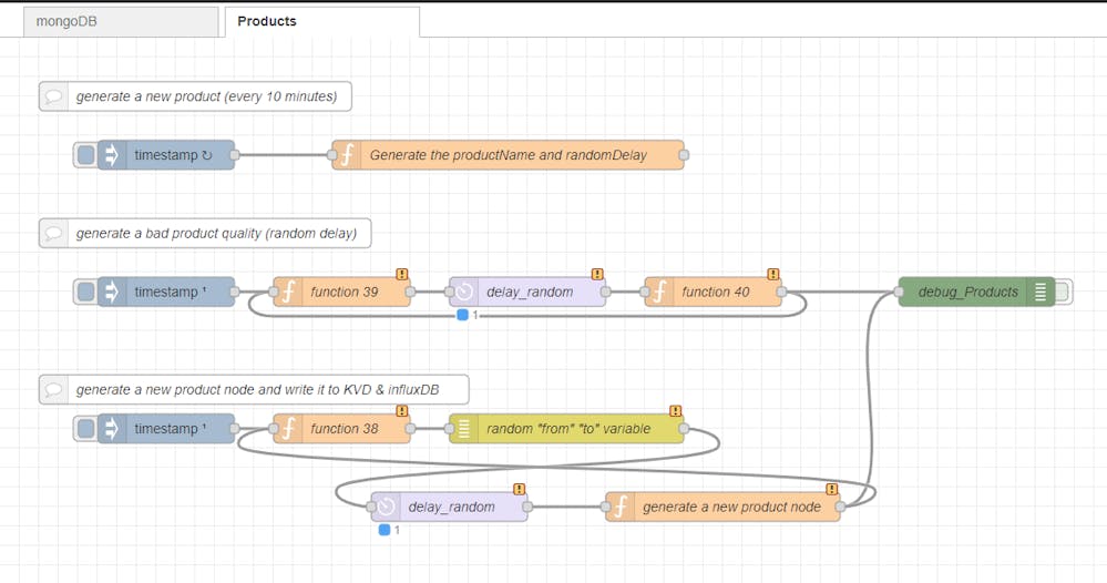

  • Products: Working in the background, you do not need to interact with this. It simulates a product object that would be later publish to the database.
Product object generation
  • mongoDB: It allows you to publish cyclical a product object. Likewise, we have setup a functionality to read objects from the database.
Node RED example

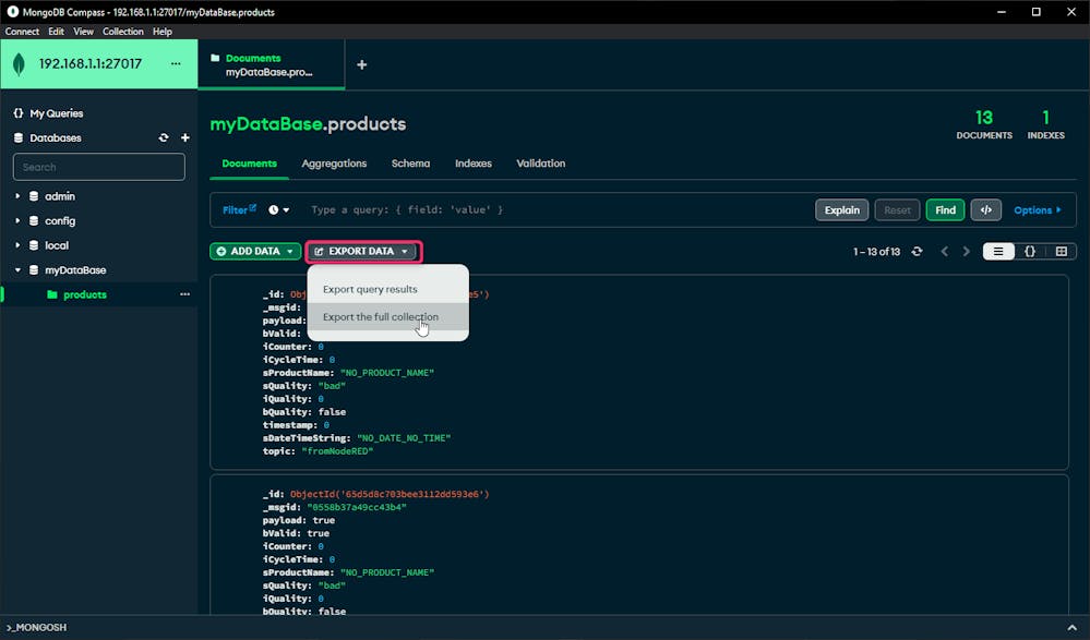

Once you have published something, you can go to Compass, refresh it, and see they data you published.Ā
You can also export the data in a csv or json object, following what is shown in the next picture:
Export data from Compass
