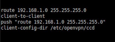

There are many ways to setup an openvpn server, there are online several guides online such as this . Here i am displaying the additional setups needed on a bare openvpn server starting from the linked guide. We two certificates: one for the ctrlX CORE, the other one for the PC we would like to use to connect with the XM controller. What we need to add inside the server configuration file,usually placed in "/etc/openvpn/server/server.conf" are the following rules. (considering that the ctrlx LAN is in 192.168.1.x rage).

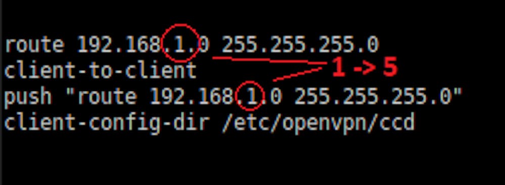

Fig. 2.: Server.conf additional rules.
Syntetically:
  • with "client-to-client" we are telling the server that a client can connect directly to another client
  • "route 192.168.1.0 255.255.255.0" tells to the server that he must be able to be the router for that subnet otherwise we would direct the traffic to its default gateway
  • push "route 192.168.1.0 255.255.255.0" is tellingo to the server to push this rule to all the clients that connects to the server. Basically you don't need more to add the routing rule to the clients, they will look at the vpn server when they need the subnet 192.168.1.x. (step 3 previous guide)
  • client-config-dir: we are specifying a folder that the server will use to collect client specific configurations.

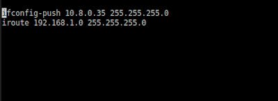

Fig. 4.: CCD file content.
"ifconfig-push .." is setting the VPN address client-side as 10.8.0.35 while "iroute 192.168.1.0 255.255.255.0" is setting this client as the gateway for the 192.168.1.x subnet.

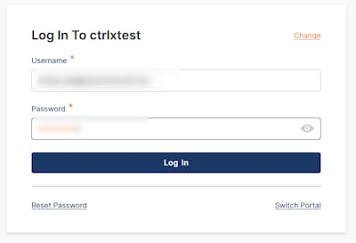

Enter the "xxxxx.openvpn.com" URL, which you have chosen during the account creation and chose Admin Portal to configure your OpenVPN server. Login with your credentials.
Fig. 5.: VPN service login.

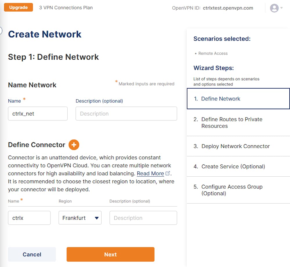

Now first a network has to be configured. For this click on "Networks". OpenVPN leads us through the configuration of the network with a wizard. Select "Remote Access", as we want to access the network behind the ctrlX CORE from other VPN clients. Now enter the following information in the according steps:
  1. Enter a name for the network and a name for the device which is used as "connector" to the network. In our case this means the ctrlX CORE. Also select the location closest to you. From Germany e.g. Frankfurt. Click "Next".

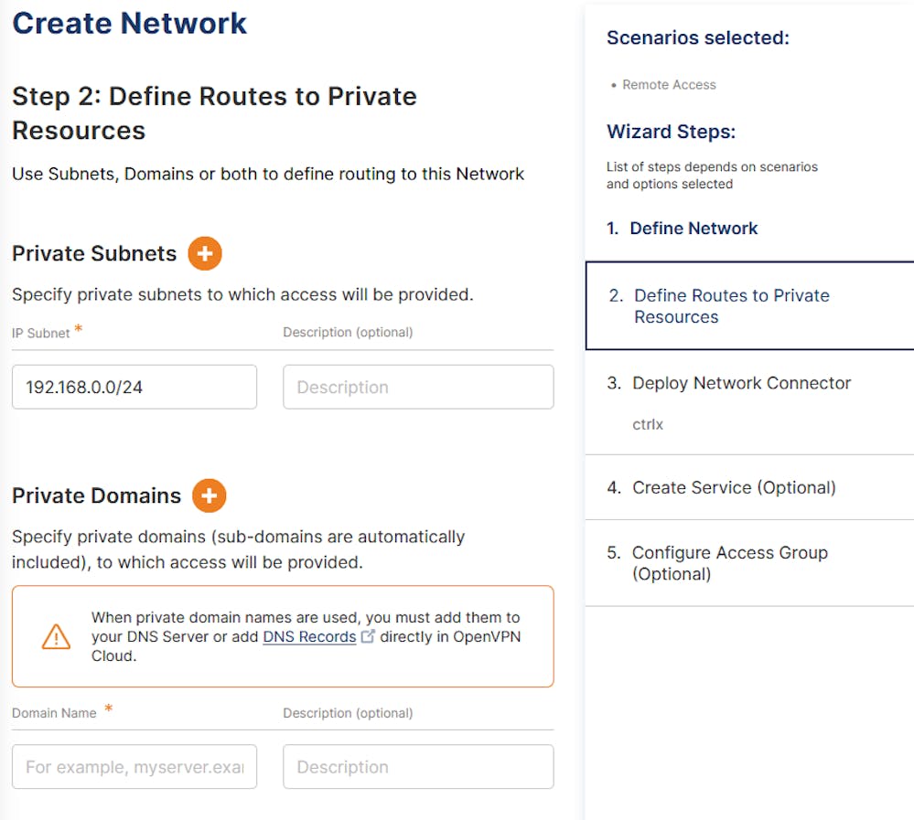

  2. In this step the subnets which should be accessible behind the ctrlX CORE have to be defined. In our example this is the subnet 192.168.0.0/24. You have also the option to define more than one subnet (if you e.g., use both network ports of the ctrlX CORE). Click "Next".

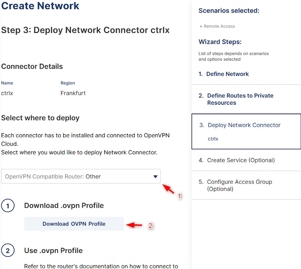

  3. Multiple options where the network connector should be deployed are offered. Select "OpenVPN Compatible Router". Afterwards click on "Download OVPN Profile" to download the profile, which will afterwards uploaded to the ctrlX CORE. Do not click on "Next" yet.
Fig. 6-7-8-9.: Web-Based OpenVPN server setup.

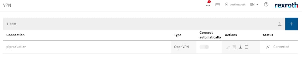

Once we do have the .ovpn file we're ready to rock the ctrlX OS app. Pleas take in account that the VPN connection page can be in a different place and its layout can change depending by the system and app version. One that ctrlX CORE has internet access we need to upload the configuration and enable the "Connect automatically" option in case we need the system connected with the VPN at each boot.
Fig. 10.: OpenVPN client app overview.

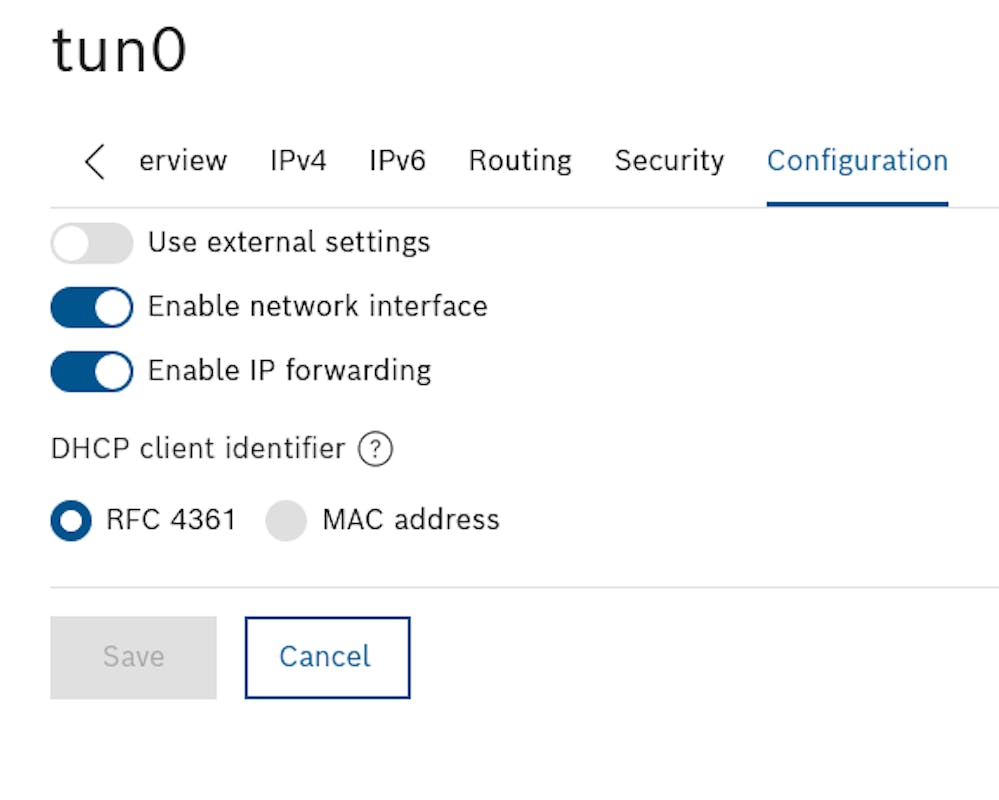

In order to forward data packets, it is necessary to allow it from the eth0 and tun0 interfaces:
Open Ipforward
Fig. 11.: Eth0 IP forward.
Fig. 12.: tun0 IP forward.

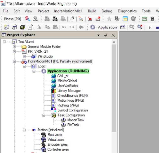

Now even IndraEorks should be able to program the XM22 passing through ctrlX CORE.
XM access
Fig. 15.: XM22 programming

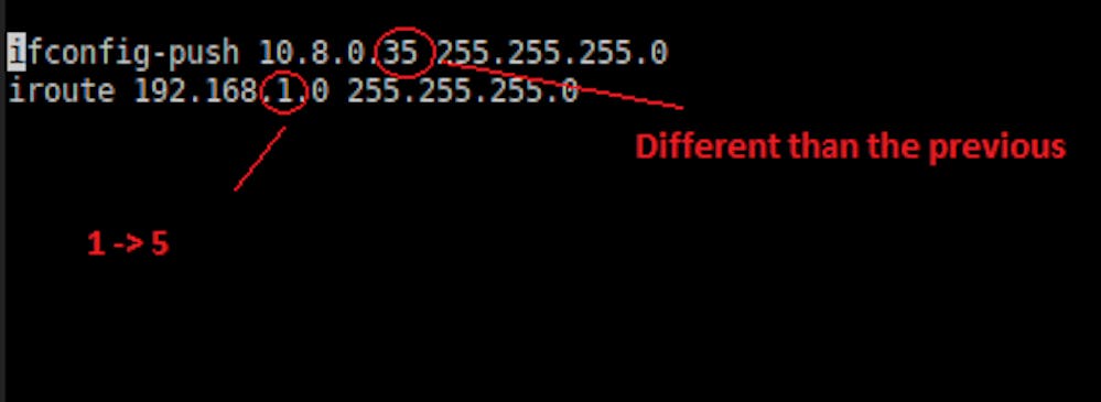

The option 1 is definitely really clear, the second also. The option number 3 is what is interesting to us now but we need to go back to step 1a. We have to create another client .ovpn and then replicate all the rules inserted in 1a containing 192.168.1.0 with the address 192.168.5.0 instead. Obviously also the new "ifconfig-push" address should be different (otherwise we would have two VPN clients with the same address). The eth0 interface and the XM22 interface addresses are still 192.168.1.1 and 192.168.1.25. We're not going to change them.
Fig. 16.: Route reminder
Fig. 17.: iRoute reminder

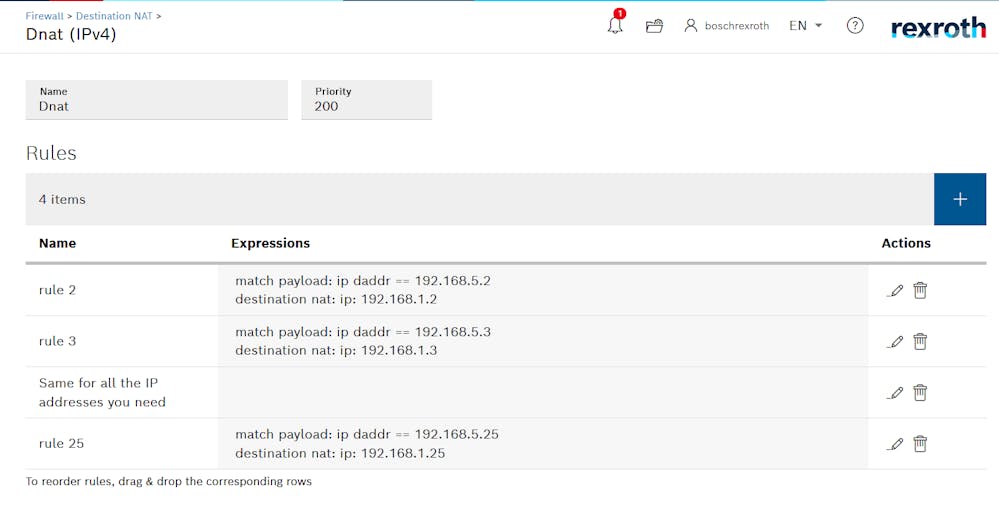

Reboot the server and reconnect all, now if we try to reach the 192.168.5.x address the VPN server tries to send us to the new VPN client but the the connection is not successful because ctrlX CORE has no device in such subnet. What we need now is a DNAT.

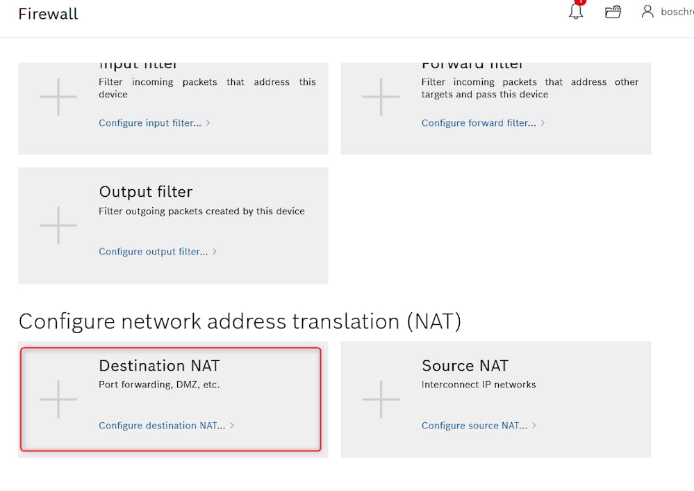

We want to translate 192.168.5.X to 192.168.1.X inside ctrlX CORE. We need a rule for any device in the LAN we want to reach! To insert a rule the Firewall part we need to use is remarked in figures18-19. An example of Dnat rules is then exposed by figure 20. The postman collection contains already a script to create a DNAT rule for any device in the subnet.
 Fig. 18.: Firewall overview
 Fig. 19.:Dnat location
 Fig. 20.:Dnat rule(S)

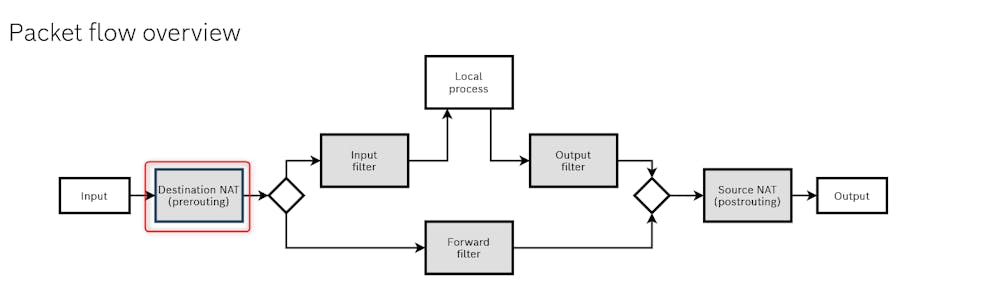

The packets we exchange are something very close to what is represented in the picture below:
My packet
 Fig. 21.: Data Packet
The image is just indicative, what is important to us is that our packet has:
  • A destination address (where the packet should arrive)
  • A source address (who is sending the packet)
  • A payload (the data exchanged)
The packet takes 3 main steps to get to destination and 3 also to get back.
packet Flow
 Fig. 22.: ctrlX CORE Firewall structure
Setting the routing rules on our PC in step 3 we're able to send packets destined for 192.168.1.25 to ctrlX CORE. Here is where the trick is starting.
Once the packets are inside the ctrlX CORE we can do many things, first of all we could change the destination IP applying a Destination NAT  (Number 1 in Fig.8 ) here is where the Destination IP translation happens, the packets destinated to 192.168.5.x are translated and redirected to 192.168.1.x. How? the DNAT part changes in the packet the destination address setting up his corrispective in the ctrlX CORE LAN. We also must be sure that the packets are not being filtered!! To do that the step number 1 of the guide is mandatory, also it is good to check inside the "Forward Filter" part of the firewall that there are no other rules that may block the packets. The last part is the most important, before to exit from ctrlX CORE the packets are passing trough a SNAT (Source SNAT: number 3 in Fig.8 ). In this last step the source address of the packet that, till now, is something like 10.8.0.x is then converted in 192.168.1.1 which is the ctrlX COREaddress of the interfaces that is connected to the XM22. Why that? because once the XM22 receives the packet and answers it already knows that the one who sent him the packt was the ctrlX and answers directly to him (otherwise we would have to set the gatway address). The rules to setup this last part are explained in step 2.
The packets that have to come back from the xm22 to the pc are automatically translated by ctrlX CORE itself on they way back.
