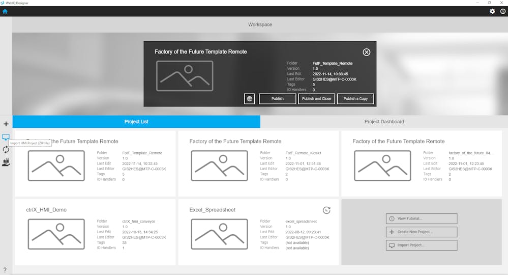

Step 2: Install WebIQ App
Install the WebIQ application attached at the bottom of this article through the WebIQ Designer.

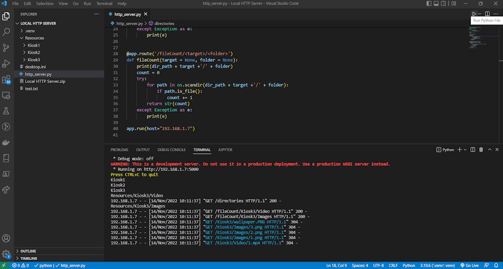

Step 3: Run Python HTTP Server
The HTTP server code is attached at the bottom of this article. This can be run in a variety of ways, including as a system service on Linux machines or from VS Code as shown below. Update line 40 with the IP address of the machine running the server. At this point, resources can be placed in the /Resources folder to be served to the WebIQ application.
At this point, the WebIQ application should be capable of loading assets from the Python server.
