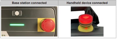

  3. Confirm with Yes. The secure connection is established. You can tell the connection has been established successfully by the illumination status of the LED bar of the base station and the emergency stop of the handheld device. This must be verified using a visual inspection.

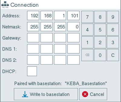

Step 1.2 - Setup IP address
The device configuration can be started from the desktop by double clicking on the icon "DeviceConfig". Then press on "Network", "Base station connection". Pressing "Connection" takes you to the configuration window for base station network settings. The network address can either be obtained automatically via DHCP or configured manually.
Set the IP address to 192.168.1.101 and confirm with "OK".
KeTop T15xWL Network
Write to base station transfers the settings to the base station and switches back to the previous window. Cancel leaves the window without saving the changed settings.
For details see Chapter 6.3.5: (Configuration -> Device Configuration (Device Config) -> Network -> Base station connection -> Connection)

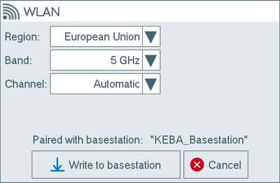

Step 1.3 - Setup WLAN to 5 GHz
Pressing WLAN ("DeviceConfig" --> "Network" --> "Basestation connection") takes you to the configuration window of the generated WLAN between the base station and handheld device.
For this WLAN, the channel and the wireless band can be selected, all other WLAN parameters are defined automatically by the base station and shared with the handheld device (This is a recommended setting).
KeTop T15x Wifi
For details see Chapter 6.3.5: (Configuration -> Device Configuration (Device Config) -> Network -> Base station connection -> WLAN)

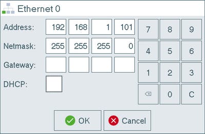

Step 2.1 - Setup IP address
The device configuration can be started from the desktop by double clicking on the icon "DeviceConfig". Then press on "Network". Pressing "Ethernet 0" switches to the configuration window. Configuration functions in the same way for all Ethernet interfaces. The network address can either be obtained automatically via DHCP or configured manually:
KeTop T15x Network
For details see Chapter 7.1.4: Configuration -> Device Configuration (Device Config) -> Network

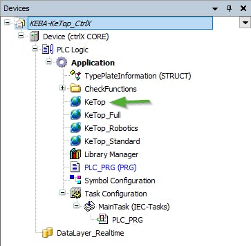

Step 9 - Create PLC Project and share variables
Now, a PLC project must be created which shares variables to the datalayer. For this purpose our template project can be used. It is important to remind that the KeTop handheld terminals are equipped with different keyboard layouts. Various layouts are shown in the template project. Copy the complete declaration code from the variable list with the corresponding keyboard you have and paste it into the GVL "KeTop" (Important: The GVL must be named "KeTop". Don't rename it!!). Afterwards, the variables must be shared in the symbol configuration. Login and download the project to the controller. Do not forget to create a boot application.
If your device/keyboard layout is not listed as a template, you can use the "Full" template.
See attached file: KEBA-KeTop_CtrlX.zip [Download]
Rename the GVL Template to "KeTop" or copy the declaration code into the GVL "KeTop"
KEBA KeTop CtrlX

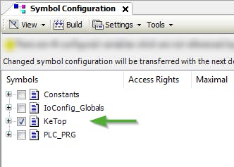

Share variables in symbol configuration by selecting KeTop node (If there is no "KeTop" node, press the Build button):
Symbol configuration

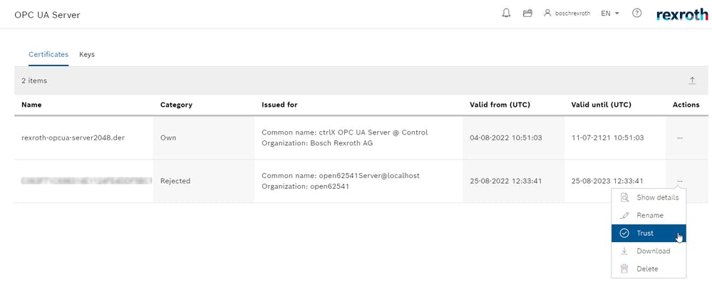

Step 10 - Trust the certificate
As one of the last steps, you need to trust the certificate which is now listet in "Settings -> Certificates & Keys -> OPC UA Server". The new certificate is currently rejected. Click on "..." and then "Trust"
Trust Certificate
