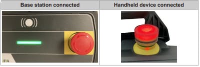

After you Start-up KeTop you have to establish a secure connection ("pairing"), proceed as follows:
  1. Hold the handheld device up to the desired base station (max. distance 2 cm).
  2. When the base station is recognized, the device vibrates and a dialog opens automatically showing the serial number or name of the base station.
  3. Confirm with Yes. The secure connection is established. You can tell the connection has been established successfully by the illumination status of the LED bar of the base station and the emergency stop of the handheld device. This must be verified using a visual inspection.
Base station
Base station
Depending on which configuration is set, the handheld device connects automatically to the base station or hall network for functional data exchange. After the work is finished, the secure connection must be released by means of "unpairing".

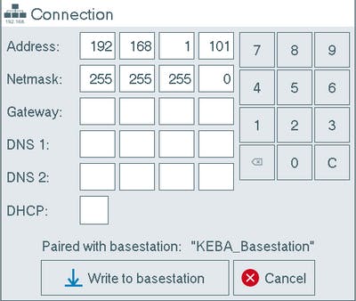

Step 1.2 - Setup IP address
The device configuration can be started from the desktop by double clicking on the icon "DeviceConfig". Then press on "Network", "Base station connection". Pressing "Connection" takes you to the configuration window for base station network settings. The network address can either be obtained automatically via DHCP or configured manually.
Set the IP address to 192.168.1.101 and confirm with "OK".
KeTop T15xWL Network
Write to base station transfers the settings to the base station and switches back to the previous window. Cancel leaves the window without saving the changed settings.
For details see Chapter 6.3.5: (Configuration -> Device Configuration (Device Config) -> Network -> Base station connection -> Connection)

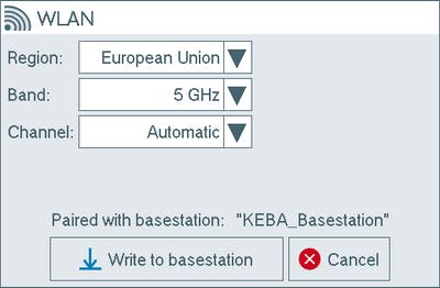

Step 1.3 - Setup WLAN to 5 GHz
Pressing WLAN ("DeviceConfig" --> "Network" --> "Basestation connection") takes you to the configuration window of the generated WLAN between the base station and handheld device.
For this WLAN, the channel and the wireless band can be selected, all other WLAN parameters are defined automatically by the base station and shared with the handheld device (This is a recommended setting).
KeTop T15x Wifi
For details see Chapter 6.3.5: (Configuration -> Device Configuration (Device Config) -> Network -> Base station connection -> WLAN)

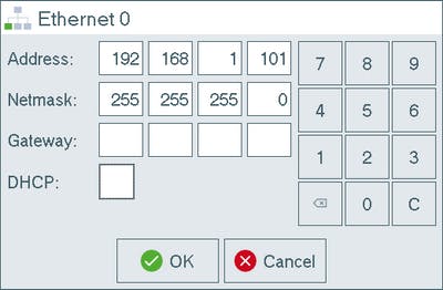

Step 2.1 - Setup IP address
The device configuration can be started from the desktop by double clicking on the icon "DeviceConfig". Then press on "Network". Pressing "Ethernet 0" switches to the configuration window. Configuration functions in the same way for all Ethernet interfaces. The network address can either be obtained automatically via DHCP or configured manually:
KeTop T15x Network
For details see Chapter 7.1.4: Configuration -> Device Configuration (Device Config) -> Network

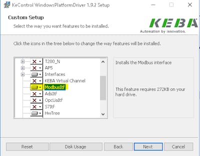

Step 3 -Install the ModbusTCP Platform Driver
Modbus TCP interface must be installed on the handheld terminal. The installation takes place in the WindowsPlatformDriverSetup. The WindowsPlattformDriverSetup can be found under „Programs and Features“ gefunden werden. Only one interface should be used at a time.
KeTop Tx Driver ModbusTCP

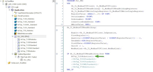

Step 7 - Create a PLC Project
Now, a PLC project must be created which reads the ModbusTCP registers. For this purpose our template project can be used. It is important to remind that the KeTop handheld terminals are equipped with different keyboard layouts. Various layouts are shown in the template project as GVL files.  Within the "PLC_PRG(PRG)" there are some "Actions" named after the used KeTop. Just uncomment the appropriate action. Within the "Actions" the read registers are mapped to the variables of the GVL file.
Do not forget to create a boot application.
See attached file: KEBA-KeTop_CtrlX.zip [Download]
KeTop - CtrlX Application
For general information see following How-To
Step 8 - Check connection
You can check now the variables in the PLC Project when you are online and in the appropriate action. As easiest you see the working connection when "Alive" variable is incrementing every 1 second. Every other variables you see a change when manipulating the buttons.
