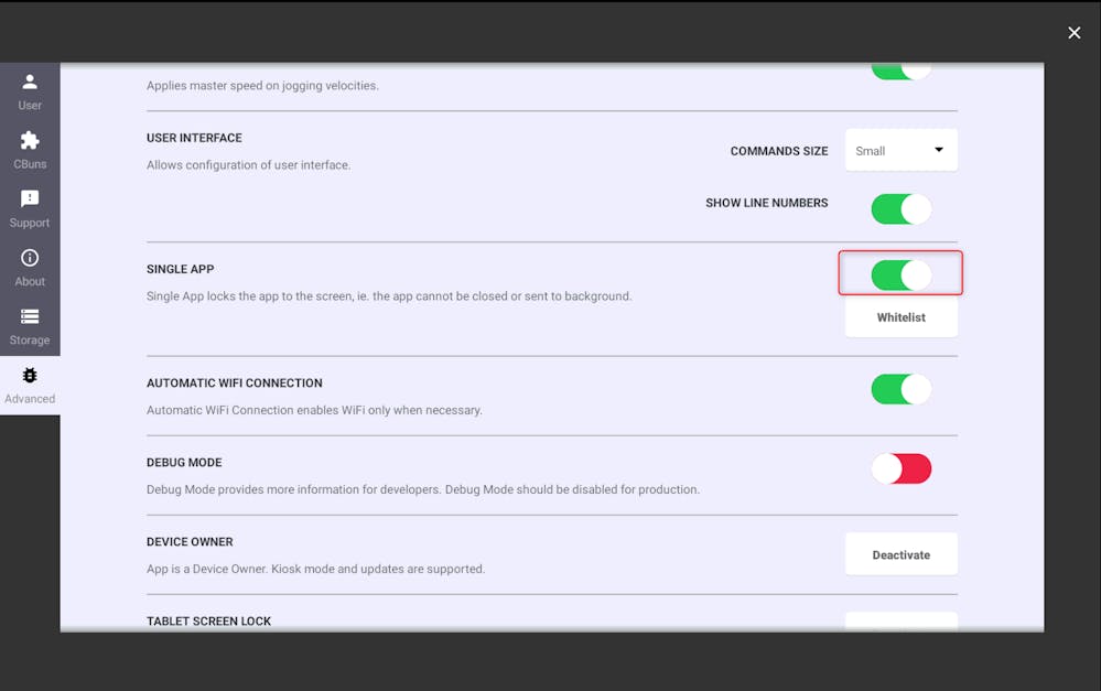

To do so, access the advanced settings as shown in the following picture:
Access advanced settings
Then scroll down until you find the ¨Single App¨ option, then turn it off.
Turn off single app mode

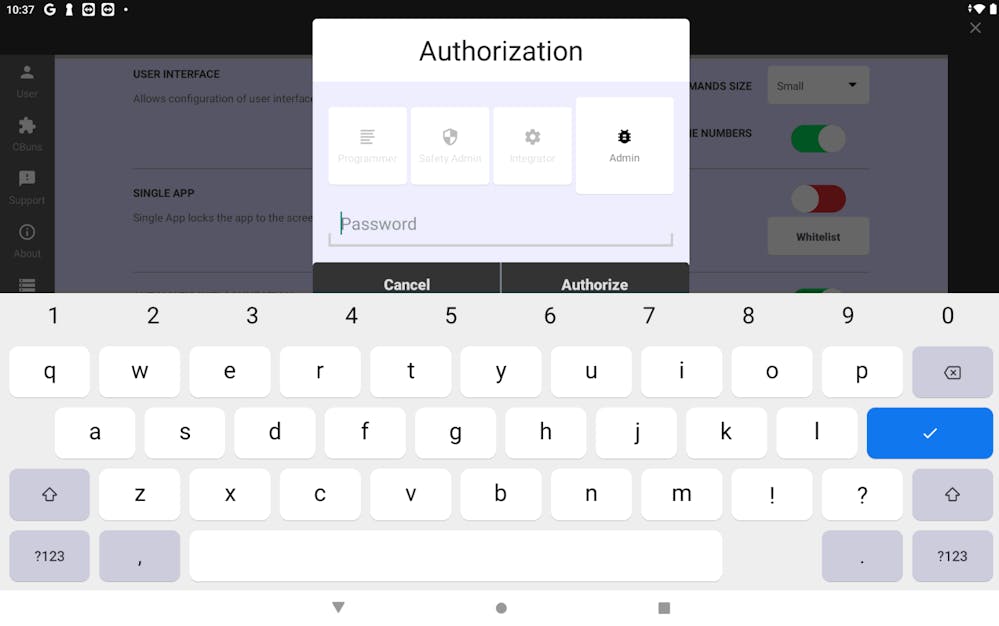

You need to be "admin" for this operation, have a look at the Documentation or contact our support team ([email protected]) if you are not sure what does it mean.
Authorize the operation

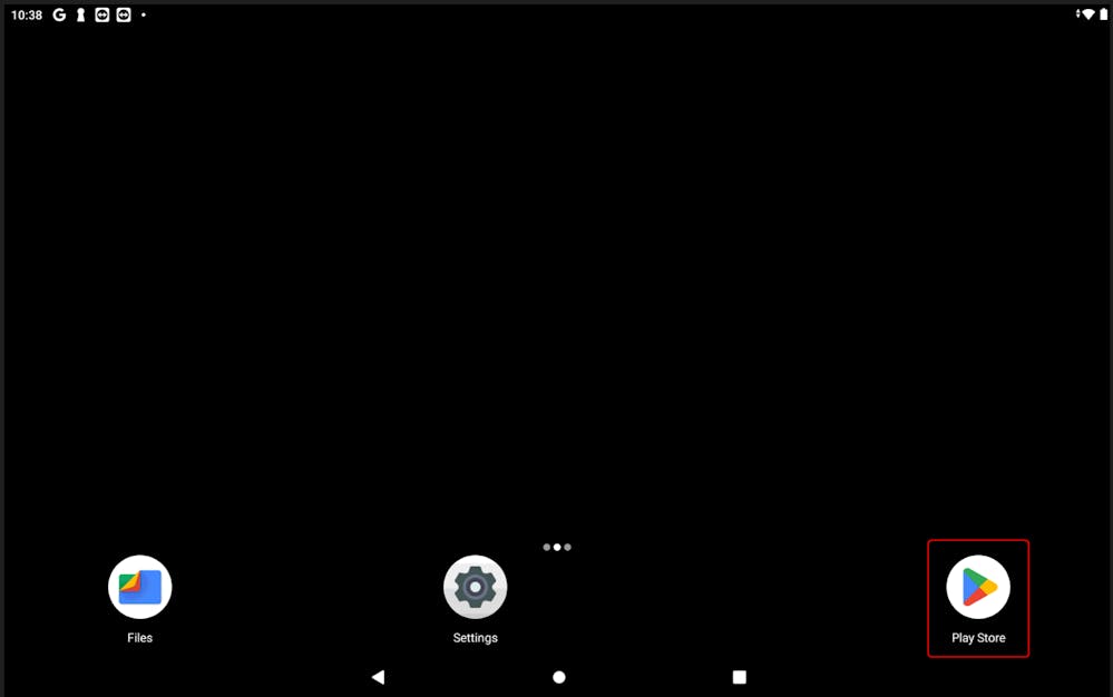

1.2. Connect to WiFi and go to the PlayStore
Once the Single App mode is disabled, if you do the gesture of launching from the bottom of the screen, the classic android bottom bar will appear (see next image). Simply click the circle and you will be sent to the Home.
Go to the Home Screen
Once you are in the system, go to the Android Settings and connect to WiFi.
Next, simply open the PlayStore.
Open the PlayStore

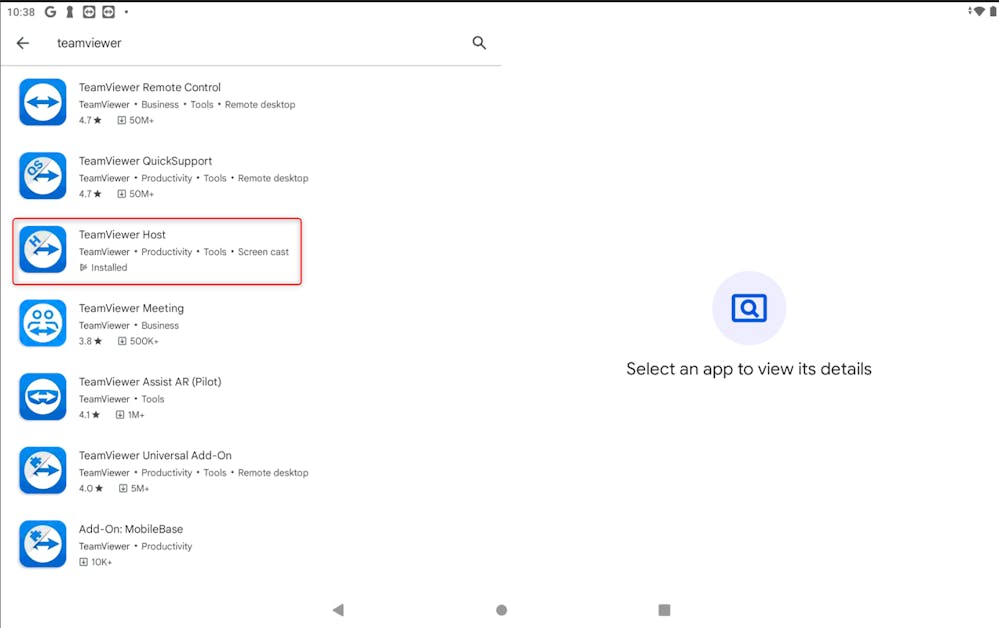

1.3. Install TeamViewer Host
Now search for the TeamViewer Host application and install it.
Search for TeamViewer Host application
Once the app is installed, open it. It might ask you to install a extension for your specific table model, go ahead with it.

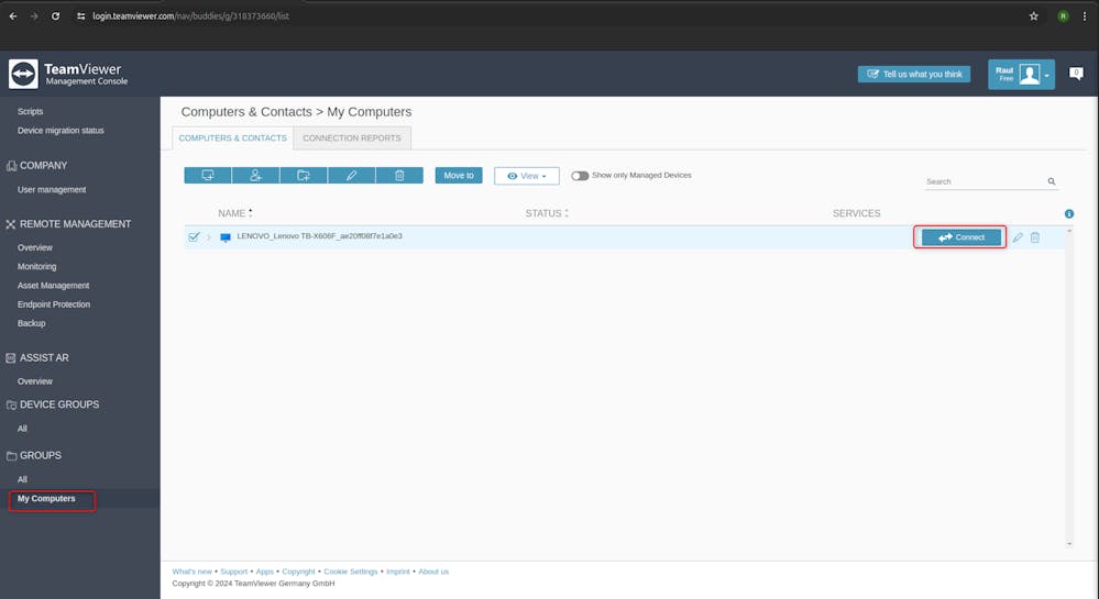

Go to www.teamviewer.com and login in the account you logged in in the TP.
Next click on ¨My Computers¨ on the right hand menu. You should see the Teach Pendant there, simply click ¨Connect¨.

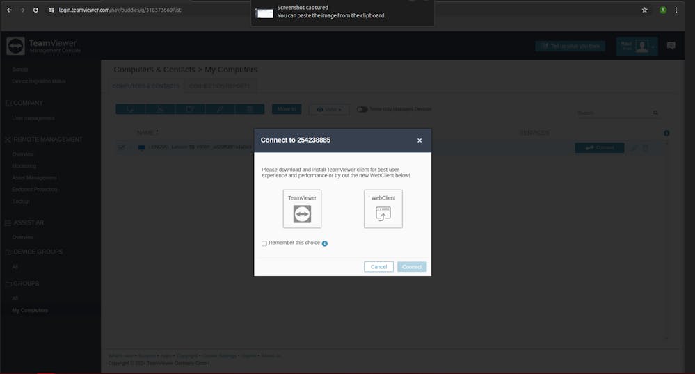

Select ¨WebClient¨.
WebClient selection
The connection will be configure and the TP screen will be displayed on the webbrowser.

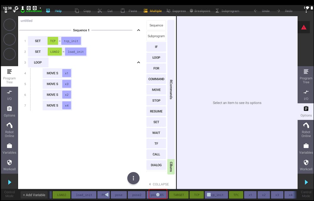

Now you can navigate back to the ¨Boson¨ app, and the KR GUI will be displayed.
