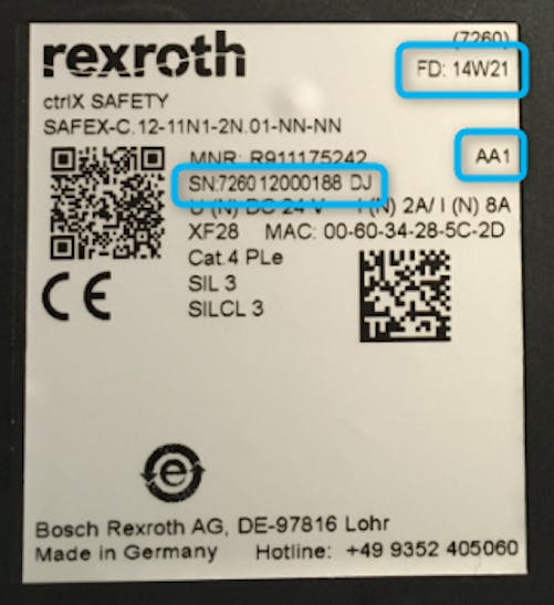

 Online electronic type shield:
  • < enter “System Info” screenshot here >
Hardware-Type plate information:
  • Production Date  FD:   < 00w21 >
  • Change-Index:              < A_1 >
New requested Firmware:
  • FW version:         < 1.0.0.5 >
  • FPGA version:     < 19 >

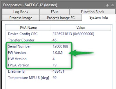

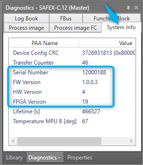

Find the current “FW version” and “FPGA version” online within the ctrlX SAFETY Engineering “Diagnostics” register “System Info”:
Fig. 3.: Electronic type shield SAFEX-C.12 – information for key-file ordering
The manufacturing date and HW-Index you find on the type plate.
Fig. 4.: Electronic type shield SAFEX-C.12 – Information for key-file ordering

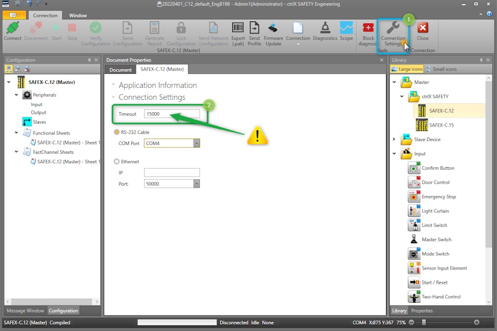

  • Before you connect to the ctrlX SAFETY, change the Timeout setting from default 5000 to 15000 – 15s!
  • This is necessary for memory copy processes during the update mainly with the FPGA update.
Fig. 5.: Firmware Update – Engineering Setting

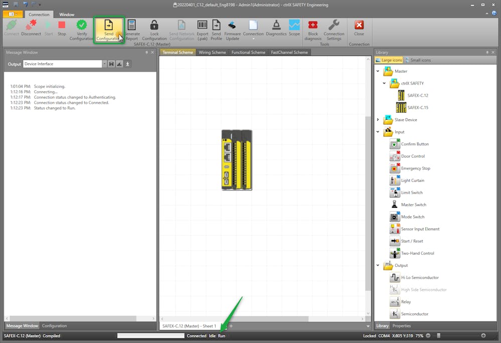

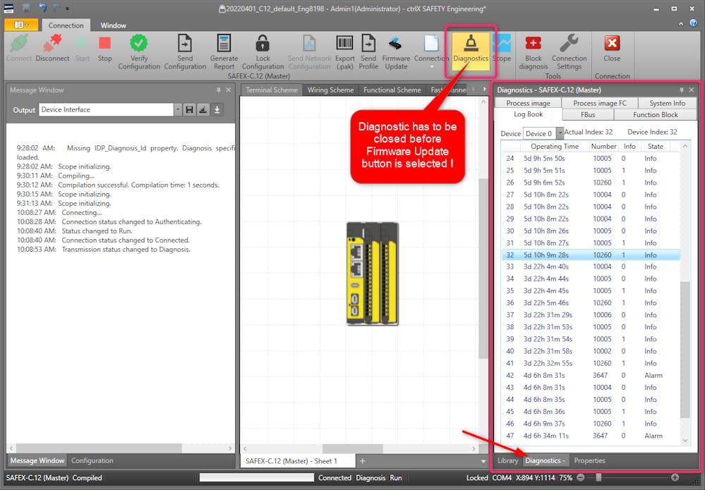

Now select the button “Connect” in order to go online with the ctrlX SAFETY, which has to be updated.
Attention!
With the latest ctrlX SAFETY Engineering, the selection of the Firmware update button is not blocked, if the Diagnostics is open and running.
The update will not work when “Diagnostics” is communicating from the PC to the ctrlX SAFETY.
(BLM Error 2 appears!)
Fig. 6.: Firmware Update – Stop “Diagnostics” before

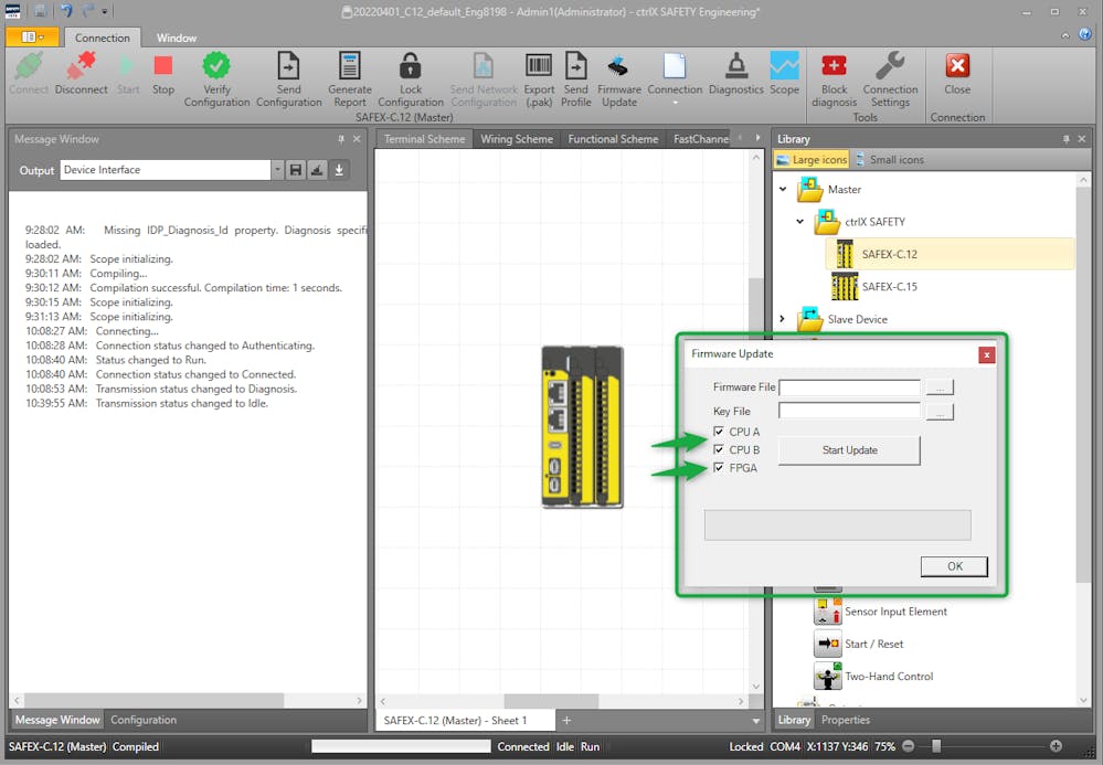

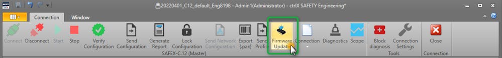

During online connection, the firmware update may be started with the “Firmware Update” button in the online menu band.
Do not forget to switch off your “Diagnostics” before.
Fig. 7.: ctrlX SAFETY Engineering menu band – online status
The “Firmware Update” control dialog for the file download appears modal.
Fig. 8.: ctrlX SAFETY Engineering – firmware update control dialogue
Select update steps and files
You may select the required Update Steps CPU-A + CPU-B (always together) and/or FPGA, dependent on your Key-file you have.
Select under “Firmware File” the firmware data file.
Select under “Key-file” the suitable key-file to your selection for update steps.

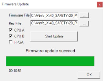

Fig. 9.: Example update - CPU-A + CPU-B, firmware and key-file selection

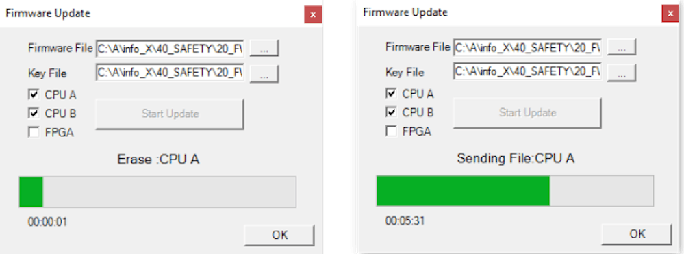

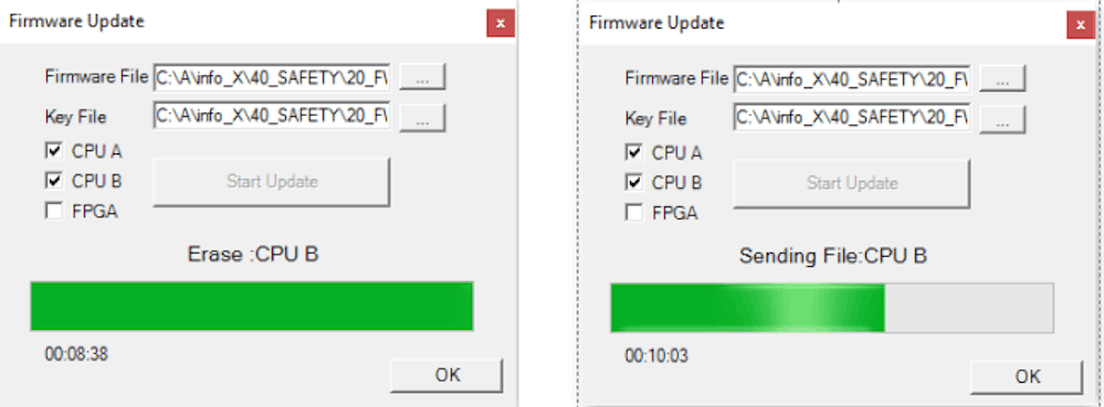

With selection “Start Update” the download process will start.
An abortion is not possible at the very moment– Mind to not select OK during file download!
The Firmware is switching to the download mode.

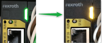

PF01 light pipe signaling download by blinking yellow
The light pipe PF01 at the SAFEX-C.1x is changing from green or green blinking at RUN mode to yellow blinking during the firmware download.
Fig. 10.: Firmware download – PF01 light pipe signaling yellow blinking
Fig. 11.: Firmware download Step 1 – Erases CPU-A and Downloads CPU-A
Fig. 12.: Firmware download Step 2 – Erases CPU-B and Downloads CPU-B
Fig. 13.: Firmware download Step 3 – Succeeded

Check the update success with the “Diagnostics” in the register “System Info”. Take a screenshot and send this to your local ctrlX SAFETY sales technician to get the feedback to DC-AE ctrlX AUTOMATION Support that the information is changed in the quality record of your SAFEX-C.1x control.
Fig. 15.: Firmware update CPU-A + CPU-B successful – feedback

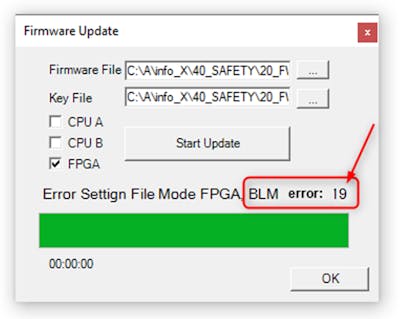

BLM error
There are several error messages possible during the firmware update.
Fig. 16.: Example of a BLM error during update
BLM error
description
0
possible with next try after a failed firmware update
SAFEX-C.1x has to be sent to Bosch Rexroth Service Lohr for repair (exchange)
2
“Diagnostics” ON during firmware update
15
key-file invalid (data in key-file not readable)
16
key-file invalid (Checksum in key-file not correct)
17
key-file does not fit to SAFEX-C.1x ID
18
key-file does not fit to serial number of SAFEX-C.1x
19
key-file does not fit to firmware running at SAFEX-C.1x
Download error
The update is starting but after CPU-A+CPU-B download during FPGA download after ca 21 minutes the following error appears:
Error sending FPGA File
--> Timeout is wrong (5000 instead of 15000)
3.4.2 Remedy in case of a failed firmware download
In case of an interrupted firmware download, firmware files are only partly downloaded.
Do not switch OFF the 24V power of your ctrlX SAFETY!
There is a possibility available to restart the download again.
In most cases the USB connection between ctrlX SAFETY Engineering PC and the SAFEX-C.1x was interrupted by e.g. the operating system of the PC.
However, the PF01 light pipe is still blinking yellow, which signals the download mode.
Follow the next steps to get the possibility to repeat the download:
  • Restart your ctrlX SAFETY Engineering.
  • Open your default project including the correct SAFEX-C.1x type control.
  • Select the “Device Interface” to switch the Engineering to “Online mode” menu.
  • Select the correct COM port and press the “Connect“ button to switch the ctrlX SAFETY Engineering after password entering to the SAFEX-C.1x.
  • Select the “START” button in the menu bar. (3rd from left).
    At this moment, the download modus is switched to RUN mode.
  • By selecting the “Firmware Update” button, you are able to restart the “Firmware Update control dialogue” again.

The ctrlX SAFETY gets the “Factory default settings” by downloading an empty project with only the SAFEX-C1.x control type on the working desk in the “Terminal Scheme” register.
Steps for factory default setting
  • Generate a new empty project with the ctrlX SAFETY control type.
  • Connect to SAFEX-C.1x.
  • Download the project by “send configuration”.
  • After download, the SAFEX-C.1x control is automatically booting into the RUN – Status present before the download.
  • The light pipe PF01 is signaling RUN by blinking green or solid green like present before the download.
Fig. 17.: Factory default setting – only ctrlX SAFETY type in the project
