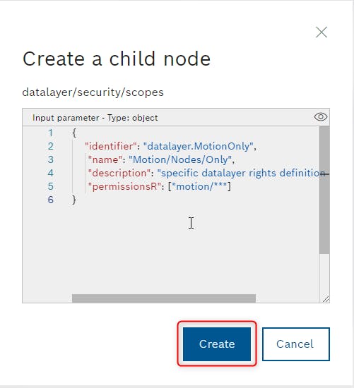

Go to the Data Layer and navigate to datalayer/security/scopes and click on Create:
Navigate to scopes in ctrlX Data Layer
Insert the user-defined scope, t.e.
    "identifier": "datalayer.MotionOnly",
     "name": "Motion/Nodes/Only",
     "description": "specific datalayer rights definition -> motion"
     "permissionsR": ["motion/**"]
And click on Create:

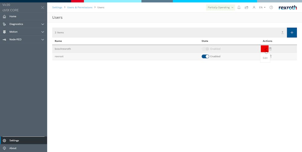

To change permission for a specific user go to  "Settings>Users & Permissions>Users" as shown in the picture below and click on the pencil-like icon "edit" for chosen user.
Navigate to change permissions for a user

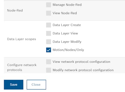

Now on the newly opened page, navigate to the individual permissions tab and scroll down to "Data Layer scopes" as shown in the picture below.
Set permission
Choose the defined permission and click on save.
Now from the next login of that user, changes will be applied and it will look something like the below image 🙂 .
