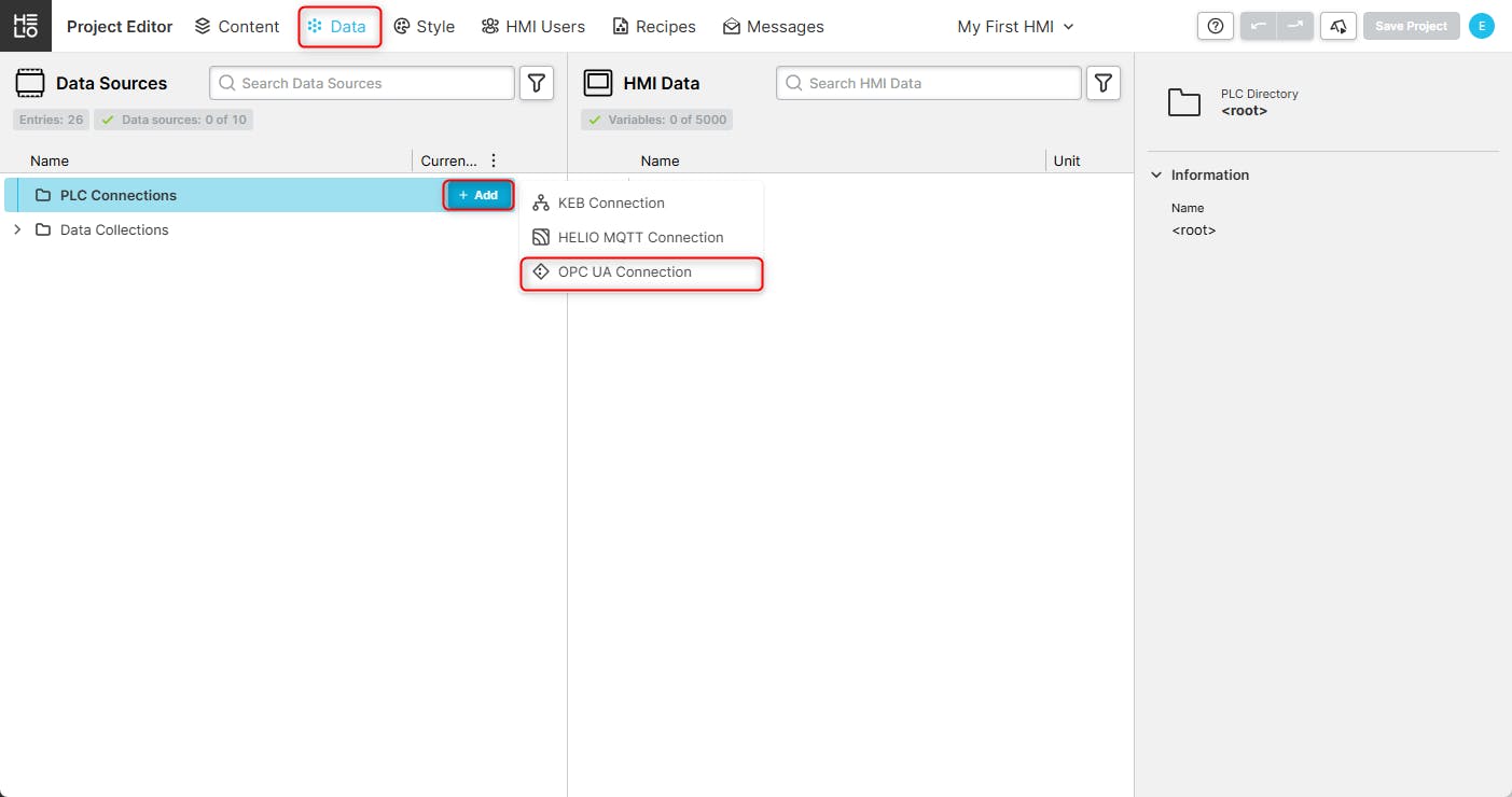

The next step is to log in to the HELIO app, create a new project or edit an existing one.
Then, switch to the Editorial view and navigate to the Data Source Explorer, where you will add an OPC UA connection.
Fig. 1.: Data Source Explorer

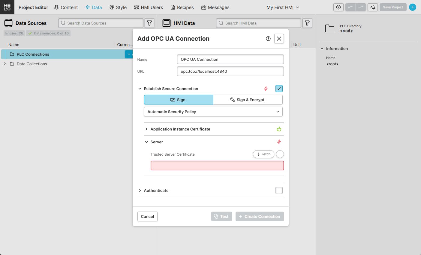

Now it's time to configure the connection. By default, the pop-up window appears as follows:
Fig. 2.: OPC UA Name and URL
You can choose any name for the OPC UA connection. For the URL, it’s recommended to use either the IP address or localhost (or 127.0.0.1) to work IP independent.
Using opc.tcp://ctrlX-CORE:4840 is not recommended with this version of HMI Project - HELIO app!
The OPC UA server prefers a secure connection. After checking the box, selecting Sign, and expanding the Server configuration, it should look like this:
Fig. 3.: Secure Connection
Step 3

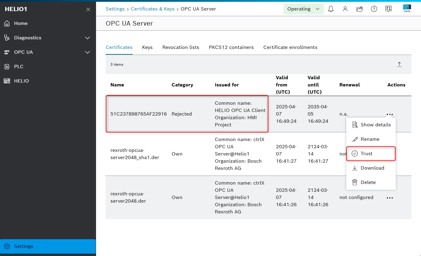

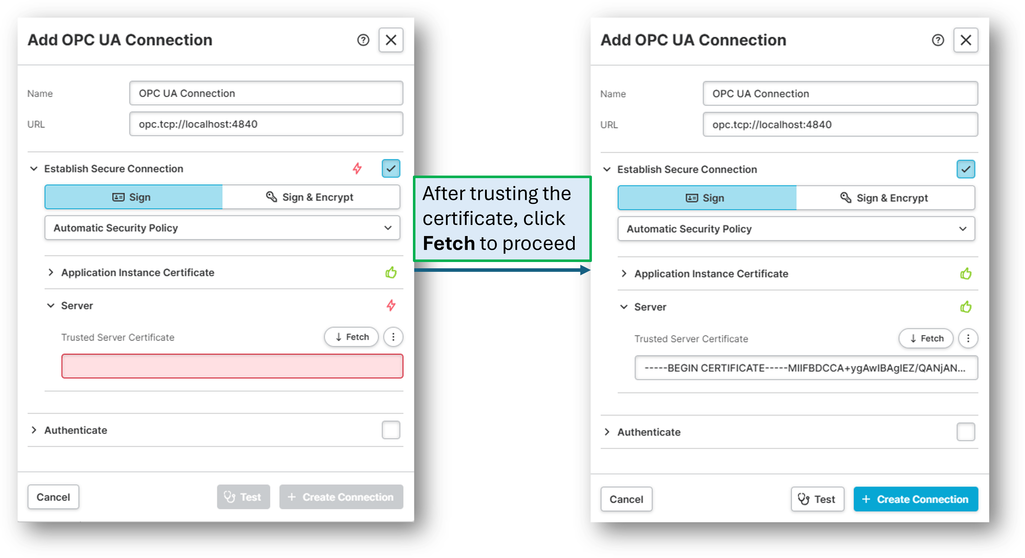

We need to establish trust between the OPC UA server and the client in HELIO. To do this, press button "Fetch" to trigger the certificate exchange. An error will be shown as certificates are not trusted at this point, that can be ignored.
Then go back to the ctrlX OS web UI β†’ Settings β†’ Certificates and Keys β†’ OPC UA Server and trust the certificate.
Fig. 4.: OPC UA Certificates
Now, when we return to HELIO:

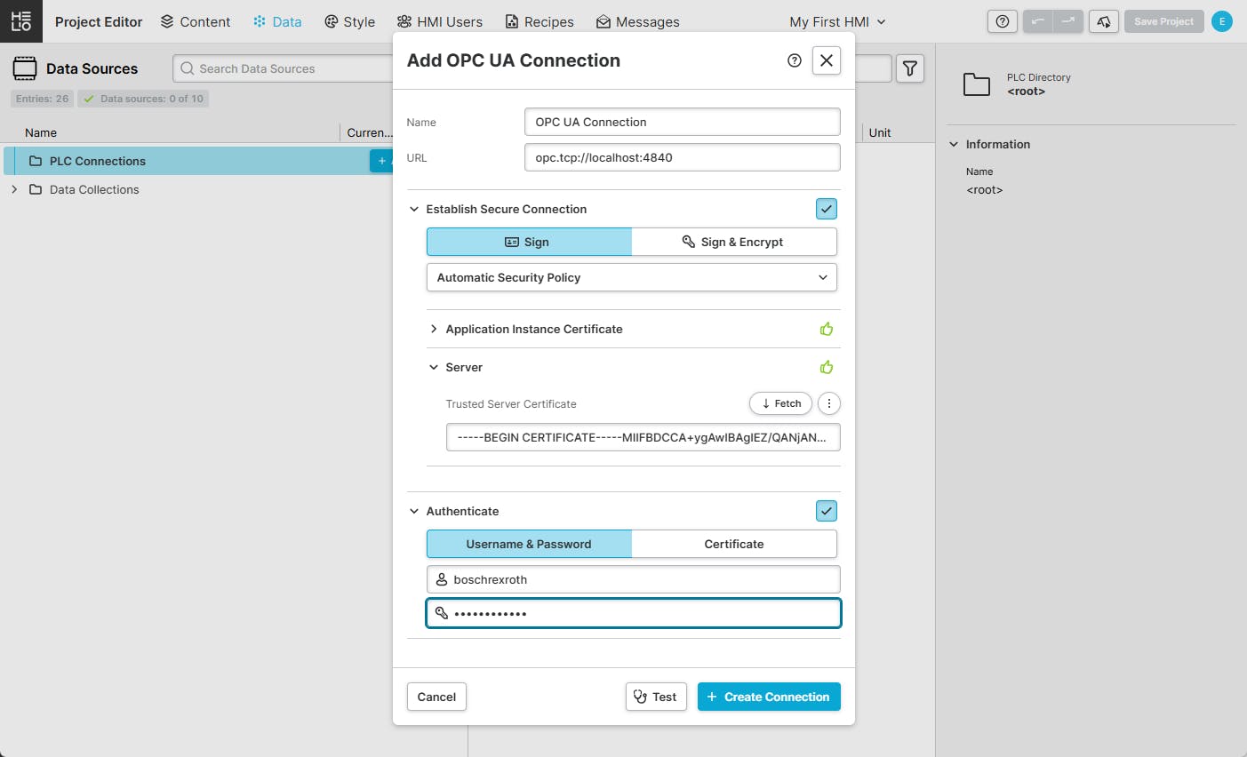

The final step is to ensure that HELIO uses the correct credentials to communicate with the server. By default, the server requires username and password authentication.
Enter the credentials for the ctrlX OS hosting the OPC UA server.
Fig. 5.: OPC UA User Credentials
By clicking the Test button, you can verify if the connection is working.
If no issues are detected, selecting Create Connection will establish the connection and add it to the PLC connection tree.

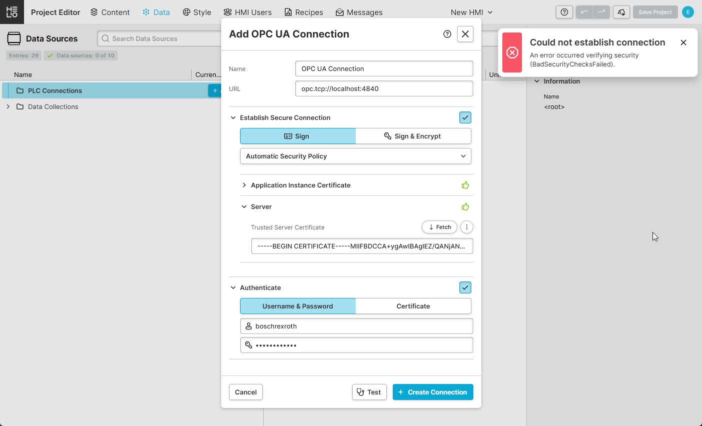

If you repeat the steps from Fig. 5 without providing them, an error will occur.
Fig. 7: BadSecurityChecksFailed
To resolve this, go to the ctrlX OS web UI β†’ Settings β†’ Certificates and Keys β†’ OPC UA Server and trust the certificate. (Fig. 4).
