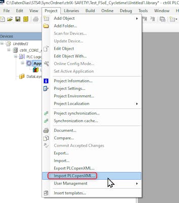

Step 1: Import the attached Functionblock
Import the Functionblock

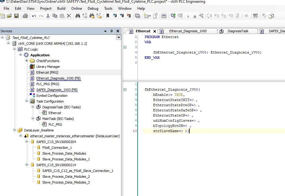

Step 2: Call the Functionblock
Because it is just an diagnosis the cycletime of this task can be slow.

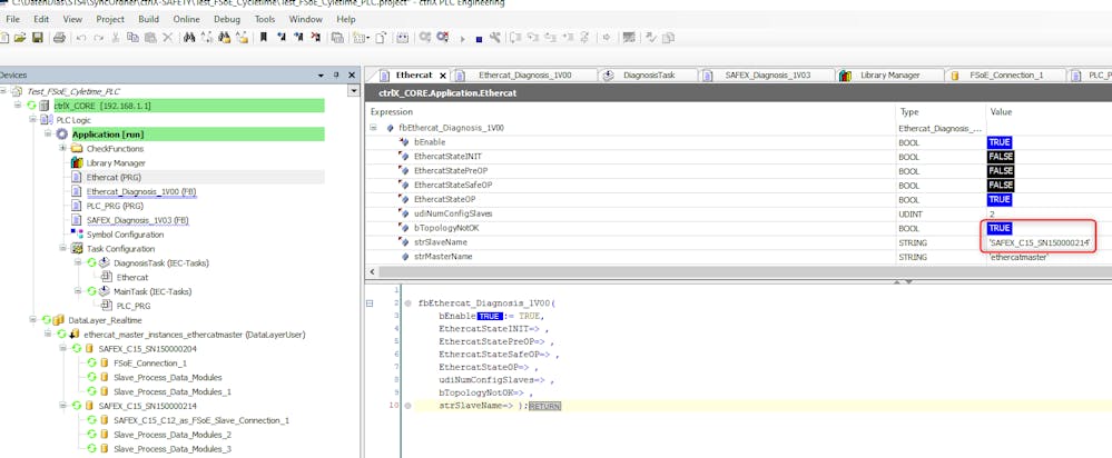

In case of an error like break of Ethercat cable, the bit Topology is not OK is comming and the name of Slavedevice which is missing is shown.
Check the function
You find more details how it works in the comments.
