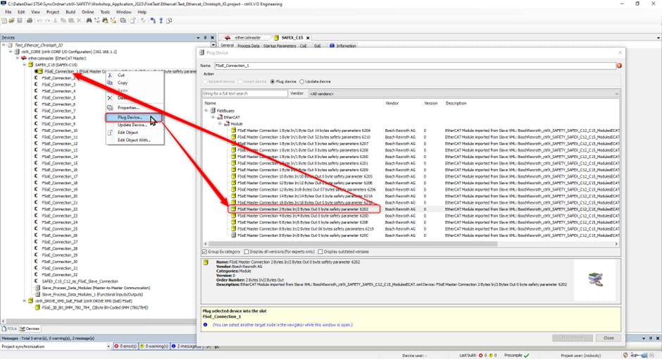

After the scan, configure the communication settings by selecting FSoE_connection_1. Then, choose “Plug Device” and assign “FSoE_Master_Connection (2 Bytes IN / 2 Bytes OUT)” to enable proper communication.
Fig. 2.: Plug Device to the SAFEX_C15 FSoE Connection 1

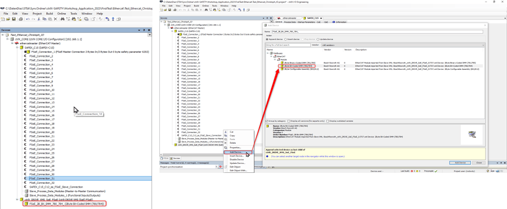

To add the “FSoE_2B_Bit…” safety module to the “ctrlX DRIVE”, open the drive in the configuration environment, select “Add Device”, choose “2-Byte Bit-Coded SMM (ID 780/784)”, and confirm with “Add Device”.
Fig. 3.: Add Device to the ctrlX_Drive_XMS

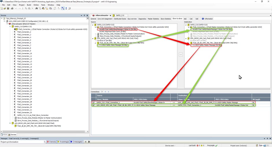

To enable data exchange between the drive and the safety system, configure a Slave-to-Slave connection. Connect the object “0x1A00 FSoE SafetySlave..” to “S-1-0024 Safety Master..”. Similarly, link “S-1-0016 Safety Slave..” to “0x1600 FSoE SafetyMaster..”.
Fig. 4.: Configuration of the Slave-to-Slave Connection between Drive and Safety

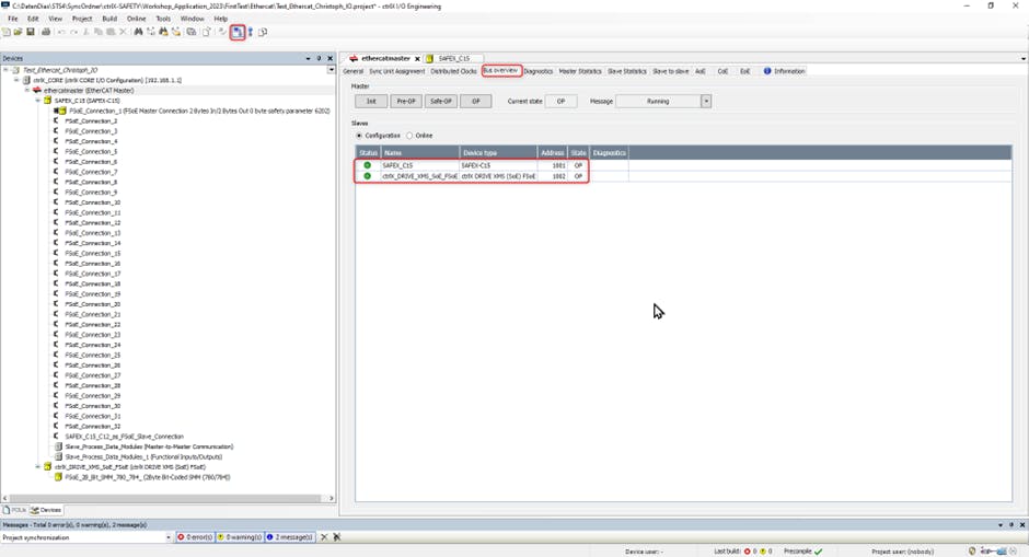

Verify the connection by ensuring that both the Drive and the SAFEX-C15 transition to Operational (OP) mode.
Fig. 5.: Bus Overview of Ether CAT Master

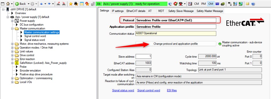

To check the protocol, open “ctrlX DRIVE Engineering”, then navigate to “Master Communication” and select “Master Communication Settings”. Next, choose “Change Protocol… “and verify that “Servodrive Profile over EtherCAT (SoE)” is selected. After that, set the “Application Profile” according to your requirements.
Fig. 6.: Master communication settings

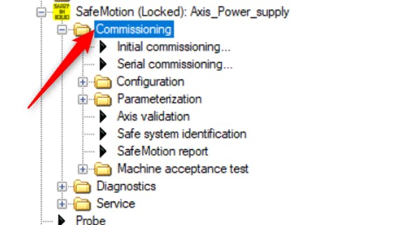

To start the commissioning navigate in “ctrlX DRIVE Engineering” to the “SafeMotion” and there select the “Initial commissioning...”.
Fig. 7.: Starting the Initial Commissioning

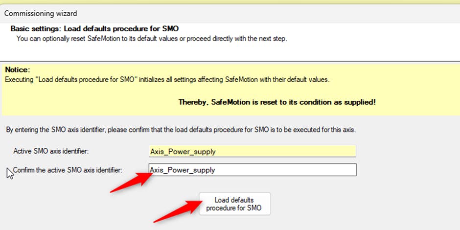

In the "Commissioning Wizard" window confirm the active SMO by copying the active one above. Then press the “Load defaults procedure for SMO” and press “Next”.
Fig. 8.: Loading default configuration of SMO

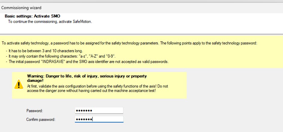

To activate the SMO, enter the password and confirm it. In this example the password is "rexroth", but it can be freely choosen.
Fig. 9.: Activation of SMO

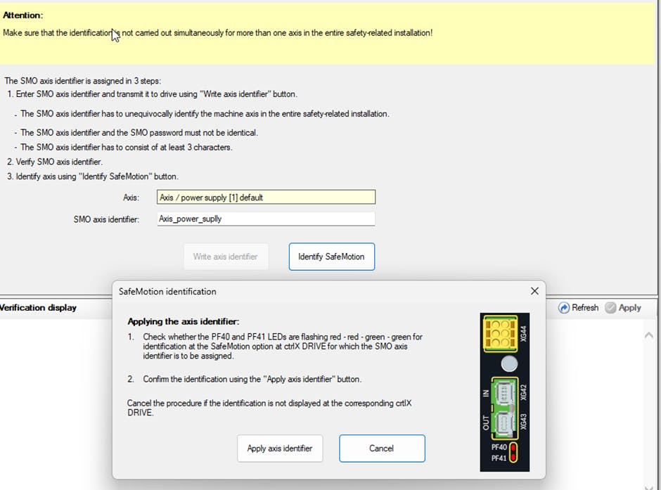

Enter an “SMO axis identifier” with any name you prefer. In this example, we use "Axis_power_supply" as the identifier. After entering the name, click “Write axis identifier”, then “Apply”. Next, select “Identify SafeMotion” and check whether the indicator lights are blinking as expected. If the lights blink correctly, confirm by clicking “Apply axis identifier”. When the identification is successful, click “OK”, then press “Next” to continue.
Fig. 10.: Assign SMO axis identifier procedure

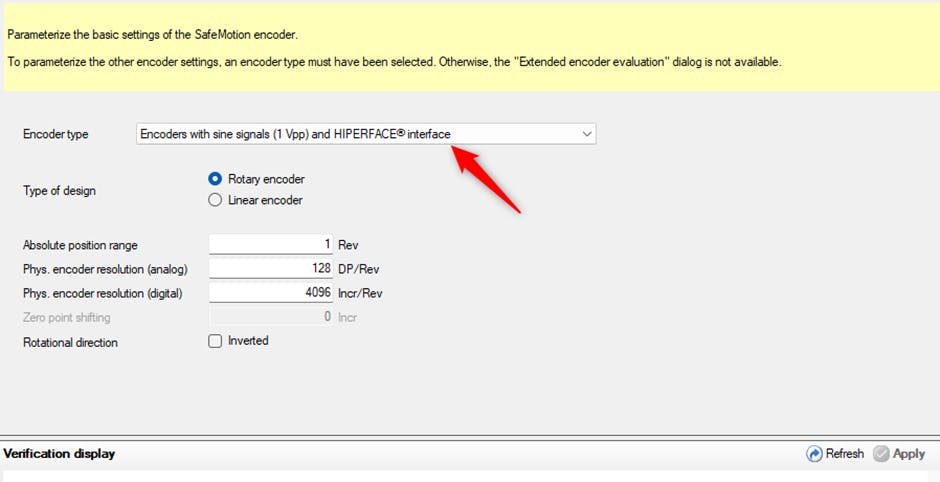

In "Encoder Type", select the appropriate encoder and adjust the parameters as shown in the image. Afterwards, click “Apply” to verify the changes.
Fig. 12.: Encoder Type and Configuration

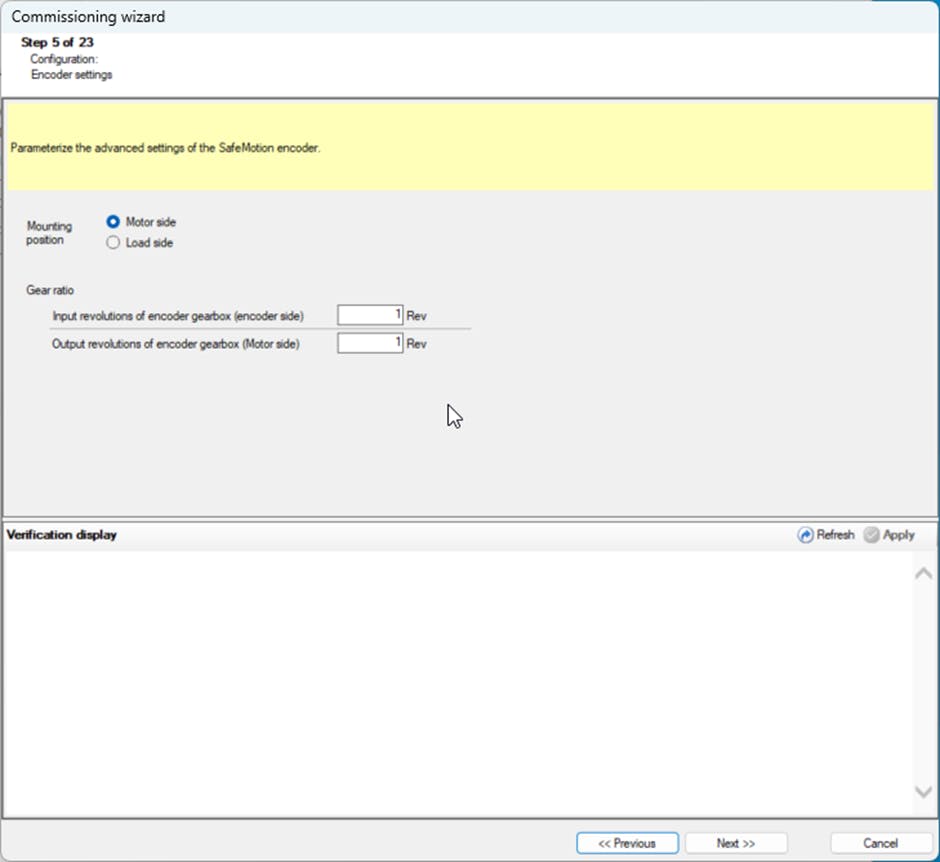

In this step make sure that the “Motor side” is selected, and the Ratios are 1.
Fig. 13.: Gear Ratio and Mounting position

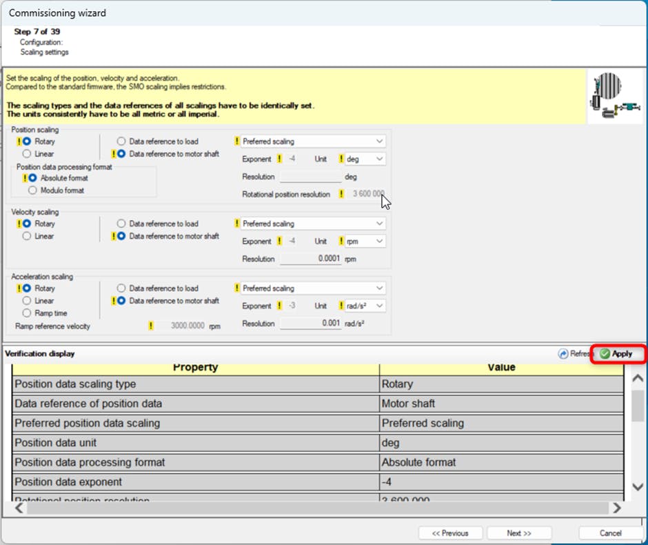

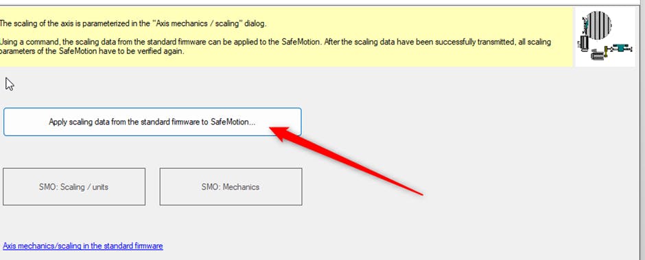

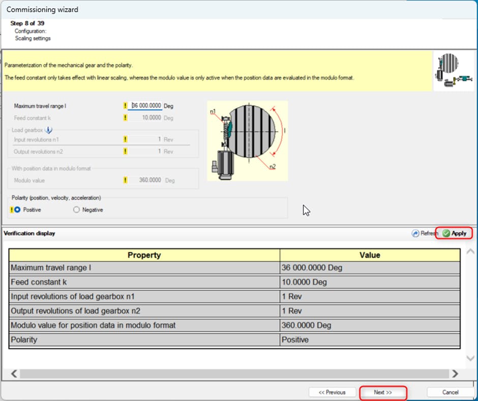

Press the “Apply scaling…” button there and select “Yes” to start the SMO scaling function. Then if command execution was successful close the window and press “Ok”.
Fig. 14.: Scaling settings from SafeMotion
In this step, scroll down in the verification display and click “Apply” to confirm the preset settings. Repeat this for the following steps unless stated otherwise.
Fig. 15.: Apply Scaling for Profiles

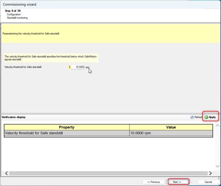

Fig. 17.: Apply Velocity threshold for Safe standstill

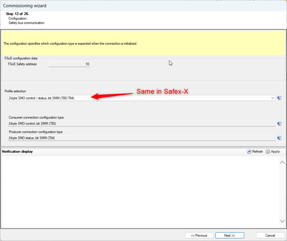

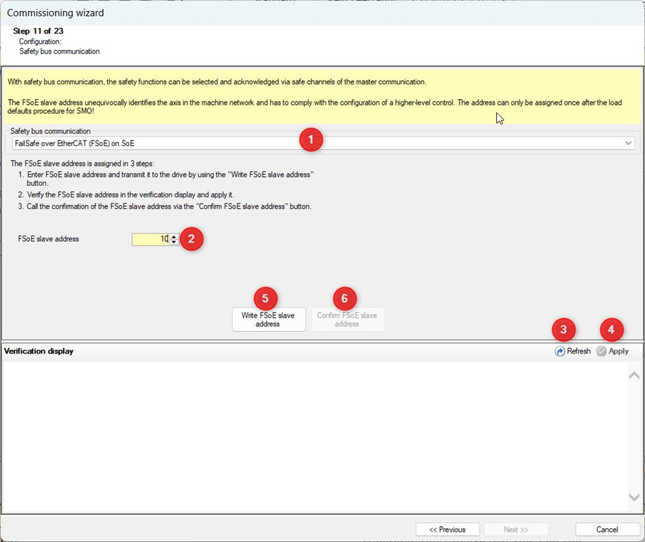

In the “Safety Bus Communication” settings, select “FailSafe over EtherCAT (FSoE) on SoE”. Change the “FSoE slave address” to 10, then click “Apply” to save the changes. Next, press “Write FSoE slave address”, click “Apply” again, and finally confirm by selecting “Confirm FSoE slave address“and choosing “Yes”.
Fig. 18.: Safety bus communication configuration
In this step, verify that the "Profile selection" matches the configuration set in SAFEX. The profile must be "2-byte SMO control /status, bit SMM (780/784)".
Fig. 19.: Check the Profile selection

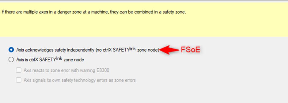

In the ctrlX SAFETYlink configuration select “Axis acknowledges safety independently..” for FSoE.
Fig. 20.: ctrlX SAFETYlink configuration

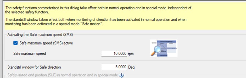

In the global monitoring functions, the “Safe maximum speed (SMS) active” has to be active.
Fig. 21.: Global monitoring function settings

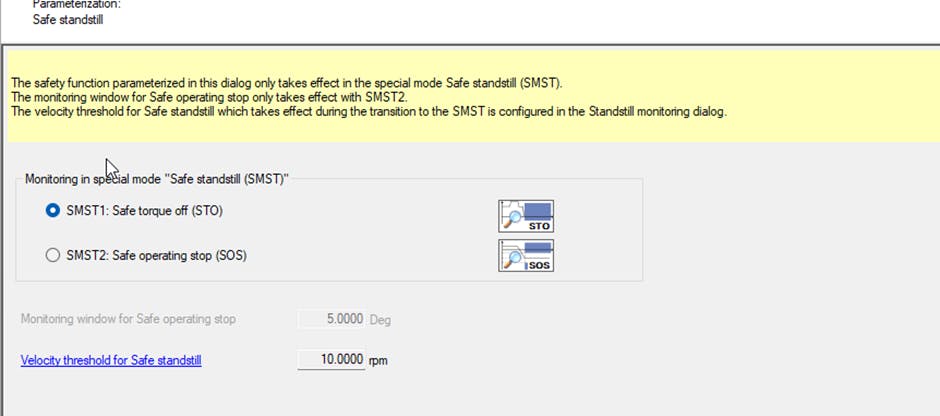

In the Safe standstill select “SMST1: Safe torque off (STO)”.
Fig. 22.: Safe standstill settings

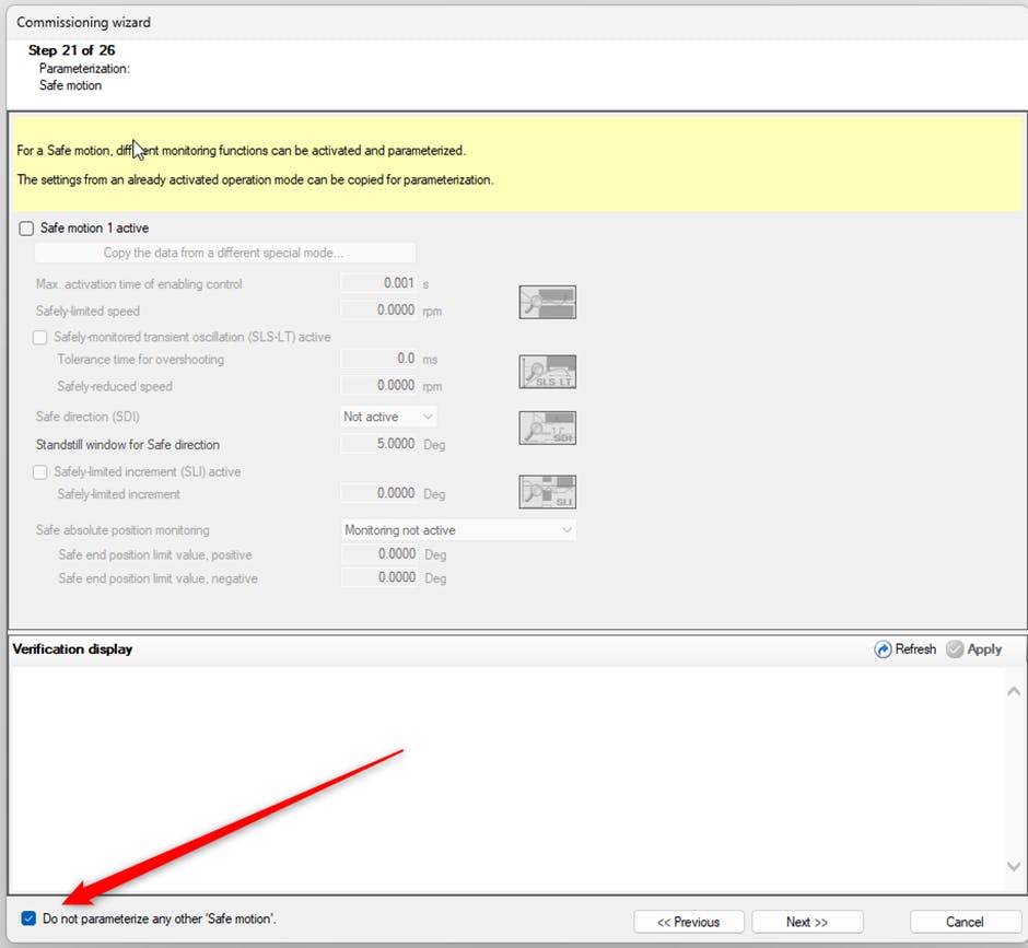

In the Safe motion parameterization select “Do not parameterize any other SafeMotion” to skip these steps.
Fig. 23.: Skip Safe motion parameterization

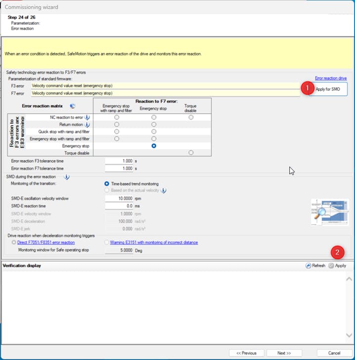

In the error reaction press “Apply for SMO” and then press “Apply” to validate the settings. The choice of tolerance time depends on your application.
Fig. 24.: Error reaction parameterization

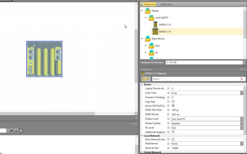

Drag the according ctrlX SAFETY SAFEX-C.1 into the Terminal Scheme. Check that the parameters are according to those in this How-to.
Fig. 25.: Add the SAFEX-C.1 in the Terminal scheme

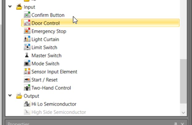

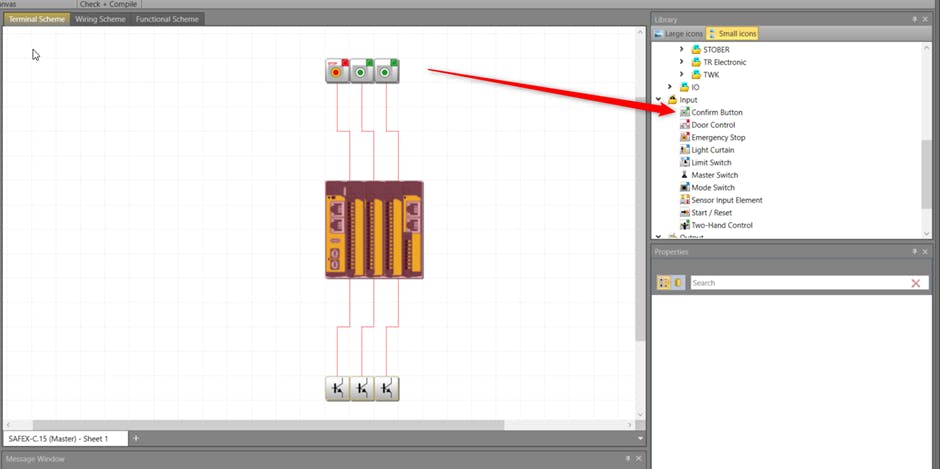

Next drag one “Emergency Stop” and 2 “Confirm Button” as well as 3 “Semiconductors” in the terminal scheme. Those elements can be taken from the library.
Fig. 26.: Library in the Terminal scheme
Fig. 27.: Inserted Buttons and Semiconductor in Terminal scheme

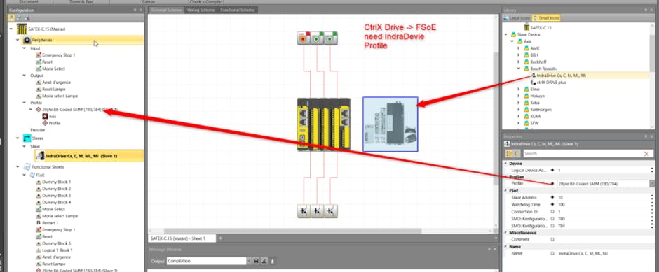

Insert the IndraDrive from the Library and Drag it into the Terminal Scheme. Select the Profile “2 Byte Bit Coded SMM(780/784)" and set the slave address to 10 and the watchdog time to 100. Even with ctrlX DRIVE you have to select the IndraDrive.
Fig. 29.: Insert the IndraDrive with the according configuration

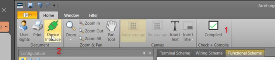

Before connecting the computer to the SAFEX controller, first “Compile” the program. Once the compilation is successful, you can proceed to the “Device Interface” to establish the connection.
Fig. 31.: Compile and navigate to the Device Interface

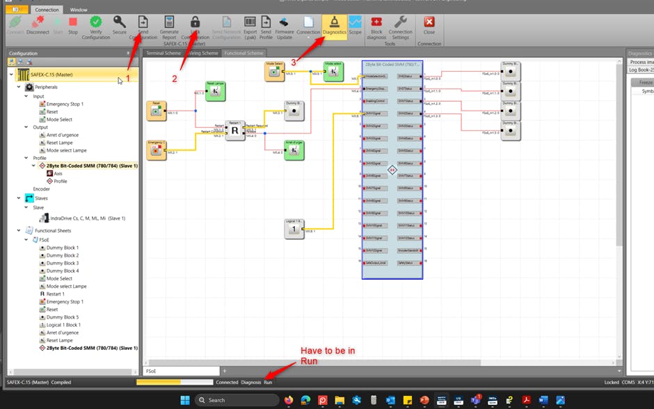

After securing the configuration, you can send it to the SAFEX controller by clicking “Send Configuration”. Once the configuration is successfully transferred, use “Lock Configuration” to prevent any further changes. After that, open “Diagnostics” to monitor the system status, such as which buttons are activated and other relevant details.
For proper communication, the controller must be in “Run” mode. If it is in “Runintern”, communication issues may occur due to programmed restrictions.
Fig. 34.: Connected SAFEX in Run mode

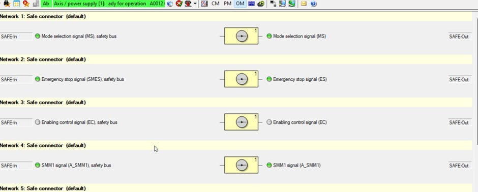

Signal checks between safety and drive
Fig. 35. :Safe Motion IO mapper

To perform the validation, navigate to “Safe Motion → Parametrization” and select “Axis Validation”.
In the Axis Validation section, choose “Easy Startup Mode”. This mode guides you through the necessary steps to confirm the axis for safe operation.
