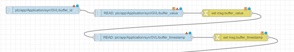

You should now create a flow which observes the buffer_id variable. On change it then should get the buffer_value and the buffer_timestamp arrays and store it to msg.buffer_value and msg.buffer_timestamp like shown in the image:
Node-RED Flow

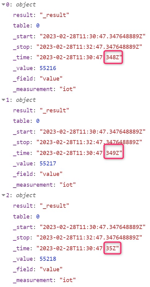

If everything went according to plan, the raw data should be visible in InfluxDB with 1 ms distance between each data point.
Node-RED Debug
