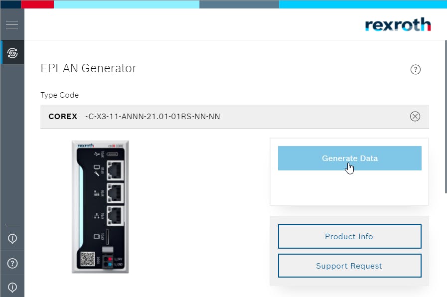

In EPLAN Electric P8, open the EPLAN Data Portal via (Utilities/EPLAN ePULSE) and select the Bosch Rexroth product catalog. Then select the required product family in the Rexroth product catalog and start the Rexroth EPLAN Generator. Here in the example: COREX-C-X3-11-ANNN-21.01-01RS-NN-NN

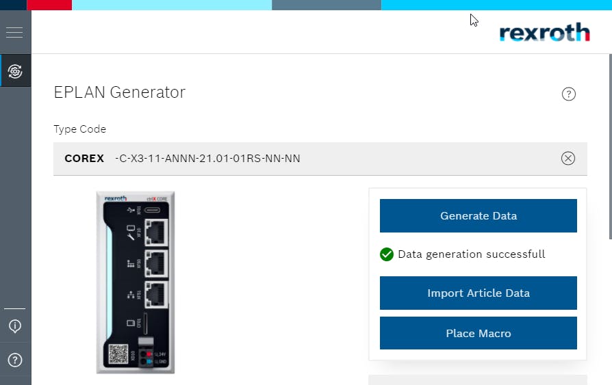

Generate the EPLAN device data in the EPLAN Generator by pressing the 'Generate Data' button.
After successful generation, the generated part data can be transferred to the local EPLAN installation by pressing the 'Import Article Data' or 'Place Macro' buttons.

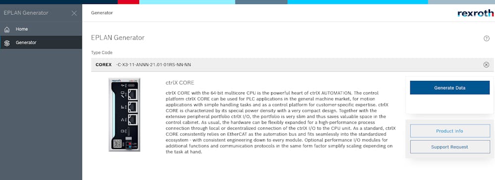

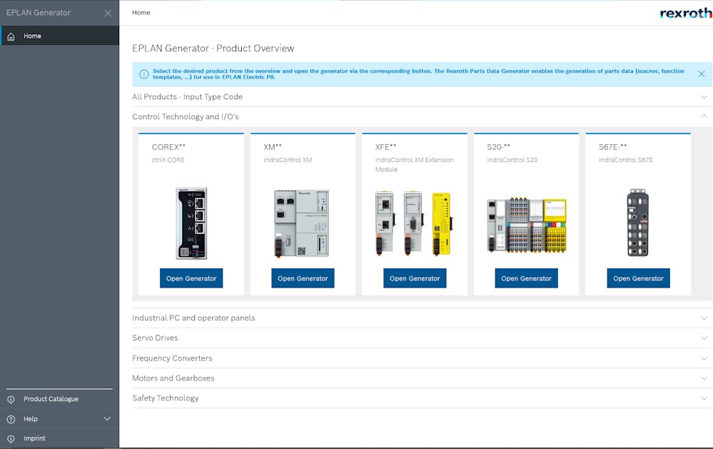

The type code can be entered directly under 'All products - Type code input' or after selecting a device family and product variant. Here in the example: COREX-C-X3-11-ANNN-21.01-01RS-NN-NN

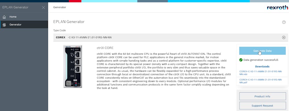

Generate the EPLAN article data by pressing the 'Generate Data' button.
After successful generation, the generated article data can be downloaded in EDZ format or as a PDF preview.
