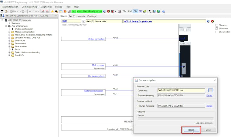

Procedure
Select the relevant axis by right hand mouse click.
Next select: Firmware update.

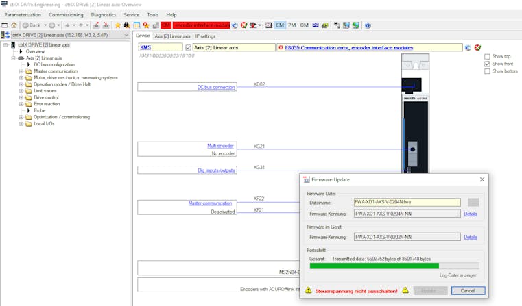

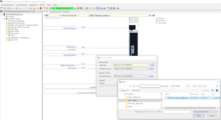

Then select the firmware version file you want the drive to be updated to.
Press button: Update.
Agree to start the firmware update.

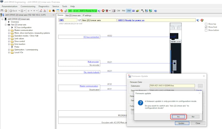

Depending on the condition of the axis additionally the axis need to be switched to configuration mode.

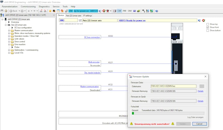

Then firmware update by transmitting the data will start.

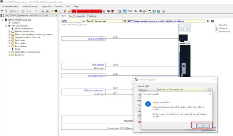

Wait until “Firmware update” is finished.

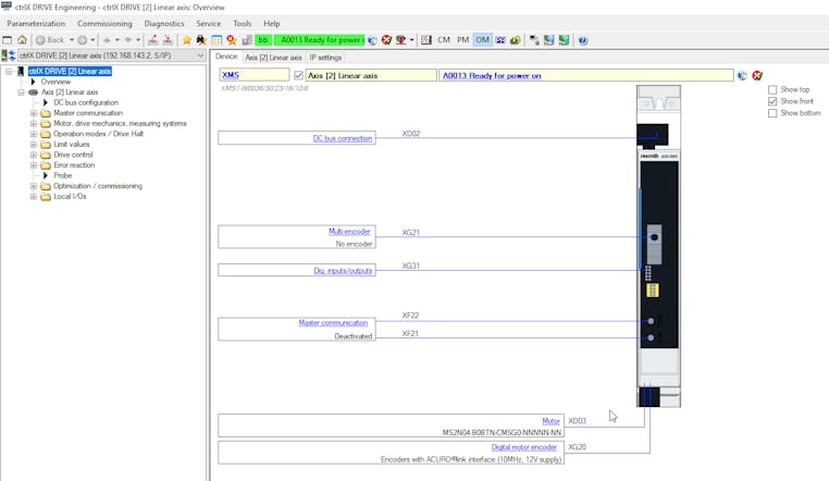

Next restart the drive by switching it (24V) off and on again..
Drive will come back again (firmware updated).
