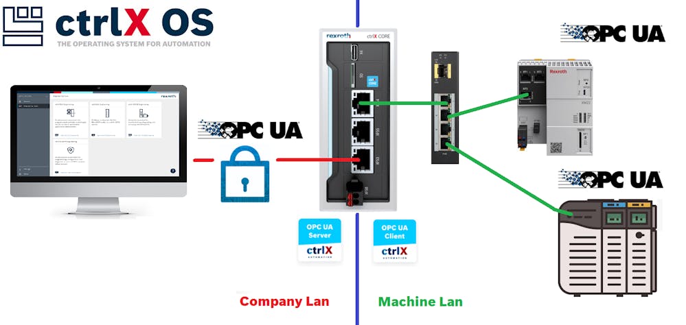

Production machines are really different one from the other but any machine has a controller (or more) that can be a target during a cyber attack, so how to protect our production? Sometimes we just need to protect the exchange of the data between the controller and the network LAN and we know that this communication will be just over OPC UA.
OPC UA secured
Overview of the used setup

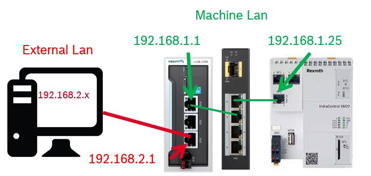

The idea is to take one or more machine OPC UA servers which are/can be unrestricted and or unencrypted and share just the necessary data of the ctrlX Data Layer over a tailored made OPC UA server. Here there are the devices used and the IP addresses involved.
Test Layout
Equipment used
The test has been done with:
  • ctrlX CORE installed system apps release 2.02 (from 1.20 is good)
    • XF10 set to 192.168.1.1, XF51 set to: 192.168.2.1

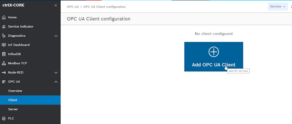

To test this feature we connect the ctrlX CORE OPC UA app to the servers in the network. The steps are the following:

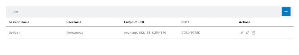

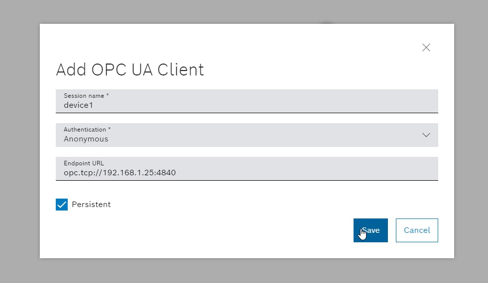

  1. Add a new OPC UA client

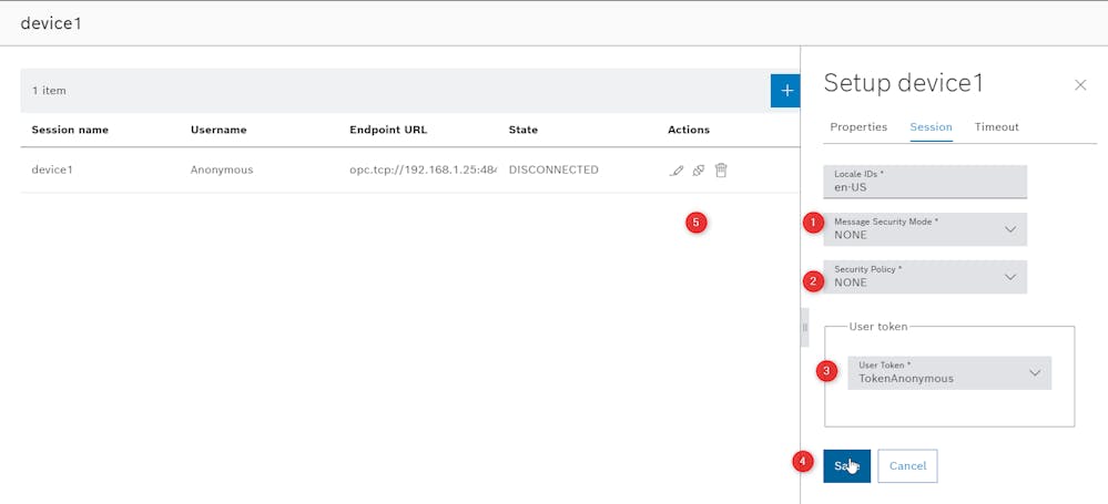

  2. Insert the connections parameters of the OPC UA server and make the device persistent
  3. Adjust the parameters, save and press on connect, if it is successfully the dialog will show "CONNECTED"

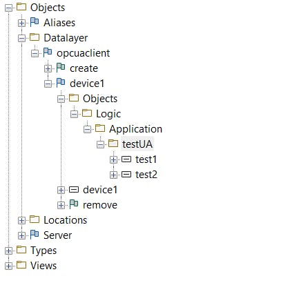

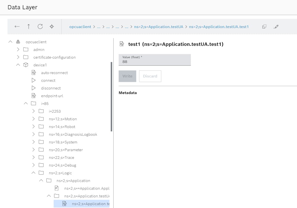

  4. Check that the data are present on the ctrlX Data Layer
OPC UA Client

Data Layer OPC UA Client

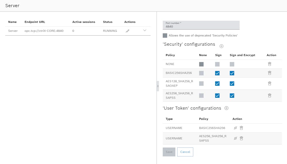

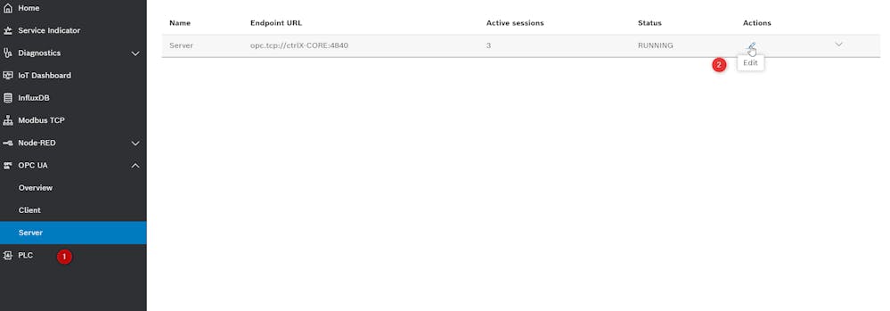

We can tune the server to support (or not) various security standards. we have to navigate trough "OPC UA -> Server", click on the edit button, tune the server and then save.
Go to the edit button
OPC UA Server Settings

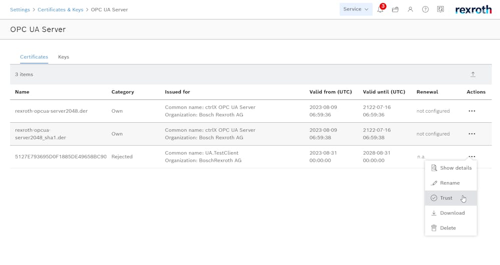

  1. Open the tool and check the connection, trust the certificate of the ctrlX CORE. The first connection try will fail.
  2. In ctrlX CORE we have to navigate to: "Settings -> Certificates -> OPC UA server" and trust the certificate of the test client.
  3. We can retry and now use the functionality. Use your ctrlX CORE credentials with full access. Standard is "boschrexroth".
Trust OPC UA Certificate
Trust OPC UA Certificate Server Side

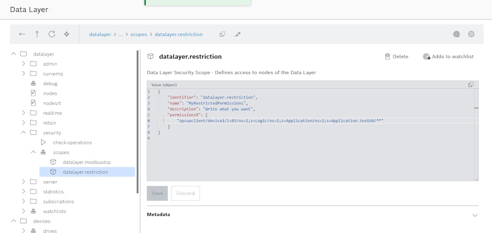

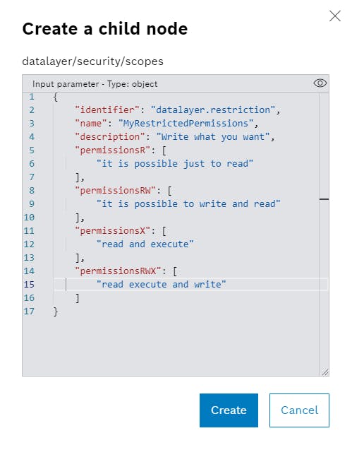

Let's start with the scopes. We need to go to settings and then ctrlX Data Layer. In datalayer/security/scopes we can create a scope with the following structure:
Scope example
As we can see we can specify a lot of subnodes with the needed capability. We need an identifier and a name. The name will be displayed in the permission list to give to the user the scope capabilities. Here there the scope we're going to use. The user will see just what is behind the selected none with just read capabilities.
"identifier": "datalayer.restriction",
"name": "MyRestrictedPermissions",
"description": "Write what you want",
"permissionsR": [
"opcuaclient/device1/i=85/ns=2;s=Logic/ns=2;s=Application/ns=2;s=Application.testUA/**"
Scope implementation

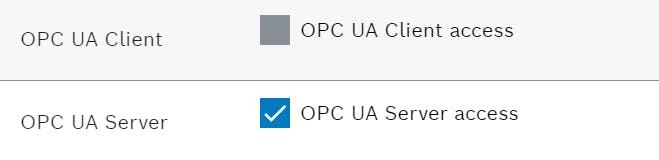

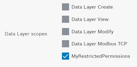

 We insert now an user which is named "service" which will have just the following capabilities:
Sever Permissions
Datalayer Permission
Accessing with the "service" credentials we're able to access just to the right nodes with the right permissions.
Final result
