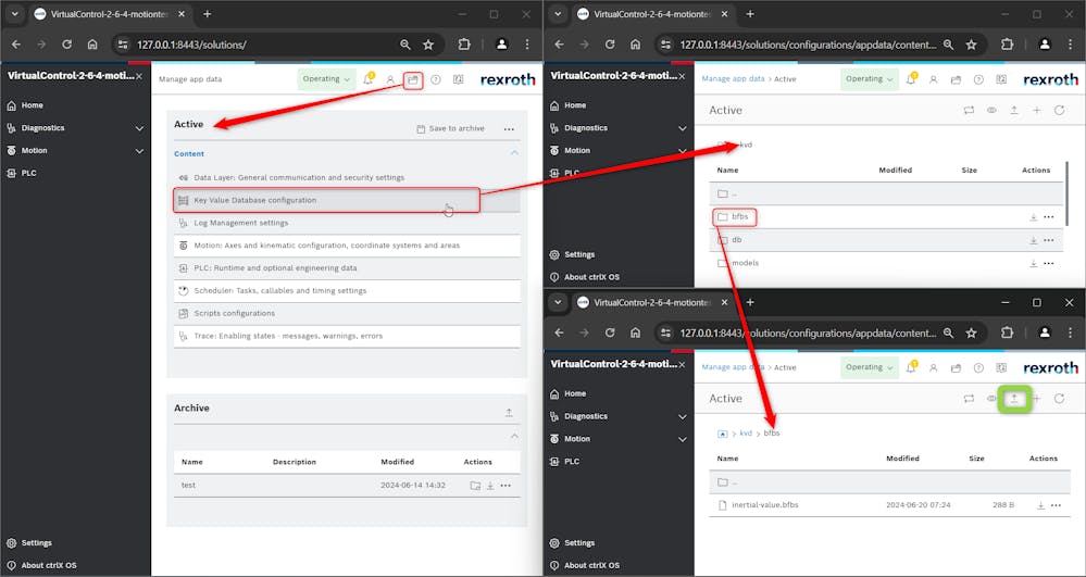

  • Upload the generate *.bfbs file to app data (active configuration) directory kvd/bfbs.
    ctrlX OS - Web UI - KVD app data - bfbs
