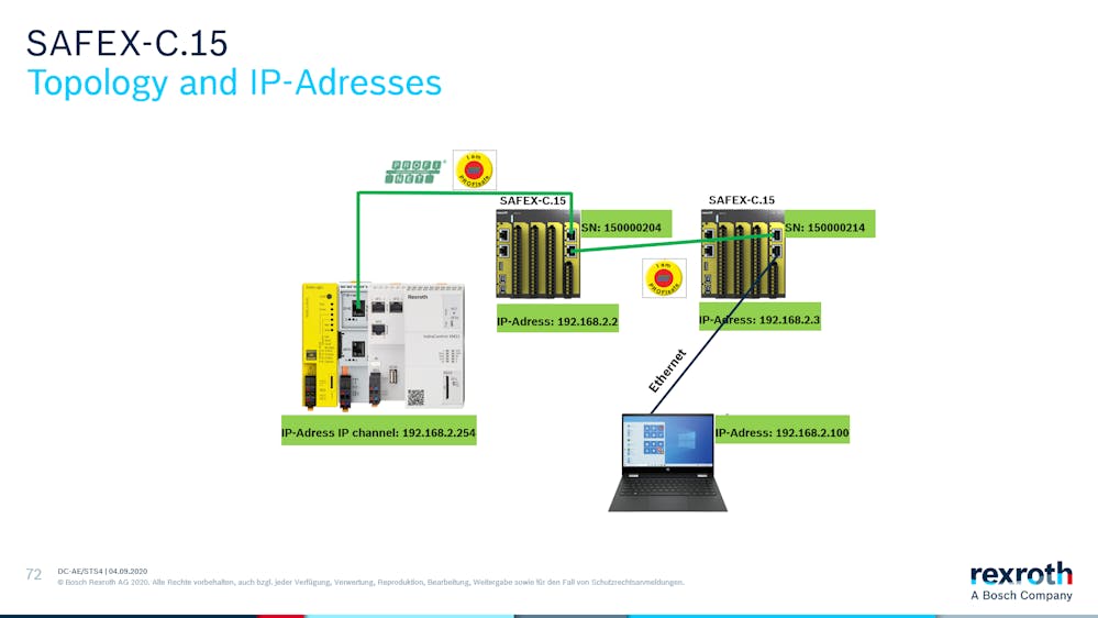

Topology example
Topology
Remote access via Profinet for Diagnostic and Programm changes

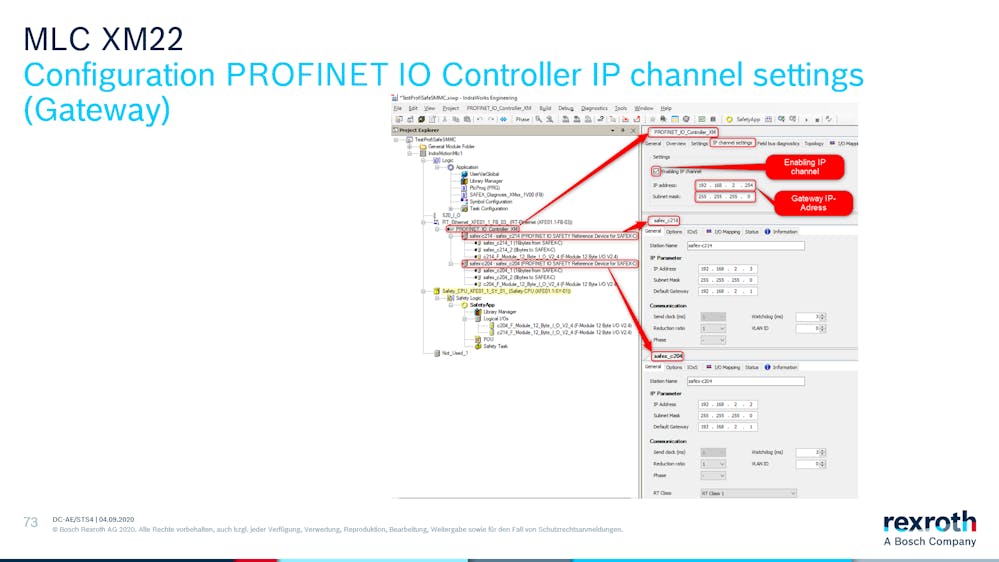

Before you can have a remote access to the SAFEX-C.15 the Profinet must be configured and must be run. Now the Profinet IO Controller has to be configued.
Configuration Profinet IO Controler

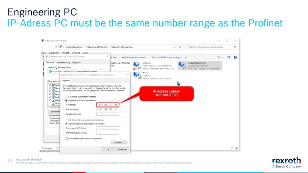

Configure your Network from your PC

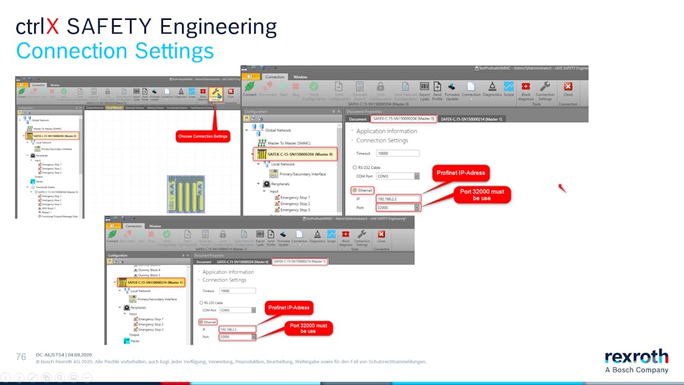

Configure the Connection settings of the SAFEX-C.15
Plug your Engineering PC to the Profinet like shown in the Topology.
Now you can connect.
