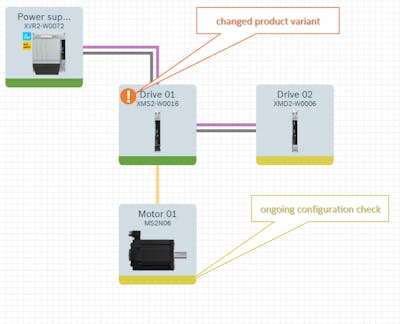

The changed behavour of ctrlX Configurator is shown to the user with a new yellow product status, which indicates a not yet completed check of the corresponding product. A possible change of a product variant based on product defaults is indicated with a orange exclamation mark, see example below.

  • Initial product configuration
  •  Product configuration has been changed
  • Product configuration not checked
  • Product configuration not valid - configuration settings have to be checked by user

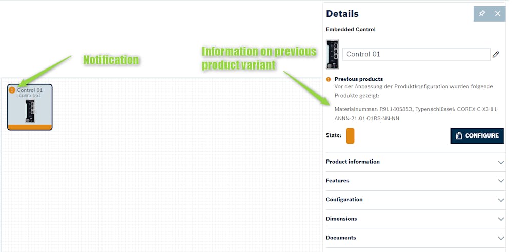

Information on changed product variant
In case of modified product variants based on new default settings within product configuration, the previous product variants are shown with material number and type code in the corresponding details dialogue of the product marked with orange exclamation symbol.
