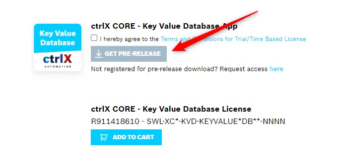

Step 1: Download Key Value Database App
At the bottom of the Key Value Database App description in ctrlX Store you can find a section as shown in the screenshot below, where you can get the app and its license.
DOWNLOAD KVD APP

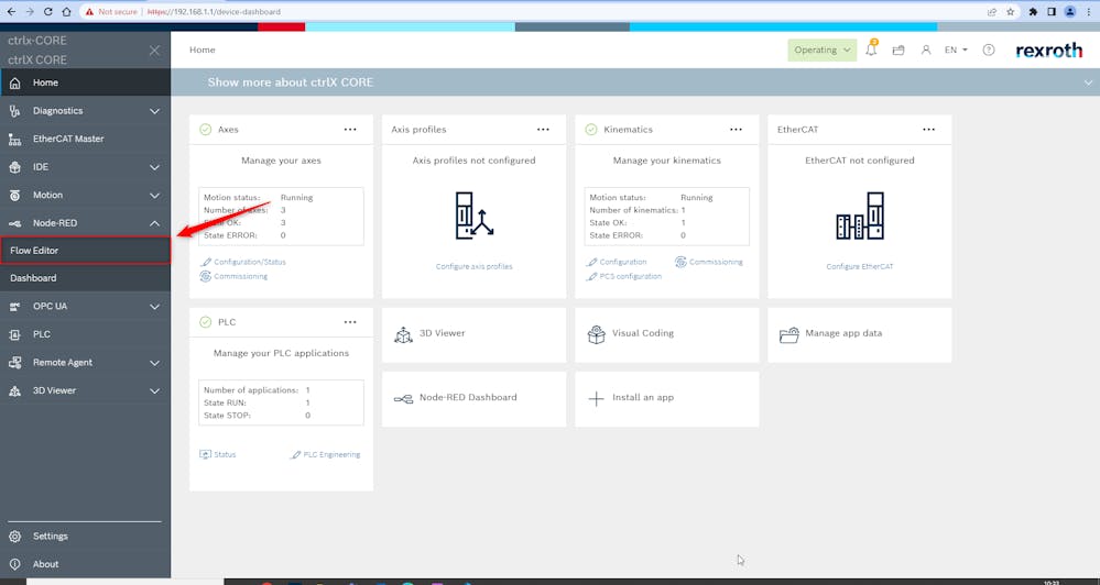

Step 1: Open Node-RED
One can open a Node-RED via ctrlX CORE web interface as shown in the picture below.
ACCESS NODE-RED THROUGH WEN INTERFACE OF CTRLX CORE
Step 2: Create a flow
Click on the button 'flow editor' in the Node-RED dropdown menu in the sidebar and it will pop-up a new tab of Node-RED for ctrlX in your browser.

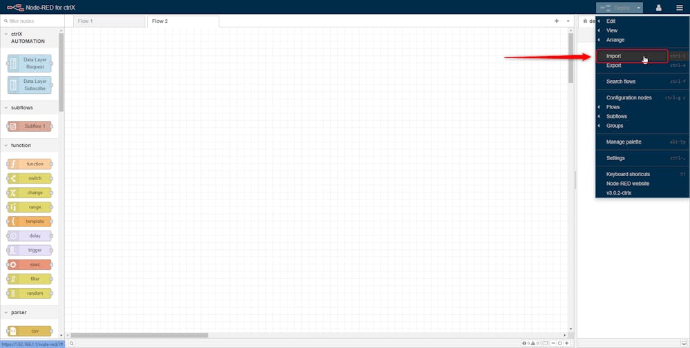

Option 1: Just copy the code below in the import option, which can be found on the right side menu button as shown in the picture below or simply press ctrl+i.
IMPORT OPTION FOR GIVEN JSON FILE
In this import dialogue box copy the code below. the flow will be automatically generated after importing the code. More information about 'Import-Export of flows' can be found in this YouTube tutorial.

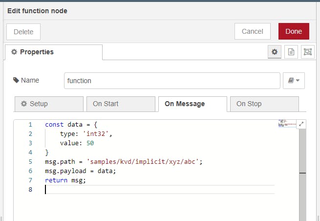

1. Configuration of Function Node
After double-clicking on the function node a dialogue box for "Edit function node"  will open, in which you can type in code as shown in the screenshot below and then click on the "DONE" button. in the picture below data, the variable represents which kind of variable we want to create, in our case it will be an integer.
DIALOGUE BOX FOR EDITING FUNCTION NODE

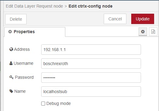

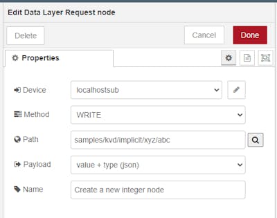

2. Configuration of Data Layer Request Node
By double clicking on the data layer request node a dialogue box for " Edit data layer request node" will open.
First thing is to configure a device for that. Click on the "pencil" icon, a properties dialogue box will open as shown below. Enter the respective data about username and password and click on "update".
POP-UP FOR EDITING CONFIGURATION OF DATA LAYER REQUEST NODE
Now we have configured the device and we are back to "Edit data layer request node". Enter data as shown in the screenshot below and click on "Done" and the flow is ready to deploy.
note: If you have already define msg.path in function node then you are not required to define it in picture below.
POP-UP FOR DATA LAYER REQUEST NODE TO CONFIGURE PROPERTIES OF NODE

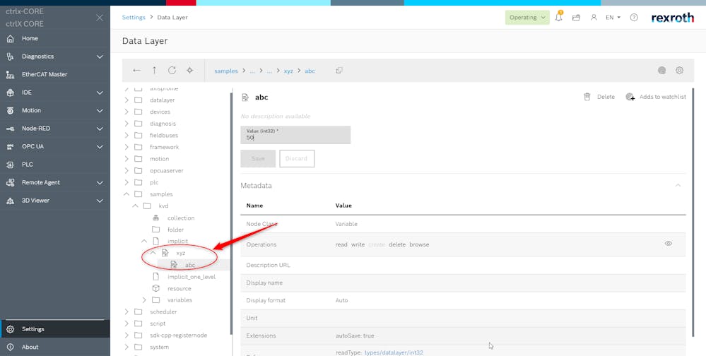

We can deploy our flow by clicking on the deploy button, which can be found in the top-right corner of the Node-RED environment. Then press injects button in flow and a new abc child-node with a xyz node will be created in the Data Layer.
GENERATED NODES IN DATA LAYER
