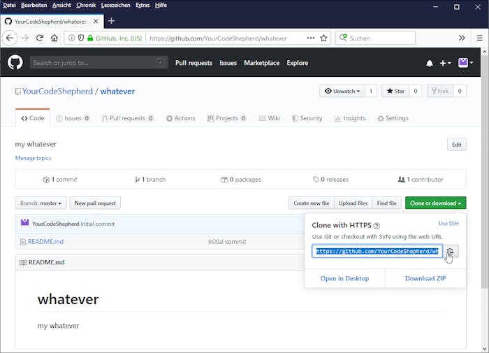

  3. Get the link to your repository. This link is needed to work on your repository in other tools.
    Get repository link

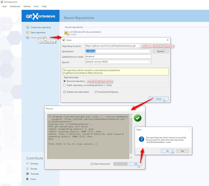

  1. Clone GitHub repository to your local Git using Git extensions to have a editable copy on your PC.
    With each click commands are sent from the GUI to Git. So no command line programming is necessary.

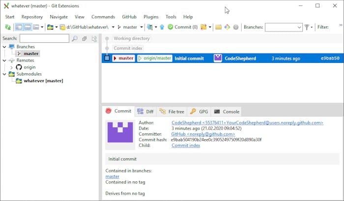

    Opened repository

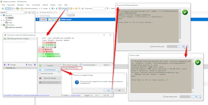

  3. Commit and push changes so your changes will be uploaded to GitHub and a version restore point with release notes is automatically created.

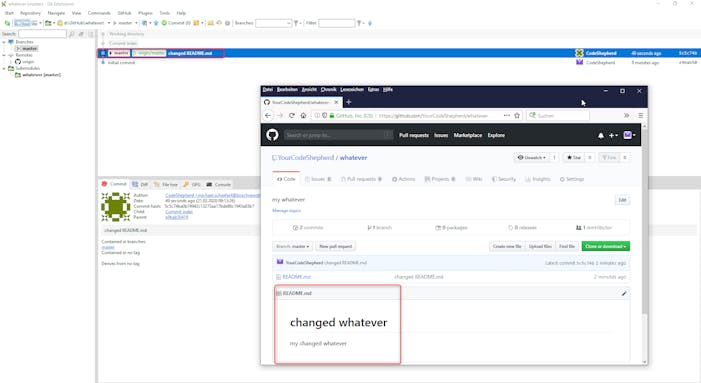

    View changes
