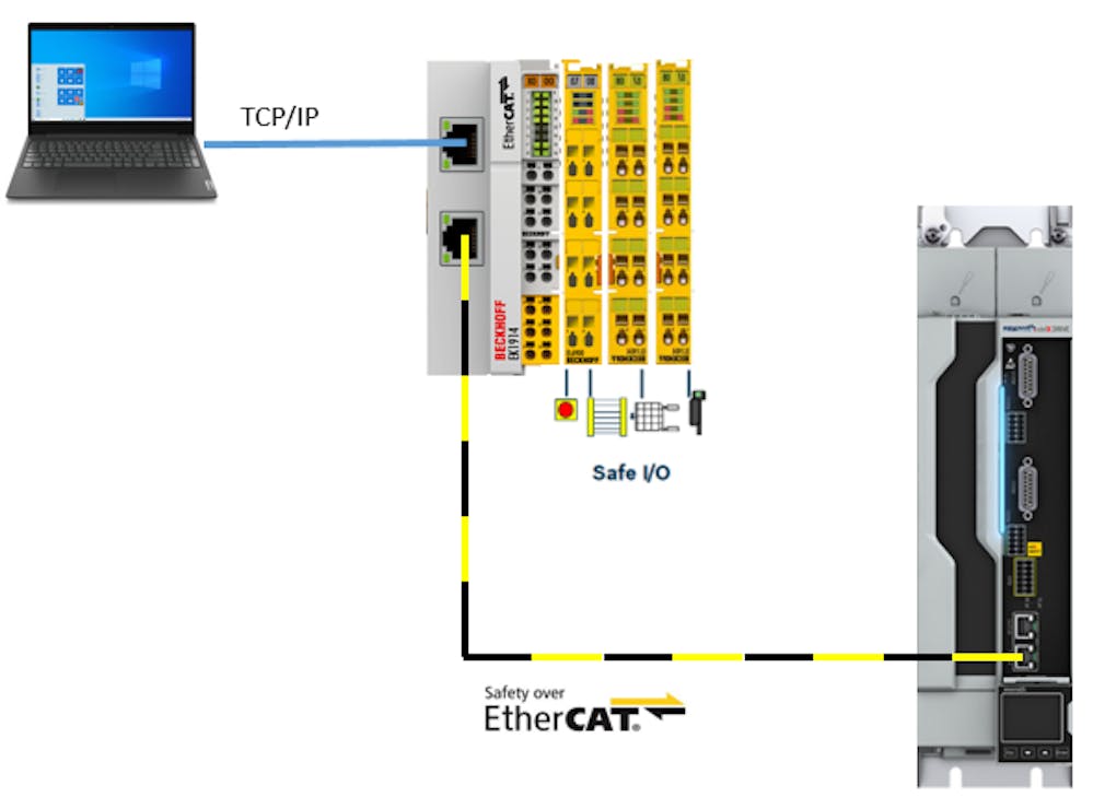

Topology
  • ctrlX Drive Engineering version 1.13
  • TwinCat 3
Used hardware:
  • Beckhoff EtherCAT coupler EK1914
  • Beckhoff EtherCAT communication interface EL6900
  • 2x Beckhoff EtherCAT 4-channel digital inputs
  • ctrlX DRIVE XCD2-W2323
  • Runtime / firmware version AXS-V0305

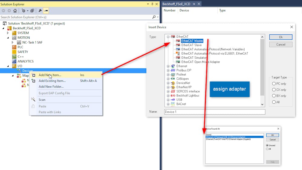

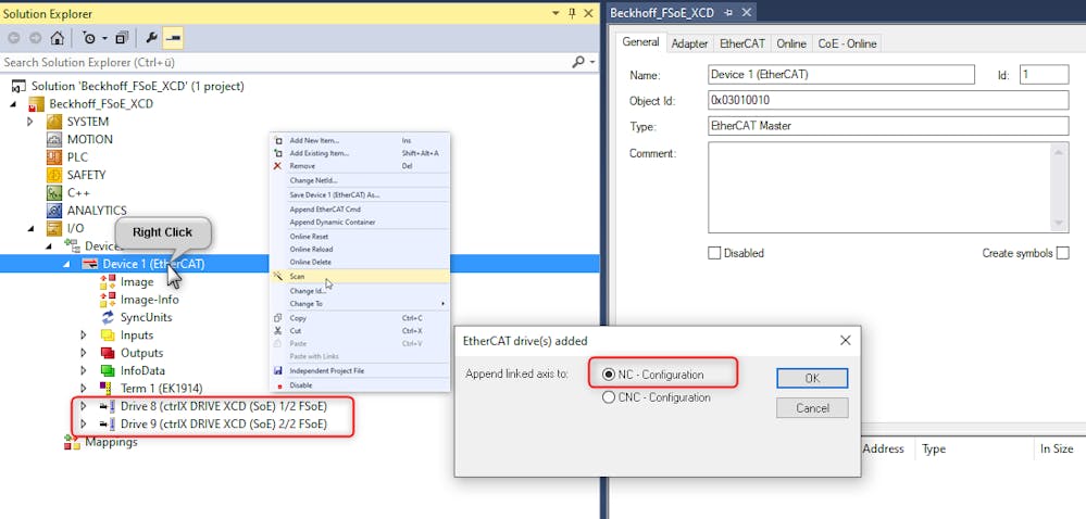

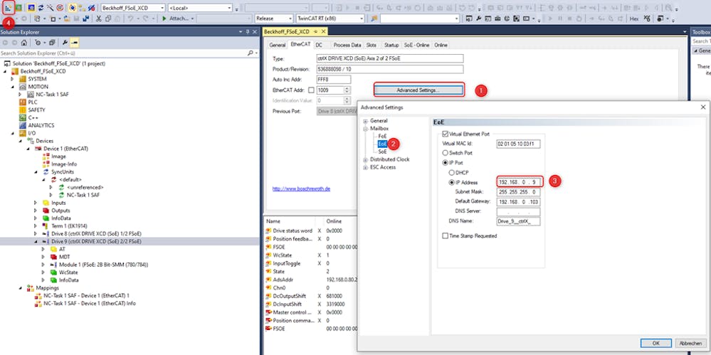

Start NC default project and add an EtherCAT Master.
Add your ctrlX DRIVE(s) via Scan or manually.
Set EoE (32Bit EIDN Ethernet over EtherCAT connection) settings and activate configuration.
After activation Master should be in RUN mode and drives should be  found via EoE connection at ctrlX DRIVE Engineering.

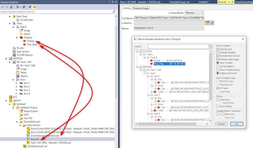

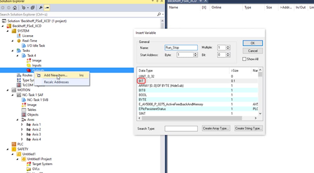

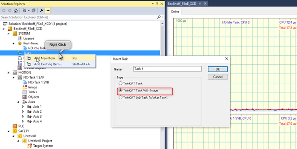

Add a new task
and add two Variables for ErrAck and Run!

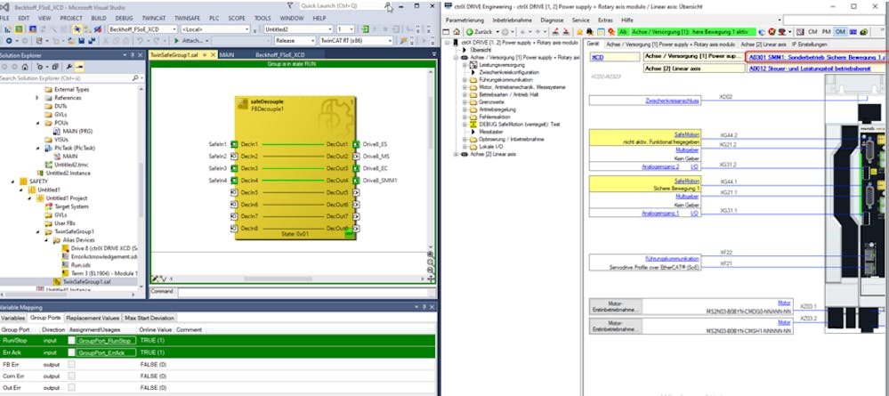

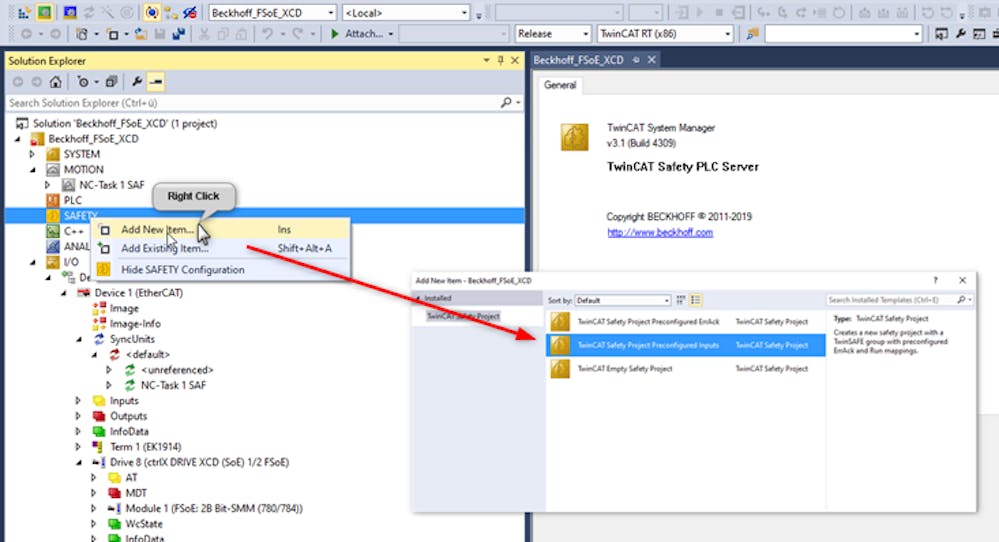

Add a new Safety project with pre-configured inputs.
Select used modules (can also be deleted later) inside the project. Otherwise compile errors occur.

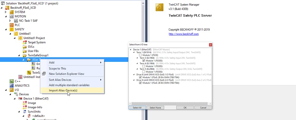

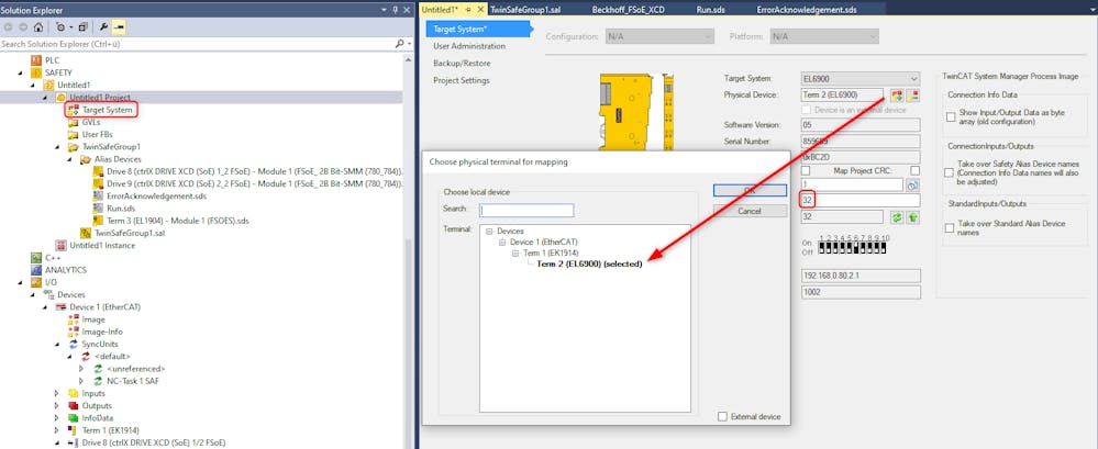

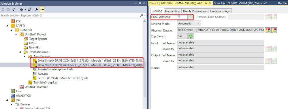

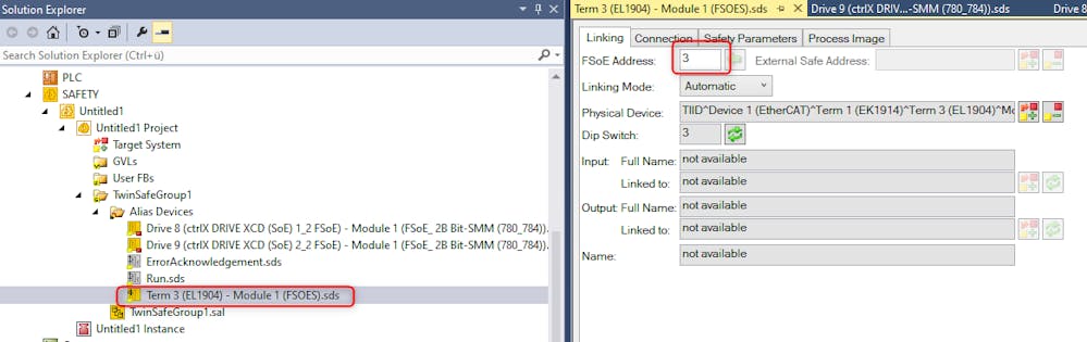

Set the FSoE addresses (same as ctrlX DRIVE settings).

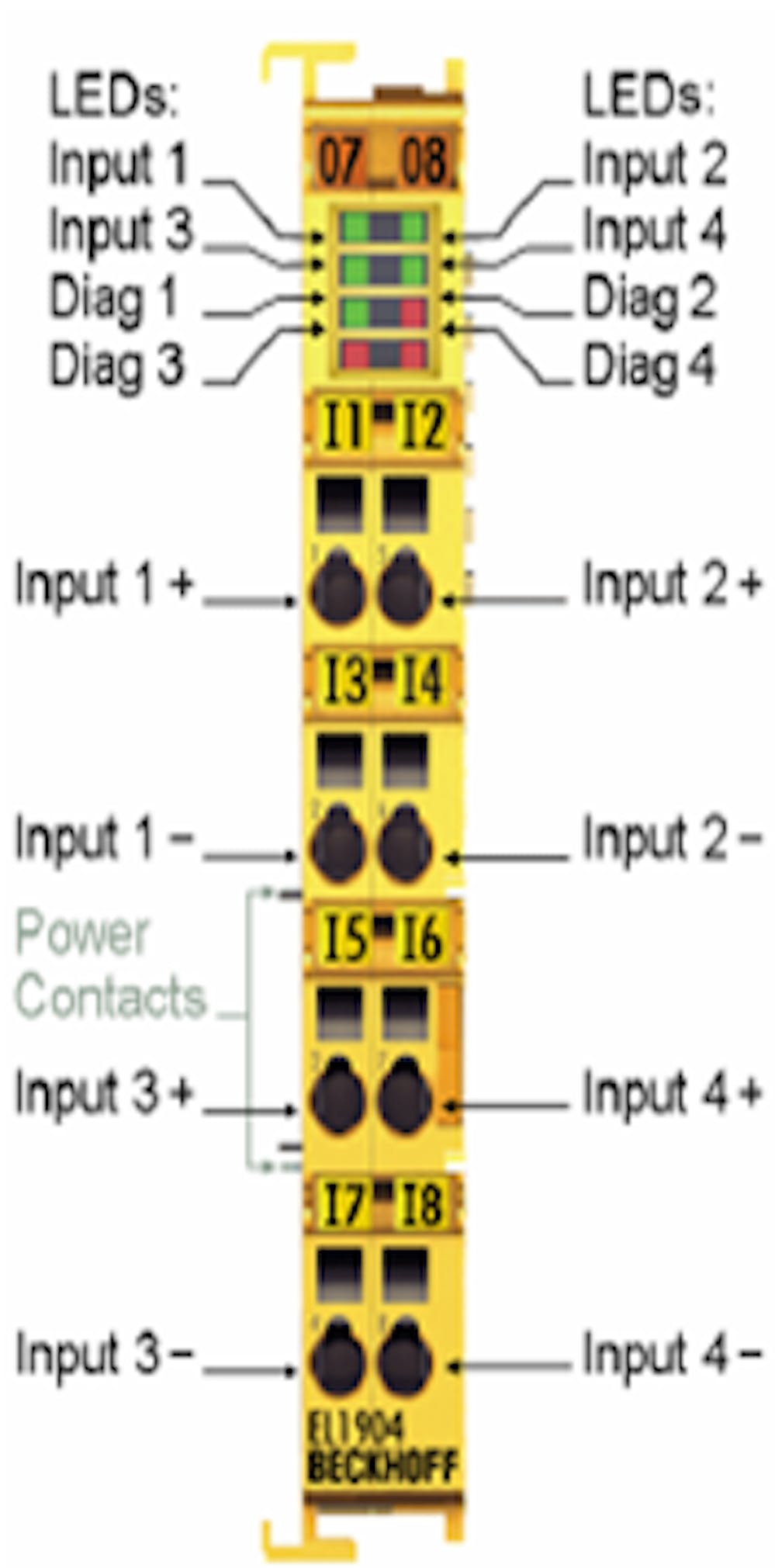

Set the FSoE address of the used Terms.

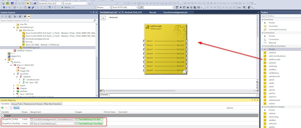

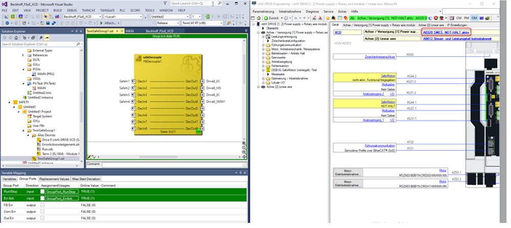

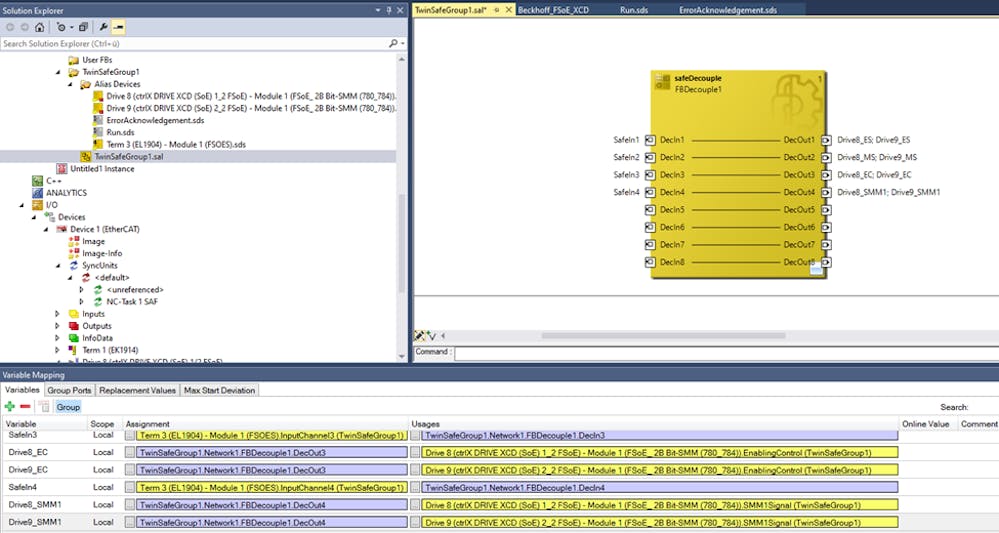

Add function block e.g. safe decouple to Network. ErrAck and RunStop are linked automatically.
Create your inputs and assign them (example see below).
Link Run and ErrAck to Variables.

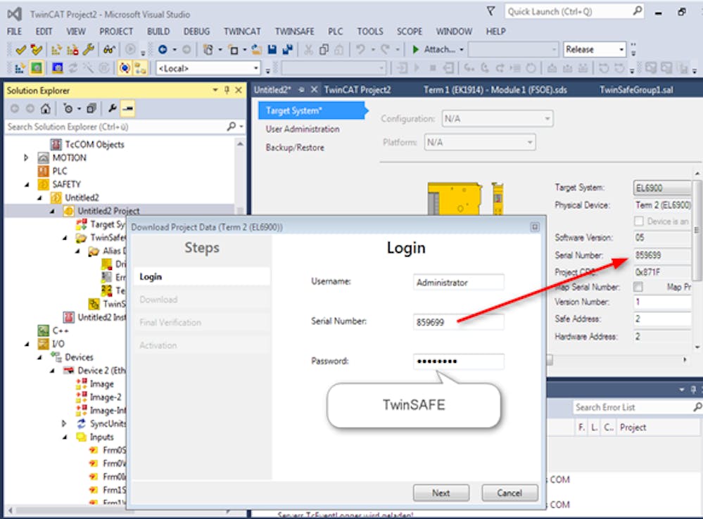

Choose your target system and adjust the Safe Addresses.

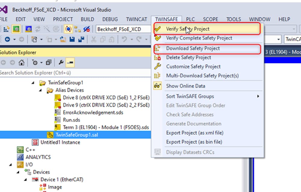

After the correct selection "Download" window will open automatically. Input the serial number, the Password must be inserted later on.
If the verification works without error, download the project.

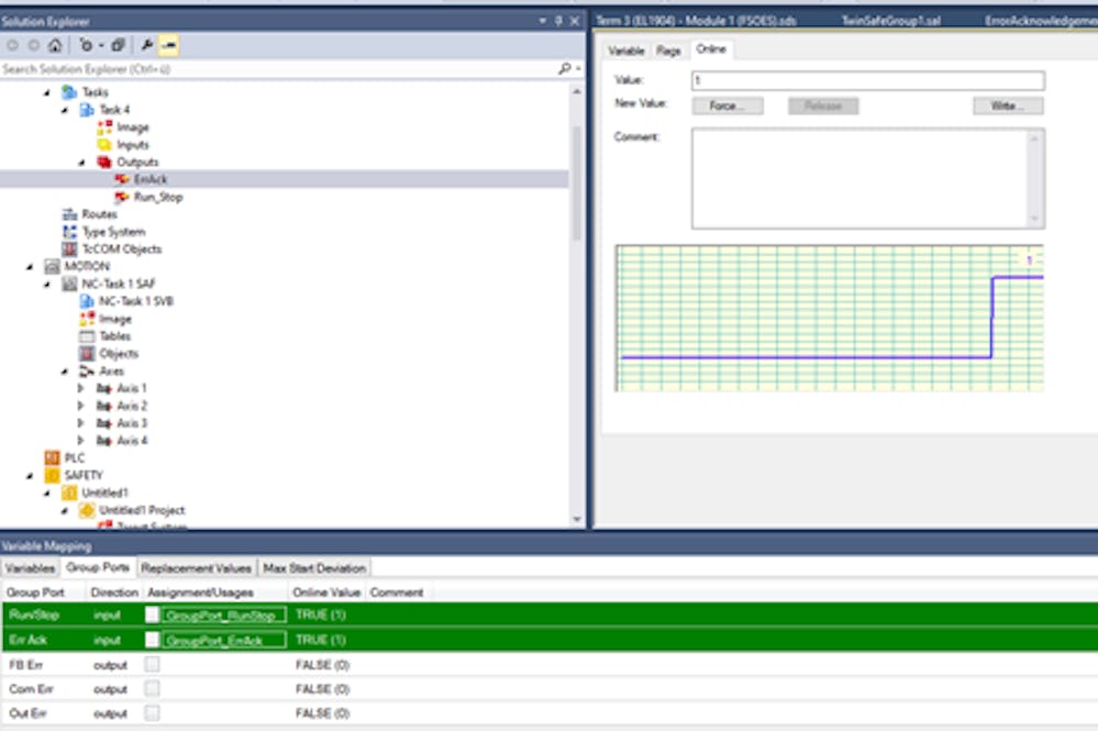

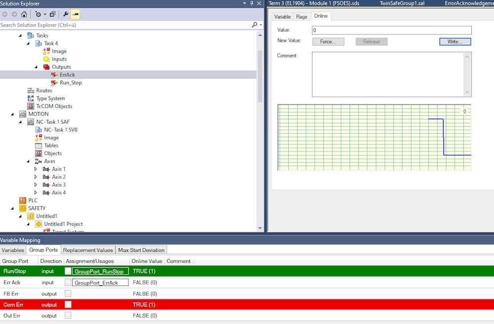

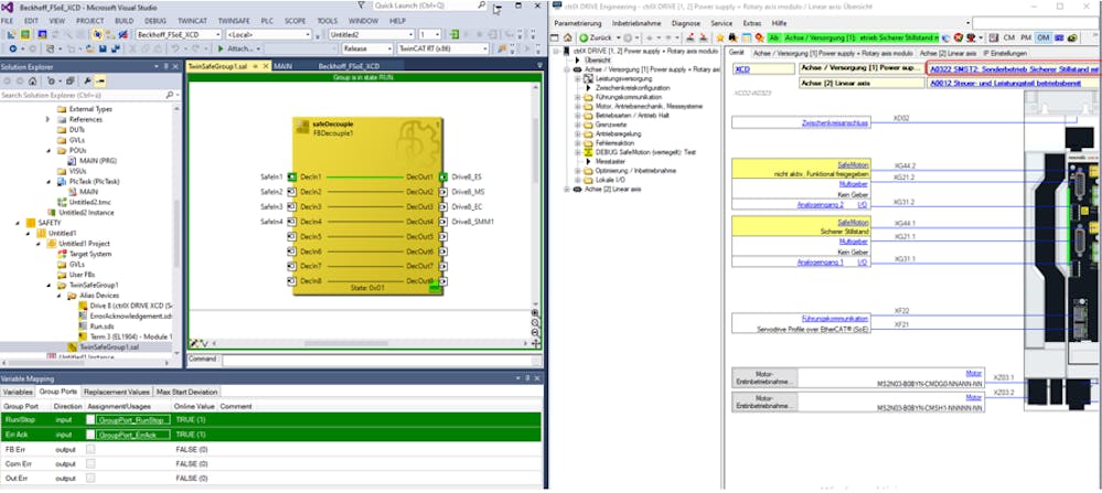

After project download LED4 blinks -> force ErrAck, LED4 should lights up permanent.
Force also Run.
Possibly ErrAck has to be forced again to reach the correct (green) status of the group ports.

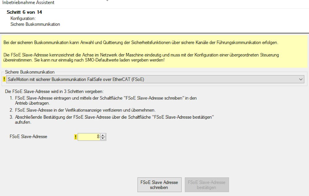

Set FSoE slave address and profile type in ctrlX DRIVE Engineering same as in Twin Cat.
After the drive settings are adjusted possibly TwinCat needs to Restart/activate configuration again; iteration of force run/ErrAck might be necessary!

Finally the correct working of the state machine can be tested.
Opteration mode
SMES
SMST2
SMM(1)
