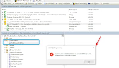

What is the correct way to get access to the samples in the OPC-UA client library?
When I try to access the example .zip I get the following error.ย
Best reply by NoRisk4Project
because of security restrictions inside Codesys, it's not possible to open/download objects of unsinged/self-signed libs. The "CXA_OPCUACLIENT" is such a lib, so the included sample can't be opened.
I added the sample for version 1.20 ...
