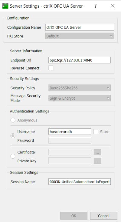

Could you please explain the architecture? You are trying to connect to OPC UA Server application running on a physical ctrlX CORE? With the default server config, you should be able to authenticate using credentials. Here are the settings from my UAExpert client. Make sure you select an accepted security policy.

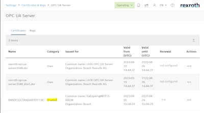

You will also need to trust the certificate on the server side using the ctrlX Web UI after you first attempt to make the connection from UAExpert.
