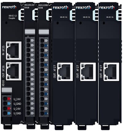

An alternative will be a ctrlX IO XB-EC-12 with an upcoming XB-EC-31 (t-plug) where similar to the Beckhoff device a tree can be build. And the good thing here, the scanning is working fine.
When using these configurations, each EC Slave must be in an own Sync Unit otherwise when one is missing or in failure all other data will get invalid too.
