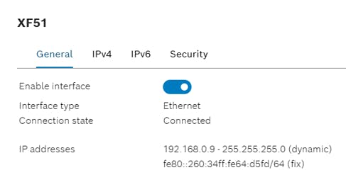

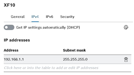

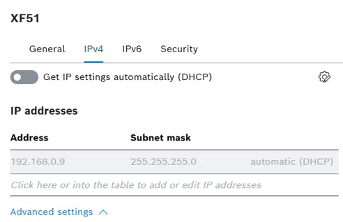

Configuration of XF10 and XF51:
The customer connects both networks to the switch in order to access both the CORE and Siemens networks through the same port.
