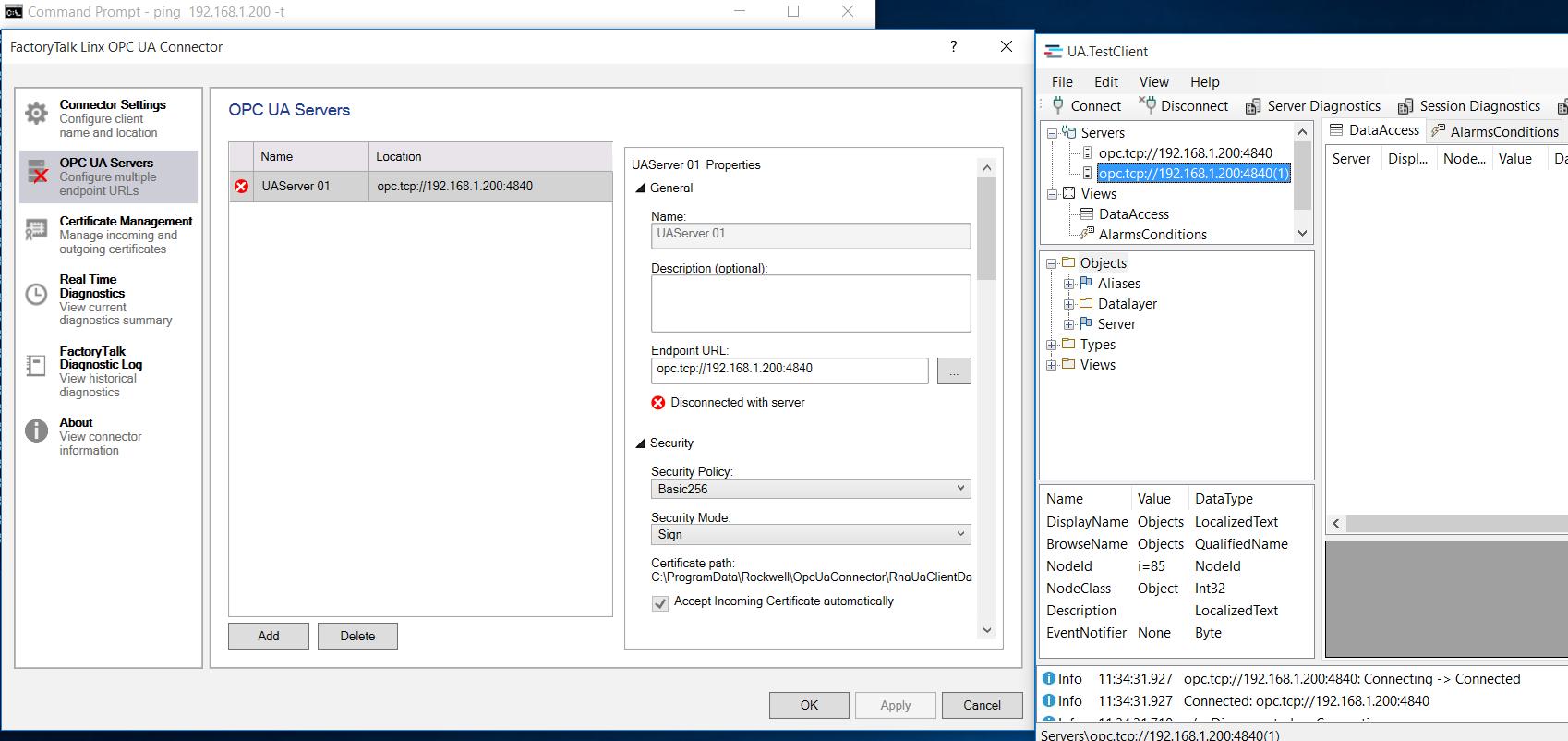

I have been trying to connect Factorytalk Linx OPC UA Client to Rexroth OPC UA Server.
However, i cannot seem to find the OPC UA Server, i have used OPC Test client and have verified that the OPC UA Server is operational.
Is there anyone who has been successful in connecting the Factorytalk OPC UA Client to Rexroth OPC UA Server?
Usually, .esd file is required, anyone knows where can i get it?

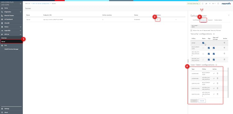

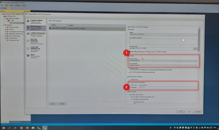

I just tested Factorytalk Linx OPC UA Client with my demo ctrlX unit is working.
ctrlX OPCUA Server configuration:
FactoryTalk Linx OPC UA Connector configuration:
