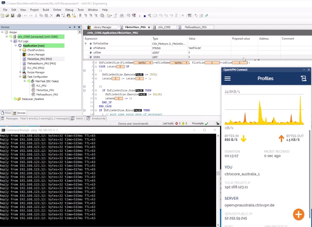

just tested it with version 1.12 via a vpn connection europe <-> australia and back.
Ping from my engineering pc to the control was arround 515ms.
Worked fine as you can see in the video screenshot, video was not possible to upload.
Is it maybe another issue, maybe the vpn connection is interrupted, did you check the logbook?
