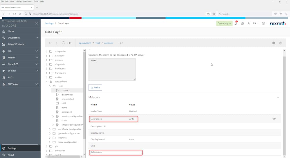

You can see for each method which data type needs to send to this node and how it is structured. For "Connect" and "Disconnect" it is just an empty write. See "Operations" = "write" and "References" = "":
Data Layer UI opcuaclient connect
Declaration:
PROGRAM OPCUa_Client
VAR
	fbDL_WriteNode : DL_WriteNode;
	bExecute: BOOL;
	bDone: BOOL;
	bActive: BOOL;
	bError: BOOL;
	ErrorID: CXA_Datalayer.ERROR_CODE;
	ErrorIdent: CXA_Datalayer.ERROR_STRUCT;
	strNodeName: STRING(255) := 'opcuaclient/Test/connect'; //'opcuaclient/Test/disconnect'
END_VAR
Implementation:
fbDL_WriteNode(
	Execute:= bExecute,
	Done=> bDone,
	Active=> bActive,
	Error=> bError,
	ErrorID=> ErrorID,
	ErrorIdent=> ErrorIdent,
	ClientId:= ,
	NodeName:= strNodeName,
	Value:= );

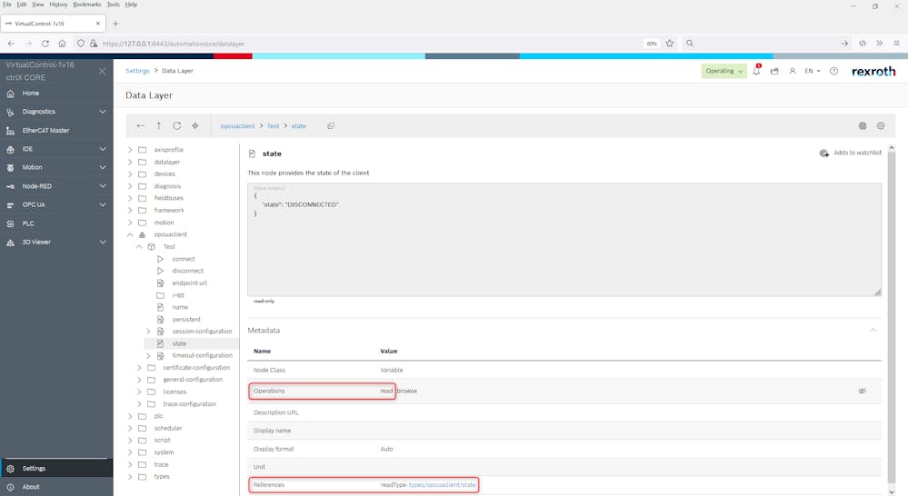

Reading the state means reading an object of the type "types/opcuaclient/state". This is done via a flatbuffer:
Data Layer UI opcuaclient state
Declaration:
VAR
	fbClientState: CXA_OpcUaClient_fbs.comm_opcua_client_State; //Flatbuffer function out of CXA_Automationcore_fbs
	fbDL_ReadNodeValue: DL_ReadNodeValue; //Funktion block to read an flatbuffer out of CXA_Datalayer
	bReadExecute: BOOL;
	bReadDone: BOOL;
	bReadActive: BOOL;
	bReadError: BOOL;
	ReadErrorID: CXA_Datalayer.ERROR_CODE;
	ReadErrorIdent: CXA_Datalayer.ERROR_STRUCT;
	DataRead: CXA_Datalayer.DL_NodeValue;
	strState: CXA_OpcUaClient_fbs.comm_opcua_client_ConnectionState;
END_VAR
Implementation:
fbDL_ReadNodeValue(
	Execute:= bReadExecute,
	Done=> bReadDone,
	Active=> bReadActive,
	Error=> bReadError,
	ErrorID=> ReadErrorID,
	ErrorIdent=> ReadErrorIdent,
	ClientId:= ,
	NodeName:= 'opcuaclient/Test/state',
	NodeValue:= DataRead);
IF fbDL_ReadNodeValue.Done THEN
	fbClientState.getRootAsState(data:= DataRead.GetData(), size:= DataRead.GetSize());
	strState := fbClientState.getState();
END_IF
See also other examples of reading and writing flatbuffer.
